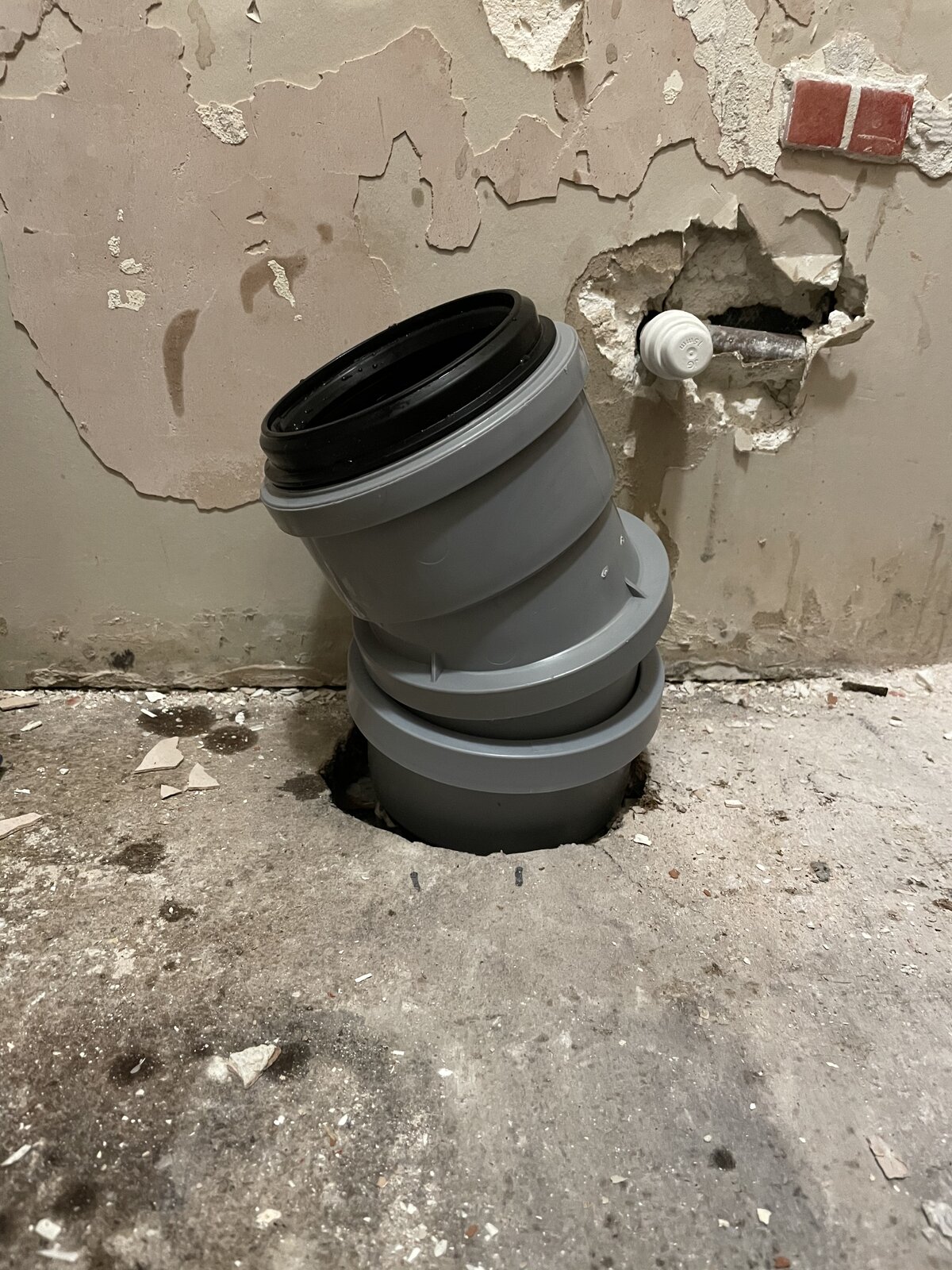

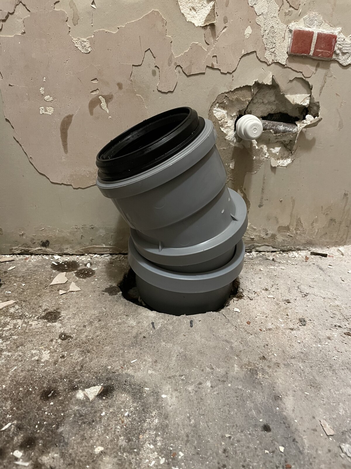

I’m still not convinced tho. I’m very tight for space.
just looked again and the pipe that comes out the floor is just a piece of Badly cut 110mm and I’m guessing the orange bit that it goes into is a socket and is just pushed in? Haven’t tried to pull
It out but it moves with a bit of force so i suppose if this comes out I’ll have a bit more to play with
I’ve just enlarged the photo myself, and what may be possible is: a drain connector and 2 45 degree elbows and your 90 degree elbow with a piece of pipe in between.
Be careful if trying to remove a stub of pipe from a socket, if you disturb the seal, they are the devil incarnate to get back into place, that's if it will go back into place.... :mad:
Didn’t consider that. Pipe being under the house would make that a problem then!
I can trim the black elbow on the frame. If I trim it down to the minimum it’s still only 90mm diameter so comes with an adaptor for 110mm.
i only then have 160mm in total left to play with

Right guys. Thank you very much for your help and input. It’s very much appreciated. I think the poly pipe adjustable elbow I bought should do the job. Just need to shorten the elbow that came with the frame and I think I’m good.
not a great picture but you get the idea

it’s actually quite hard to adjust so am hoping that means it is a tight seal. I guess with it being fairly vertical nothing should be hanging about like it might if it was a bit more horizontal.
It all feels pretty tight to be honest.
also found the soil pipe coming out the floor as well as being offset isn’t vertical either, it comes up towards you at an angle which I guess can’t be right so this compensates.

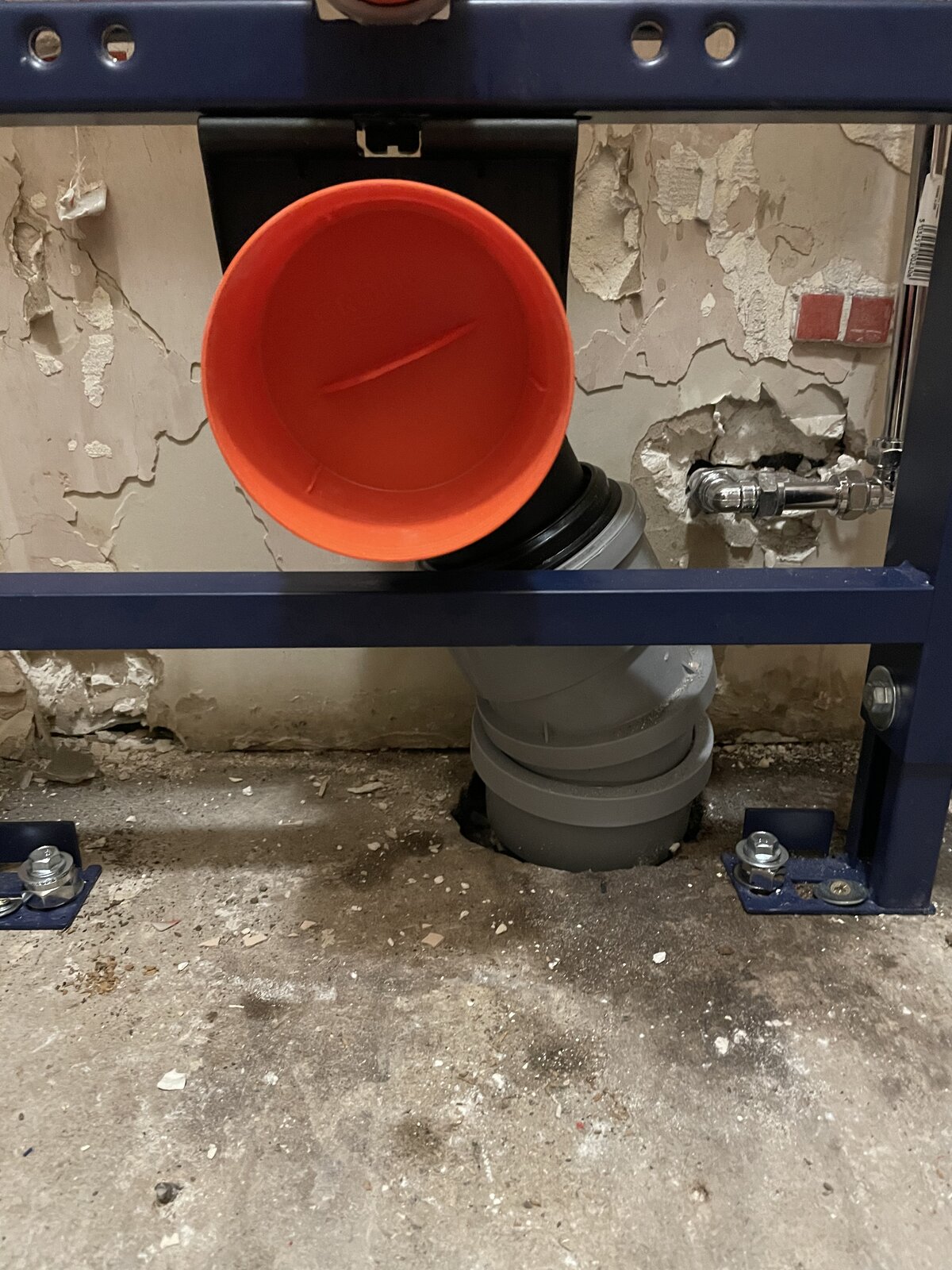

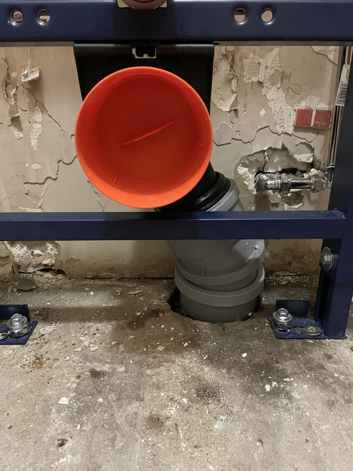

Well the frame is in, would have preferred less joints in the pipe. But it is what it is I think. It’s all very tight and can’t really go anywhere. No iffy smells and seals all seem really tight.
I know the angle that it comes out of the floor looks wrong like there is strain on the pipe but it isn’t! That’s the angle the pipe comes out of the floor......
thanks again everyone
