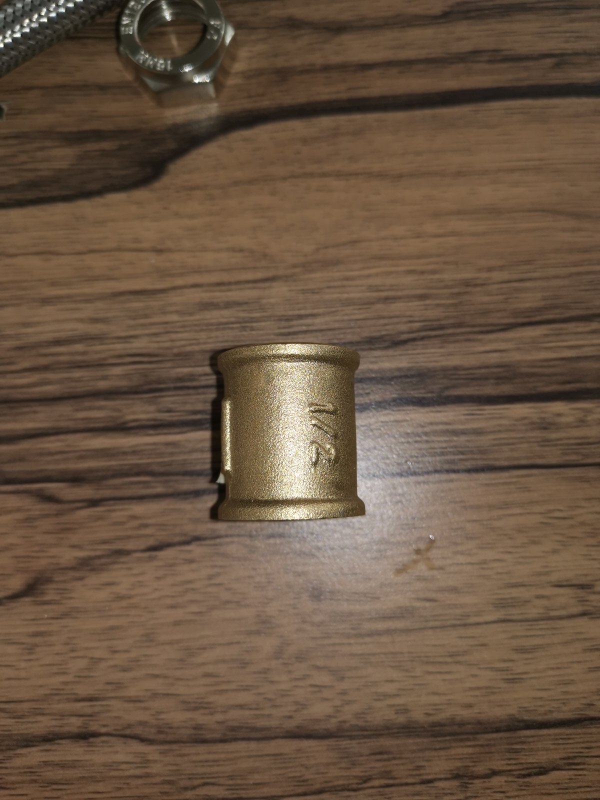

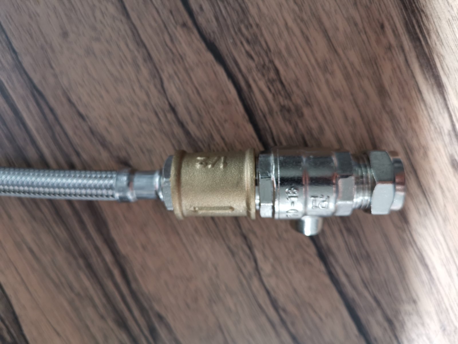

So is there a way to connect it to the isolation valve I've found these in the garage.

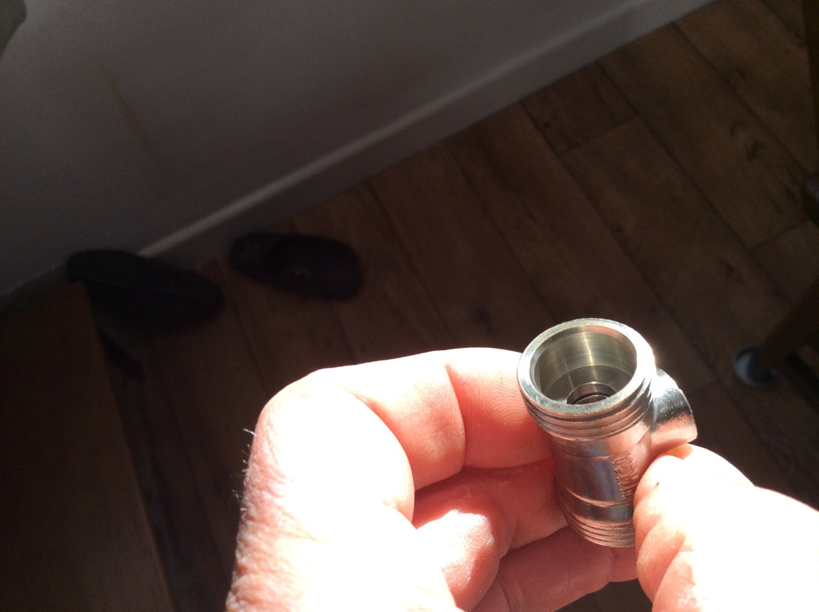

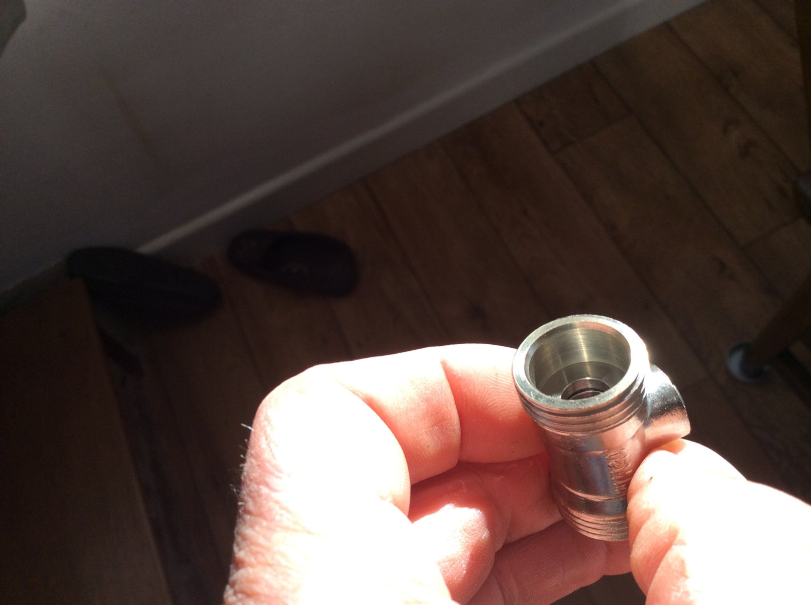

0469C850-B194-4160-9216-F1459CC70C2C.jpeg If you know someone with a lathe, one sharp end of the valve can be turned flat which is handy if room is at a premium. If you do modify, make sure its flattened on the outlet side if the valve is directional.
Of course it depends on the flexie end type as well
If it's a normal tap tail flexi pipe with a female end fitting to the ISO then use a flat file and file the end of the ISO valve so the edge doesn't bite the rubber washer, they're brass so they file flat easily.

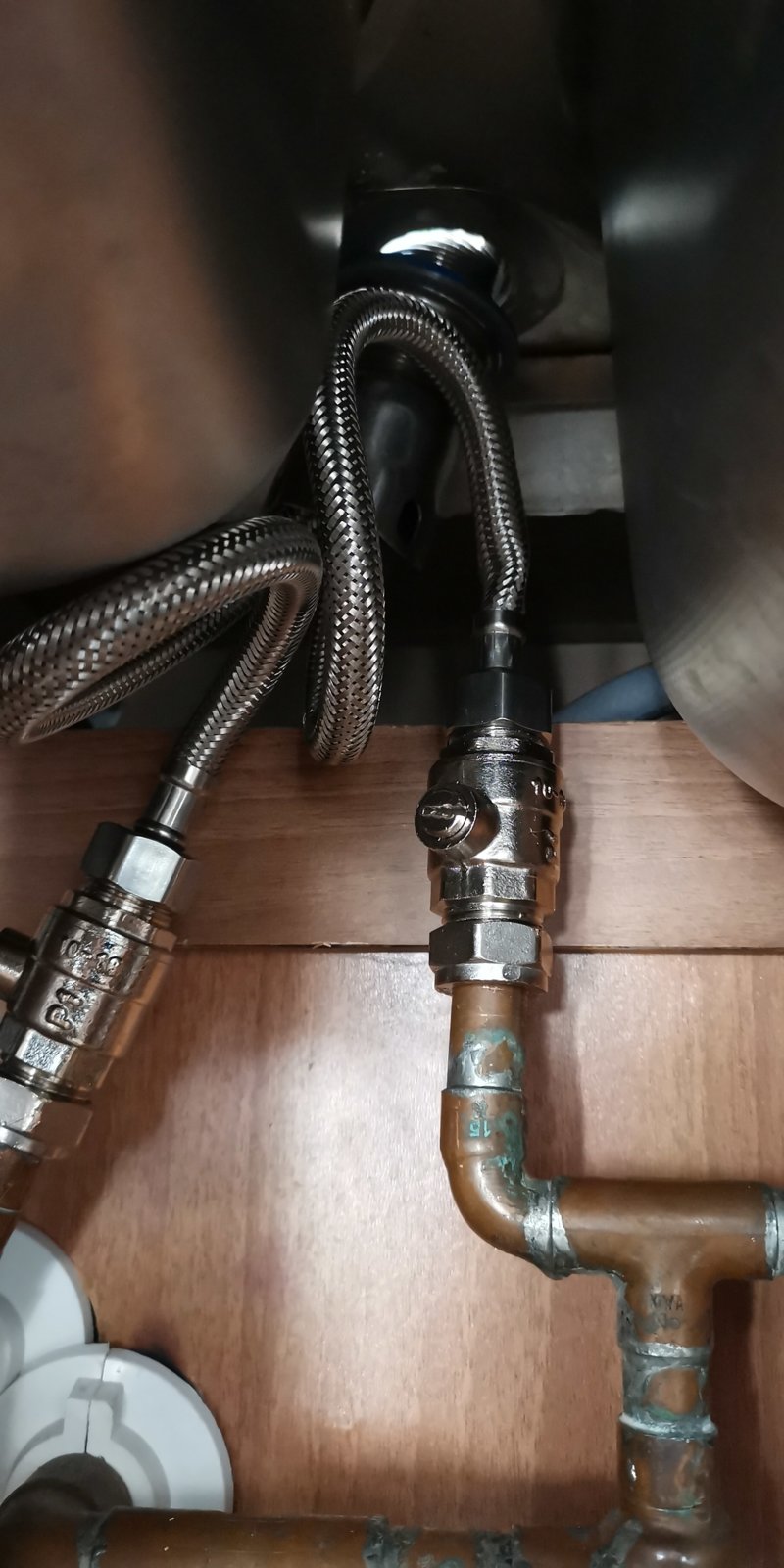

You can see the amount of room I've got to play with. I'm just using the old 400mm tap tails which don't look great.
If this doesn't work I'm not sure what to do as the cold feed is still too high
