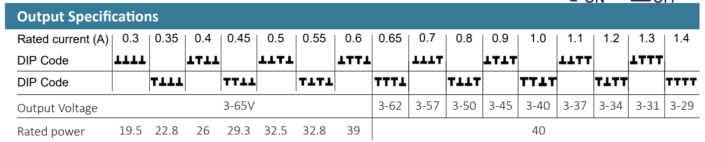

The lamps are 700maA/ 3v (This is only written on the unit, not the boxes or data sheet so I had to go and re-check).
I am not sure how to calculate the load to be honest, adding the mA values goes off the scale of the driver, but I don't know what voltage it is based at, presumably the full 72v?
My circuits are 6 lamps, 5 lamps & 4 lamps, and this is the driver spec.:

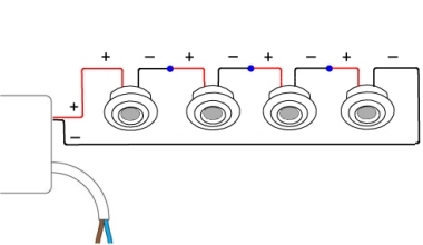

Just set the switches to 0.7A, wire all of the LEDs in series. The driver will do the rest.
It will work from a single LED upwards with no further adjustments required.
With one LED connected the output voltage will be about 3V. With more, the voltage will increase automatically.
They will be about 2 watts each (current x LED voltage), so even with 6 connected it's well within the 40W maximum of the driver.
This is the wiring arrangement required:
