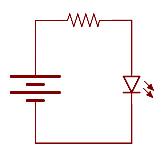

If only it was possible to have a simple guide to enable the DIY
A moderator said:
How about a list of the most common types of (say) 12 volt lamps/leds/bulbs, and another of the most common power supplies, and what they actually are (which is covered above, use a reference to type#..?), and which to use where?
A list of "the the most common" would run to several pages and be of no value to someone who bought a less common type.
The explanations of :-
(1) an LED element requires a controlled current from a driver.
(2) an LED lamp is an LED element and a driver suitable for that element ( element may be plural )
(3) an LED driver requires a suitable supply of power
(4) an LED driver cannot be supplied from another LED driver
(5) an LED lamp ( with integral driver ) cannot be supplied from another LED driver
are a guide as to whet cannot be used together to "put the lights on"
It all falls down when the label on an item is misleading about the function that the item performs.
(5) It can be supplied by a constant voltage driver.
(5) an LED lamp ( with integral driver ) cannot be supplied from another LED driver.
Which part here is the driver?
