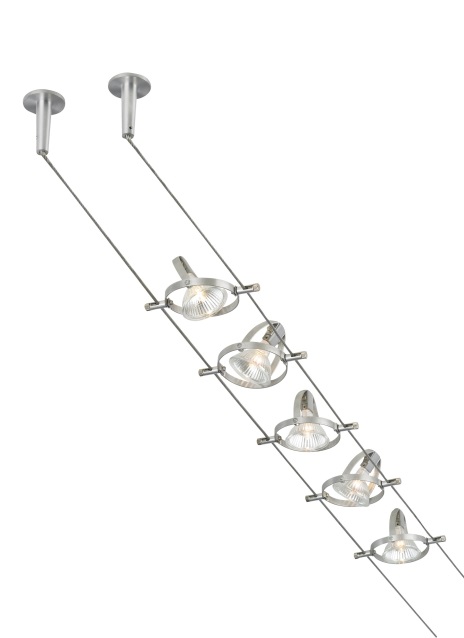

An electricician in coastal town was asked to sort out a set of 12 volt tension wire lamps that no longer worked. Finding no voltage at the output of the transformer he replaced that transformer with a new modern more compact transformer.
Lights worked, until there were complaints about interference to marine radio services. The source was tracked to the shop and the EMI from the new modern transformer was identified as the source.
Did the electrician know the difference between a transformer and a transformer or was he mislead by a sales man who said that modern was always better.
There hundreds of cases of EMI from transformers disrupting radio services.
