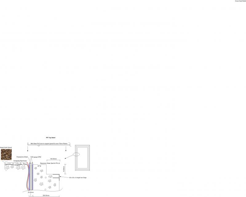

The first pic shows the rough location of the pit, the idea is to cast the base level with the drive, this will allow me to cover with a thin guage, sectional, steel lipped plate with gravel, effectivly making the pit disappear, this will also act as a waterproofing cover.
The pit will have 75mm thick timber planks bridging the hole when not in use.
The second drawing is me going over the top as usual, my rational is:
The geotextile will transfer any water from the clay walls down into a sump and vented pump, which will be installed outside of the main pit, and will hopefully reduce any hydrostatic pressure on the pit.
DPM each side of a polystyrene bat as first and second line water protection, the polystyrene will take up any expansion of the clay rather transfer it directly to the concrete walls.
Is the above over the top, what do others think.

Thanks Norcon, we have a really high water table where I live and am a bit worried that it might leak (not a massive problem as I can pump it out, but would rather prevent rather than cure).
Re the single pour, yet another daft question, if I shutter the sides with mesh sandwiched, the sides would be raised by 150mm to allow for the floor (maybe deeper with the cast in sump), what would stop the base from filling deeper when I pour in the sides (ie the concrete trying to find its own level, especially when I vibrate it)
Cheers mate
By "one pour" I meant the walls.
The floor first and you have a stable base to work from.

If you cost this up, would it not be less hassle to go to a mechanic or upgrade the motorhome than ripping up that nice drive?
All sorts of services could be down there. (electrical, sewers, drainage etc)
