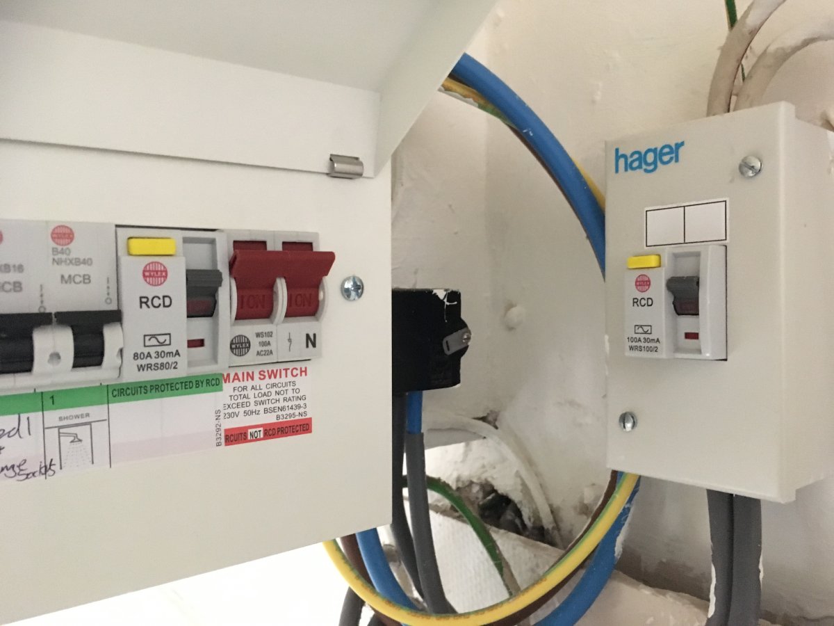

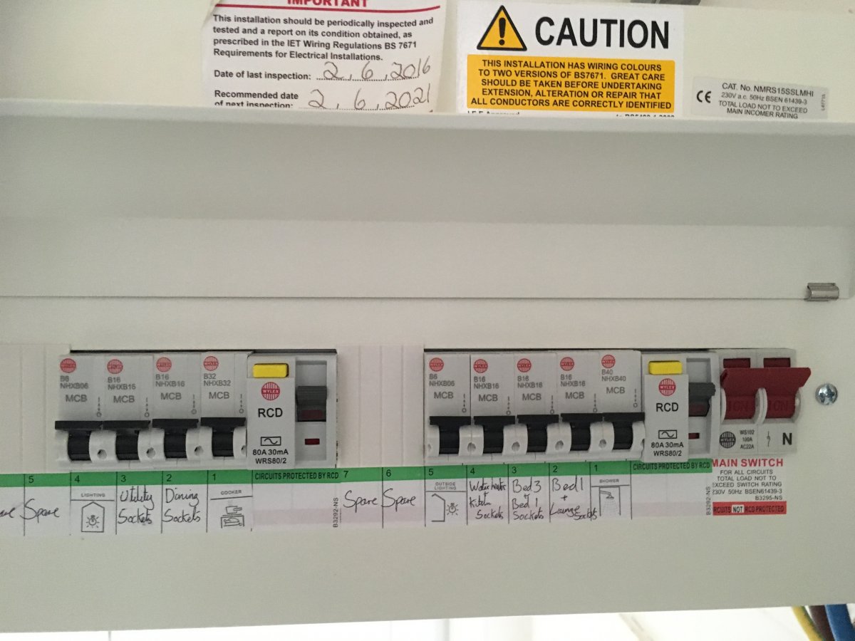

Recently moved in to new rental property, I need power in the conservatory for a freezer and dryer, also possibly a light. The sockets appear to be on 2.5mm radial circuits. I've not seen this before as I've only ever had ring mains and was hoping to spur off. Also why have a split board and the a rcd of same rating on the feed to consumer unit. This may be perfectly normal just hoping for some advise on how to proceed, thanks
Radial circuits are a perfectly valid method of providing power.
That is a brand new AMD 3 board, so my guess is that the old fuseboard did not have any RCD protection, and the 30mA RCD on the meter tails was there to provide the necessary protection. It really should be changed for just a 100amp switch, as there is no point having a split board with another RCD up front!
Possibly the fuse/isolator of the main feed to the property is either sealed, or not accessible so the electrician left it in situ. It's not a good thing as any earth fault on any circuit could potentially cut all of the power to the property.
As for how to proceed... well, as it is a rental property, surely the only way is for you ask the landlord to provide the additional electrical points and lights?

There is no mention of Bed 2 sockets, so either it got left off the circuit description or the guy put "Bed 1" where he meant "Bed 2", as "Bed 1" appears twice. It is perfectly possible that there are sockets in the same room on different breakers, though.
[nervous]Ummm......no..........no, there's nothing in Bed 2...nothing at all, nothing, do you hear??[/nervous]
Wylex RCD in a Hager enclosure will not conform to type testing.
why only one indoor lighting circuit in a house big enough to have a dining room and a utility room as well as 3 bedrooms, and socket radials on 16A not 20A? Water heater and kitchen sockets on a single 16A?
What idiot writes 'spare' in the ways that are empty? Really helpful for the next person who has to add a circuit.
