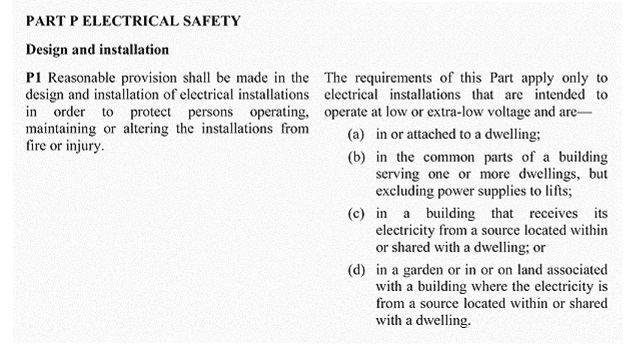

Part P of the Building Regulations states that there should be no outlets or accessories (cooker hoods excluded!) above any type of hob, nor within 300mm of the edge of the hob.
I am afraid Part P does not say that - although what it does say might result in the same outcome, so don't quote that one.
That's it. There is no more.
Didn’t realise that you had caught some sort of pedant virus from our friend! perhsps I should have specified the Approved Document and not the Statutory Instrument. But, hands up, I just copied that from somewhere else. It may not be at all true.

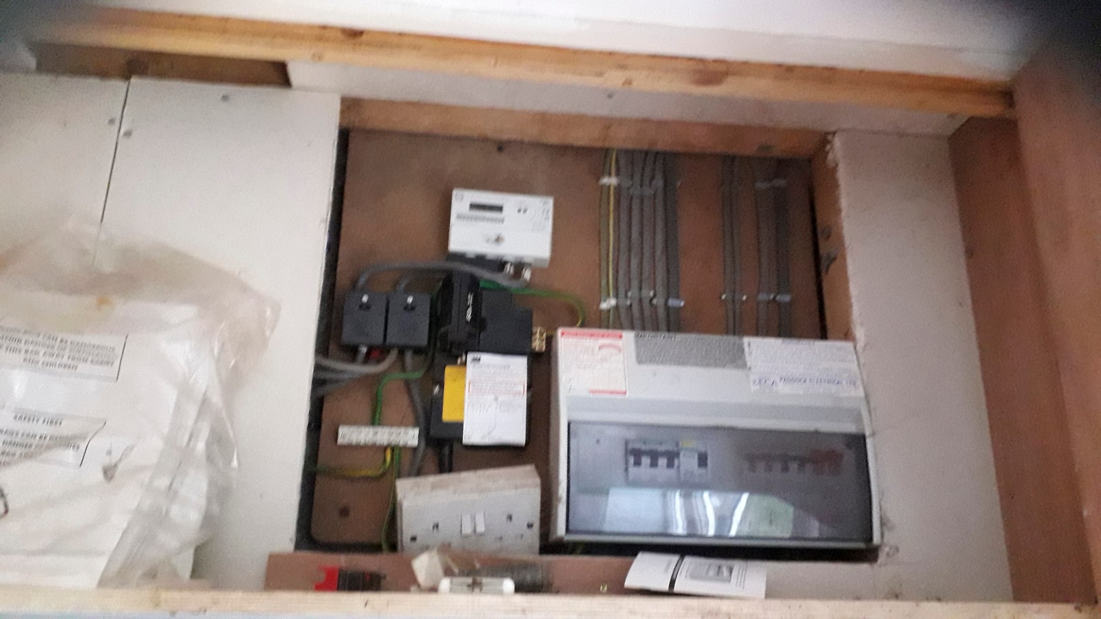

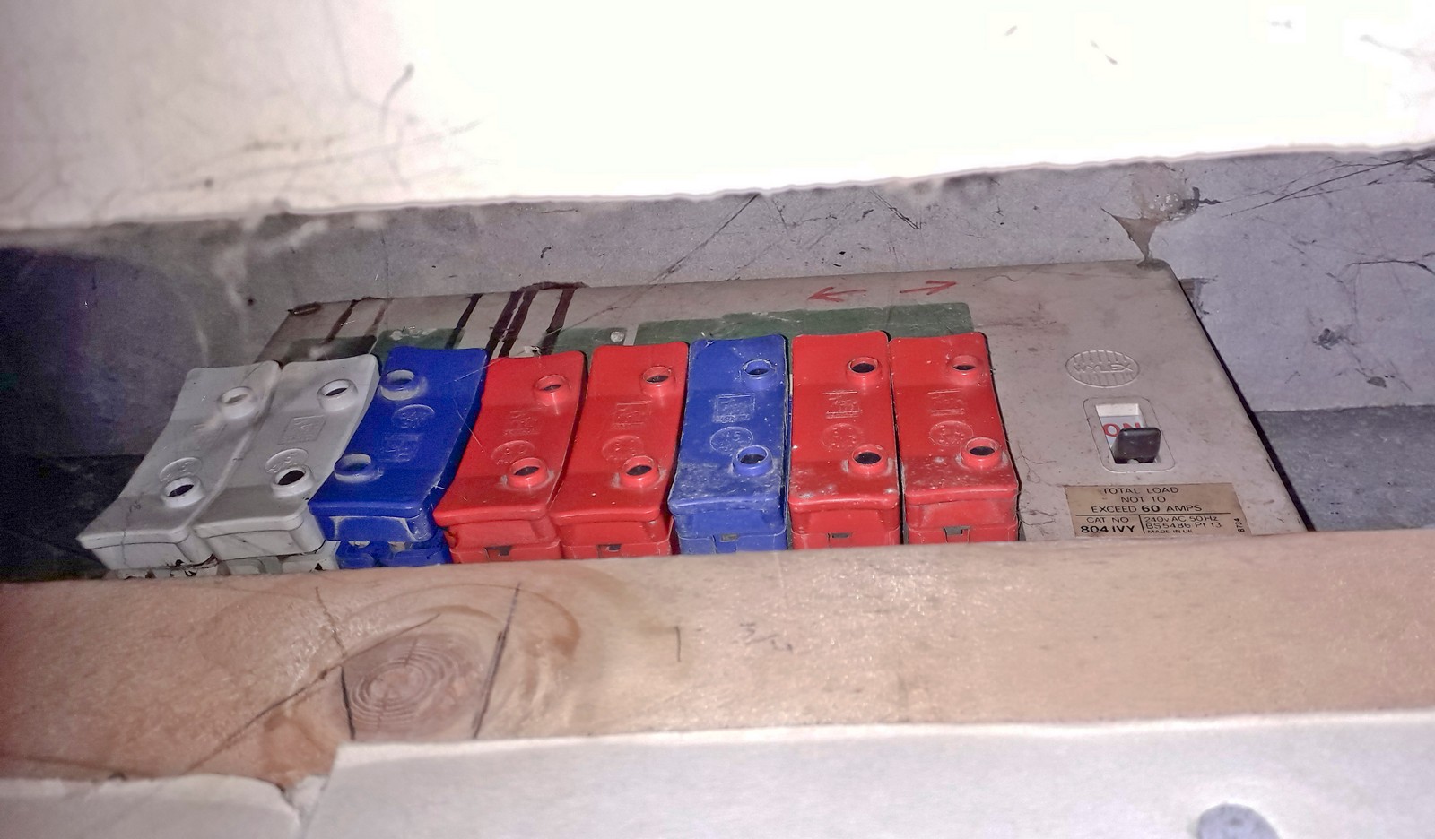

For my house I found this 20190529_081240.jpg seemed OK until you zoom in on the little hole top lefts and see this 20190529_081332.jpg but it was not the electrician at fault, when he fitted the fuse box it was a garage with no suspended ceiling, and daft as it was, the person who really made the error with the LABC inspector who should have said you can't do that and insisted it was altered before issuing the completion certificate.
Also the surveyor doing house buyers report saw the fuse box and wrote in the report there was a disused fuse box between old ceiling and suspended ceiling, but it was not disused.
People do daft tricks, at least there was an access hole. I had to have a lump of ceiling removed to move it, and to move it resulted in a load of cables needing extending, it was a big job as a result.
