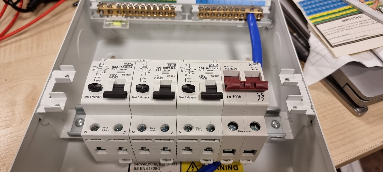

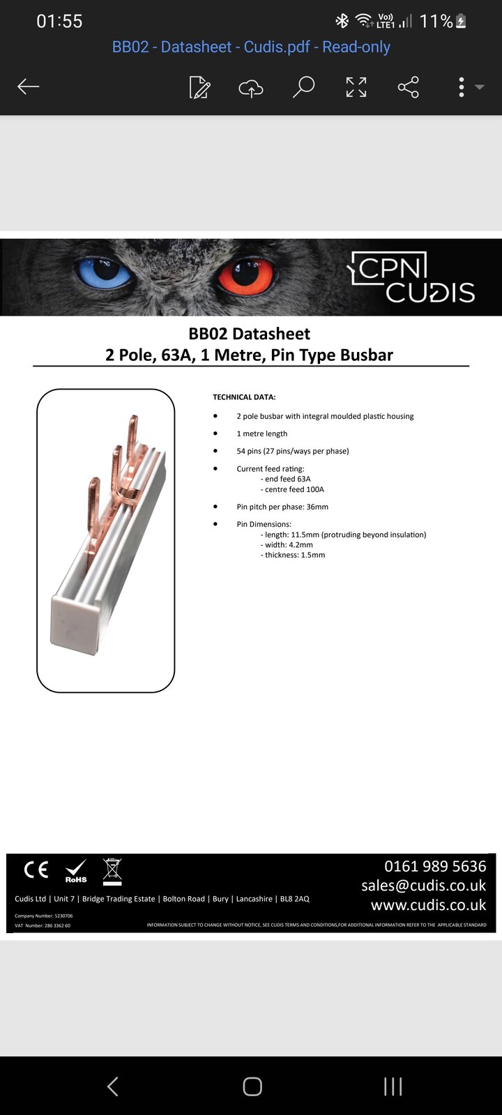

I have a Cudis Titan consumer unit that I want to install into my campervan. It came with a 100A isolation switch already installed. I have included a picture. Am I right in thinking the letter next to the 100 is L N for line and not IN for in. I have also included a picture of the DP busbar.
And if this is the Live side how would I wire the RCBOs up to this switch. I have been told to use a DP busbar but if this is the live side the Live and Neutral would be the wrong way round to marry up with the RCBOs
The RCBOs are Cudis DP type A, curve C. Thes are the large 2 way type without the earth and neutral fly leads.

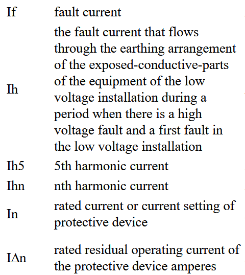

In = rated current or current setting of protective device.
It has nothing to do with neutral or in.

So can I wire the live and neutral the same orientation as the RCBOs, and connect them with the DP bus bar
Yes, there are a number of short forms used with electrics section from BS 7671 here
If is also not if they are just the international standards organisation list for short forms.

Many thanks for your reply, so changing them to a 6 and two 10A would be better.
So can the isolation switch be wired the same orientation as the RCBOs enabling me to use the DP bus bar.

No.
1. Eric has not seen that they are RCBOs
2. He has also gone off on a tangent that while technically correct has little relevance to you, because:
3. If they were not RCBOs, then the correct thing to so, would be to change them to RCBOs or the main switch to RCD, not slighly downrate overcurrent devices, so that instead of there being a 99.9% chance of not having effective fault protection, is only actually 99.8%
Yes, unless either pole has any markings we cant see to specify which way round to utilise the poles

Thanks for that Adam, I can not see anything to indicate which way around Live and neutral would go. Just has terminals numbered 1and 2, 3 and 4 which I'm guessing indicates the line in goes to the top of isolator. Which would suggest to me the busbar would go to the bottom connecting isolator and RCBOs, and load out of top of RCBOs.
