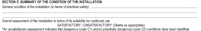

You can’t pass or fail an EICR, it is a report, nothing more.
Well, that's really a semantic issue. Whilst one can't "pass" or "fail" an EICR, in such language, the 'summary' of an EICR report indicates whether the installation is "satisfactory" ('suitable for continued use') or "unsatisfactory ('not suitable for continued use') - which I would say are as close to "pass" and "fail" as makes no difference!
