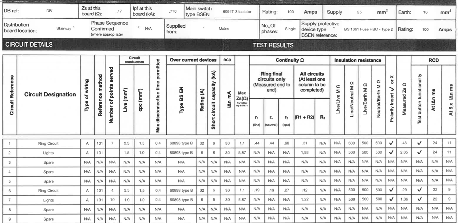

Today I've received a 'Electrical Installation Certificate'. It's issued 30/07/2015 by a local outfit who are NICEIC, and the stated works are 'Full Rewire'. Should there also be a certificate from the council / building control?
Not sure if this means anything to anybody here (means nothing to me!), but I've put the test page in below.

What it means to me is they haven’t done a proper test of their installation.
The numbers are too precise. The end to end for a ring final should have Rcpc and 1.5x that of r1 and rn. Which it does, exactly on both circuits. r1 and rn are both identical too. There’s nothing technically wrong with this but it’s incredibly unlikely - the end to end and Zs readings are affected by how tight every screw is in the circuit - not impossible to get them all nearly the same with a torque driver but there is still some tolerance and the accuracy of the meter will throw some variation in too.
And he’s also a muppet for installing a ring final for 4 Sockets (plus he missed points served for one lighting circuit)
Oh, and 4 circuits in a rewire? No cooker/smoke alarms/boiler/immersion heater/shower etc

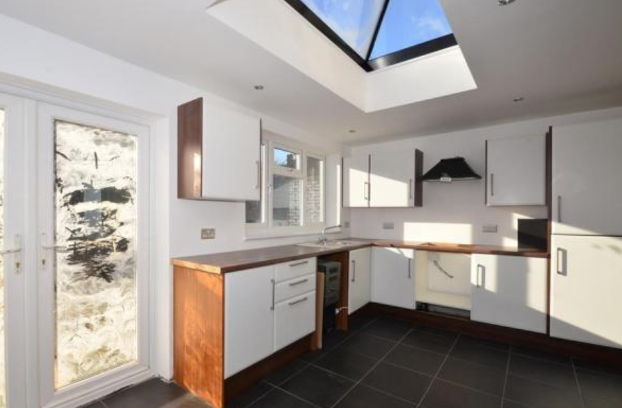

In the kitchen there is 4 double sockets above the counter. There is a double under the sink (well there is one there now, I'm assuming it's original given the fridge/dishwasher gap). Oven has to plug into something, as does that extractor.
As you say, very unlikely - but, I would say, also incorrect (and, worse, 'identically incorrect' for the two circuits) ...
... although you say that R2 (Rcpc) should be 1.5 times R1 or Rn (which IS what they have recorded), with 2.5/1.5mm² cable, unless I'm missing something it should surely be 1.67 times (if one uses the CSAs) or 1.61 times (if one uses relative resistivities per the 'Voltage Drop' tables in regs).
If I've got this right, it seems even more suspicious than you suggested!

You’re quite right of course. Should read 1.7 in my post. Long day :sleep:
No problem.
If your typing fingers had obeyed you and typed "1.7", you probably would have noticed that what they recorded was '1.5 times' - which might possibly suggest that not only didn't they measure R2, but that they calculated it using the same incorrect figure that you actually typed! For them to have actually measured R2 as only 1.5 times R1 (or Rn), for both circuits, would seem to be rather stretching likely co-incidences!
Kind Regards, John
Well I'm going to honest, I have no clue what you two are talking about! o_O
However, what I think I do get is basically the test results are essentially an impossibility, therefore faked?
Something worth taking up with NICEIC?
