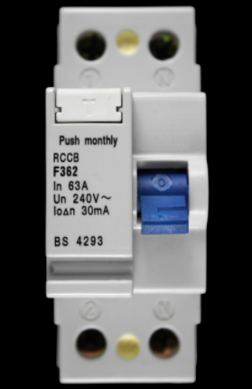

I just had an EICR done and the electrician recommended swapping the CU unit out as it tripped as soon as he plugged his meter in. It's probably 30 odd years old, BS 5486, so makes sense.

No he indicated that this was due to a problem with the board when testing the RCD. His comment on the report was "Rcd bs number obsolete unable to test"

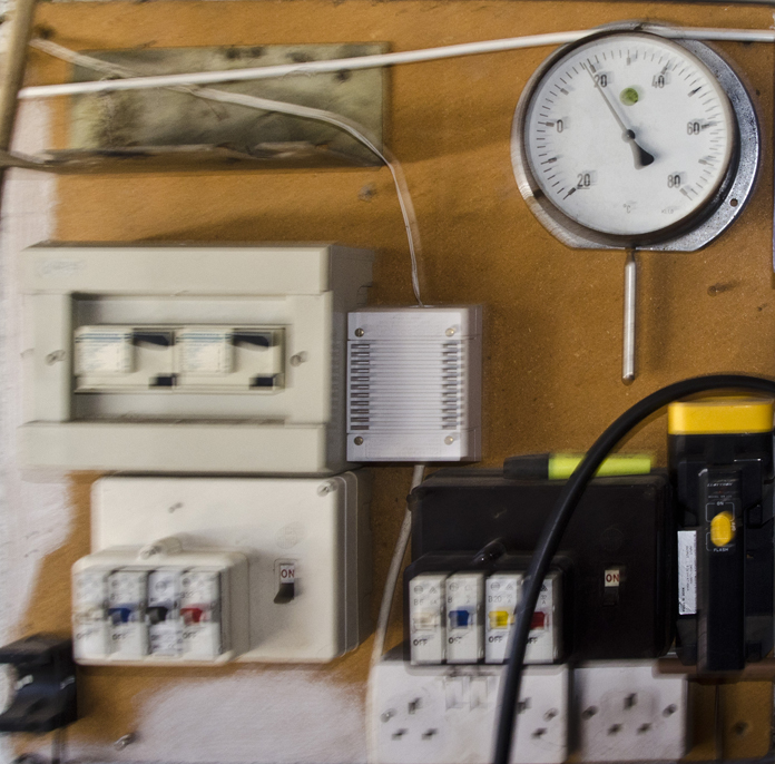

As to tripping I had 2 RCD's in old house, and one from day one never been able to do a loop impedance test, the meter always tripped, in theory you should be leaking no more than 9 mA, which since the RCD should trip between 15 and 30 mA gives one 6 mA at least to play with, but I don't have a clamp on meter to measure that 9 mA so no idea what the back ground leakage is, however the RCD tester showed OK at ½ (15 mA) and tripped at full (30 mA) so one would assume it did not have anywhere near the 9 mA allowed. And seem to remember the loop impedance meter was rated as drawing 6 mA for the test.
So in theory it should not have tripped the RCD, but turn on one RCD and then all MCB's then turn other RCD on without turning MCB's off and it would often cause the first RCD to trip again, so always all MCB's off and turn them on one at a time.
Set up shown here Wilex-board-with-RCD.jpg two RCD's feeding two Wylex boxes, so yes the meter shouldn't cause them to trip, but it did, back in around 1992 when they were fitted there was no electronics in the RCD and they were 4 modules wide each, and there was no Type A.png or any other sign to say what type, however it is still serviceable, my son does intend to change it, but really no need.

BS5486 is certainly obsolete as it was withdrawn in 1994, and it's certainly possible an RCD from that era is obsolete as well, however that would not prevent someone from testing it.
Assuming it is actually an RCD and not a VOELCB.

The board is listed as an F1 Further investigation required, "Rcd bs number obsolete unable to test", but I assume that needs to be done to get the report marked satisfactory?
The RCD is an RCCB. I probably need him to clarify exactly what went wrong when testing it.
Yes 4293 is not the current standard for RCDs, but you can still test them.

Visually, it's an older ABB design, and F362 is an ABB number.
Wylex used the same case design, but not the same number.
