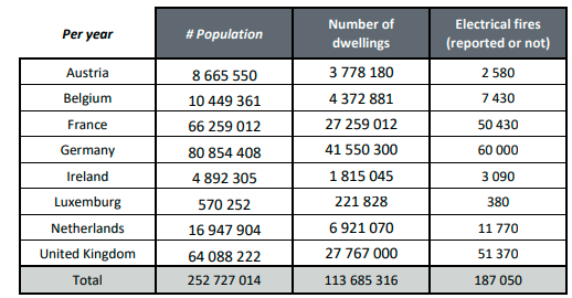

What, I wonder, have all these other countries actually achieved by being "decades ahead" of us? Do they actually (as a result) have significant lower numbers of injuries/deaths due to electric shocks and/or significantly less 'electrical fires' than we do in the UK?
I haven't yet found figures for domestic electrical injuries, but I have found the following for work-related ones. These figures seem 'interesting', given that Germany is the country most often 'praised' for having been early in banning Type AC RCDs.
As for domestic electrical fires, they do seem a bit more common in UK (1,850 per million dwellings per year) than in Germany (1,444 per million dwellings per year), but not dramatically so. Goodness knows how accurate is the amazingly 'round' figure for Germany (60,000). I'm also not sure what a "not reported" electrical fire is :)
