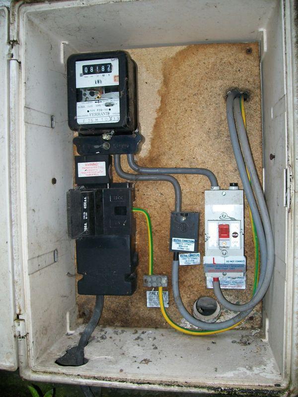

Out of interest, is it OK to have the isolator fitted next to the meter if it's outside? I ask as my meter is in a box on the outside wall. I'm not sure I like the idea of a master switch for the entire house's electrics mounted in a box that anyone with a meter box key/long nosed pliers can access!
Apart from the inconvenience issue and people playing pranks (hmm, thinks back, yes I was young once :D), I do have to wonder about the wisdom of putting inadequately rated electrical equipment outside. This is hte box on one of my properties - notice that it's never been exposed to wet :rolleyes:
At the risk of thread hijack, if one were getting out someone to put an isolator in, do you reckon there's much chance of persuading them to move the meter a bit while they're at it (tea and quality biccie selection provided of course) ?
At G/Fs house, the meter isn't ver conveniently located in terms of the space left the the CU - in fact the current CU has had to be mounted sideways on to fit it in.
Though really, it needs the CU taking out, the meter moving to bottle left, and new CU across top - IMO anyway, though not really practical to do that. In reality, meter would have to go hard up against bottom of current CU - unless others have a different opinion.

I wouldn't ask them. The cupboard and the back board is meant to be reserved for the supply company's equipment ONLY.
If they get @rsey they could tell you to move the CU out of there.
PS Has Squirrel Nutkin been storing stuff down the bottom of the cupboard?
Well there's never been a fuseboard anywhere else, and I'm sure Norweb were quite happy to connect up the supply originally. There's no evidence that the cupboard isn't original to when it was built.
