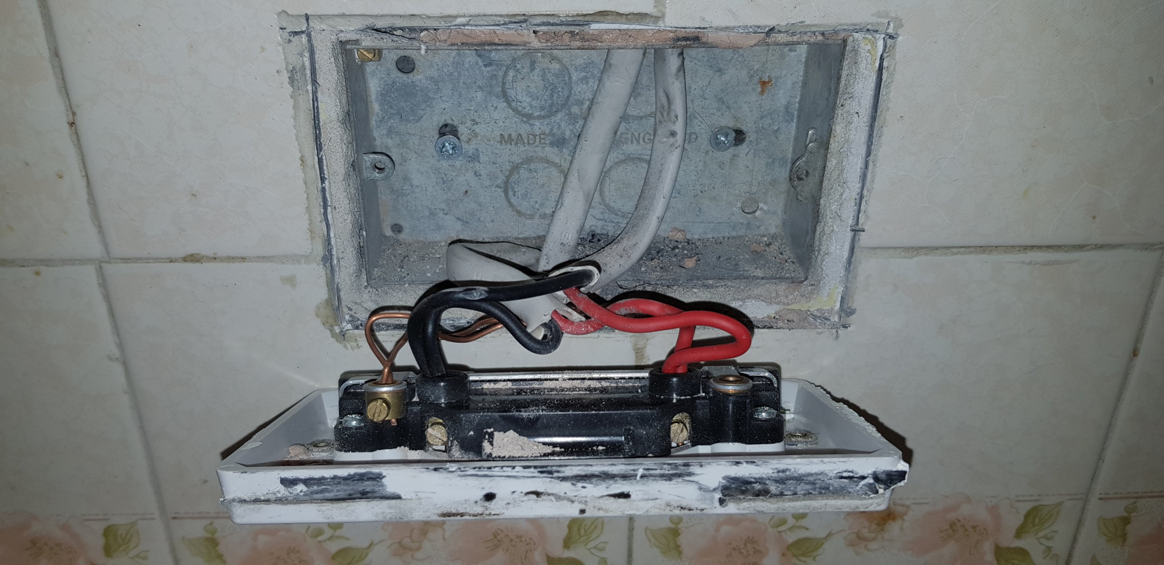

Here is what I found the other day when checking the wiring in my kitchen behind the cupboards.

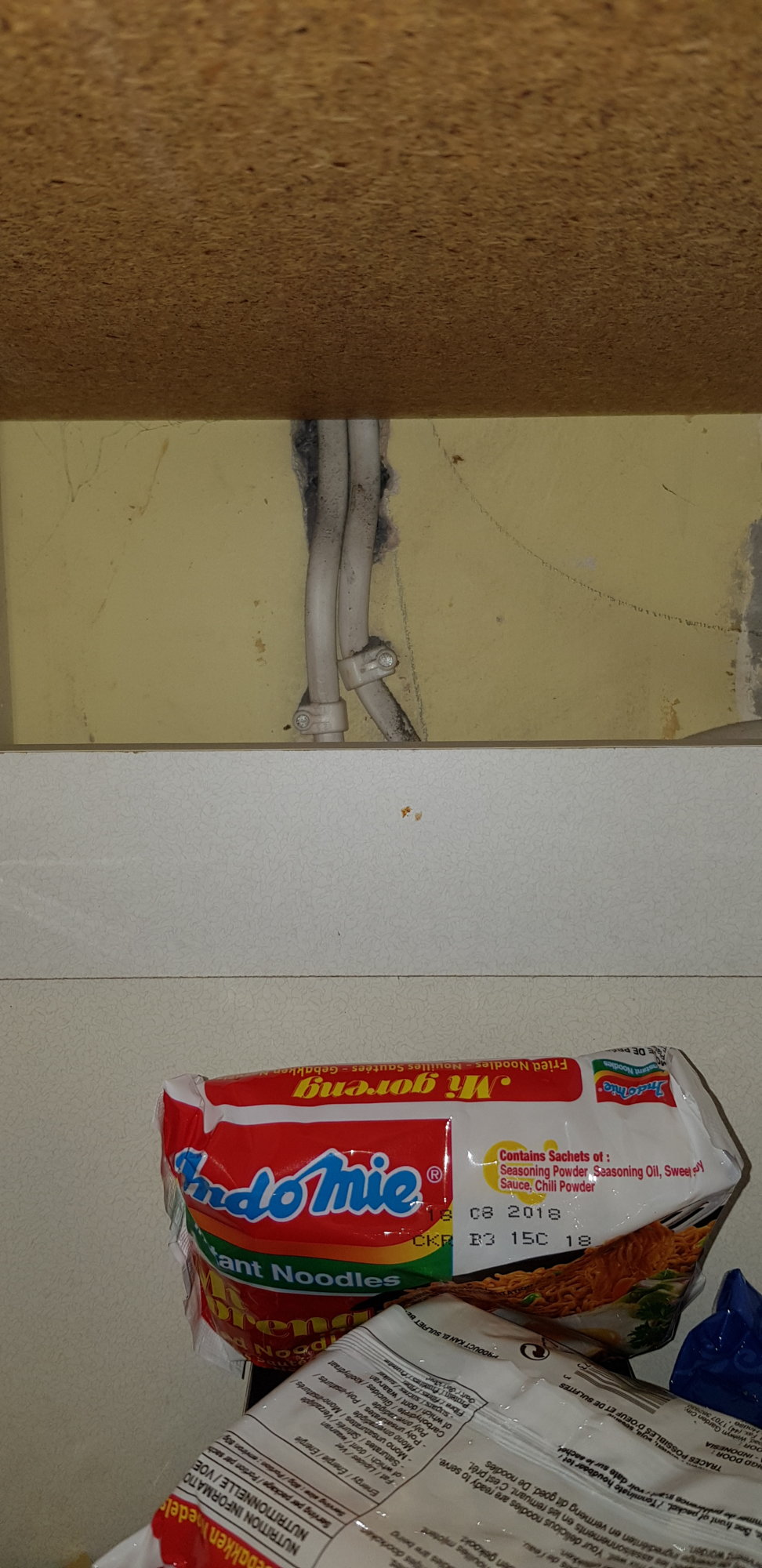

This following one worries me as it shows they just buried the cables below the tiling in the kitchen. I know its probably obvious its there as vertical wiring but even so I am not sure that is allowed ?
The following one shows the cable going up at the back of the sock just below the tiles.

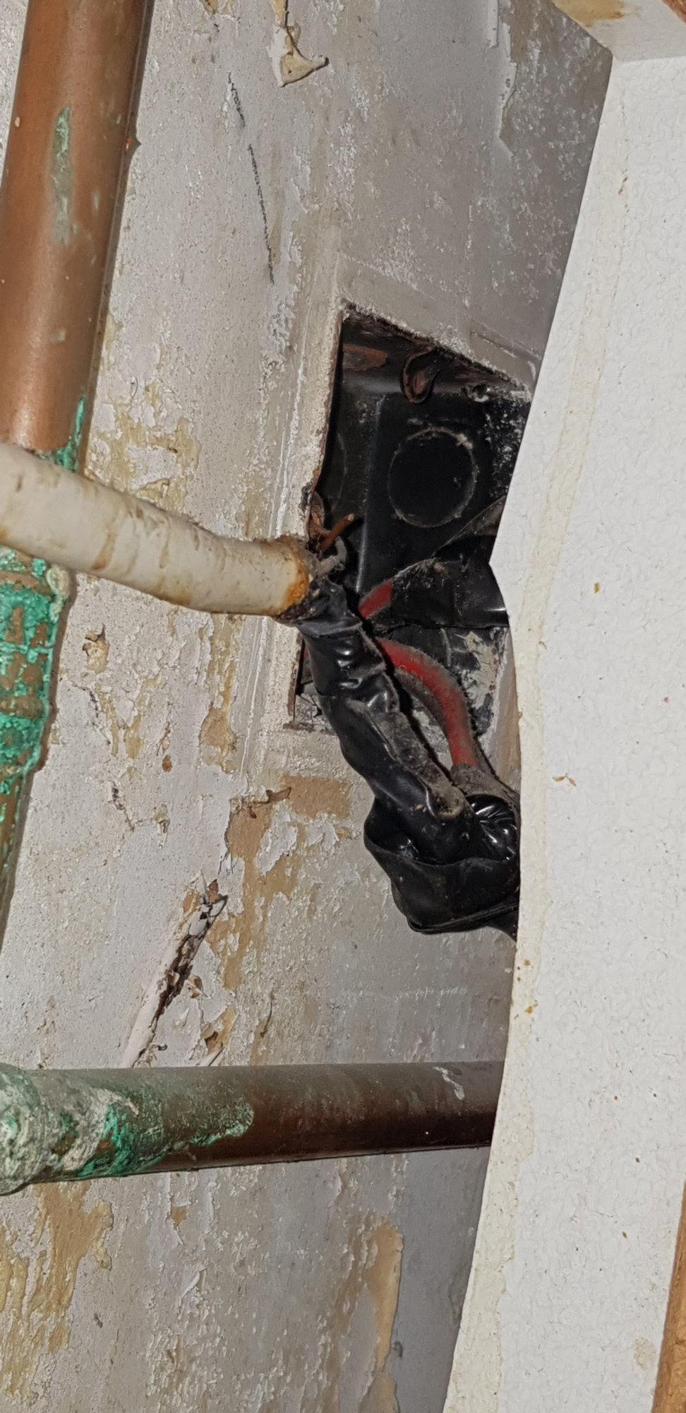

This last one has me very curious as when I looked at it with an endoscope tube thingy I could see 2 red wires and one blue wire going down one conduit which strikes me as weird for ring mains wiring ?

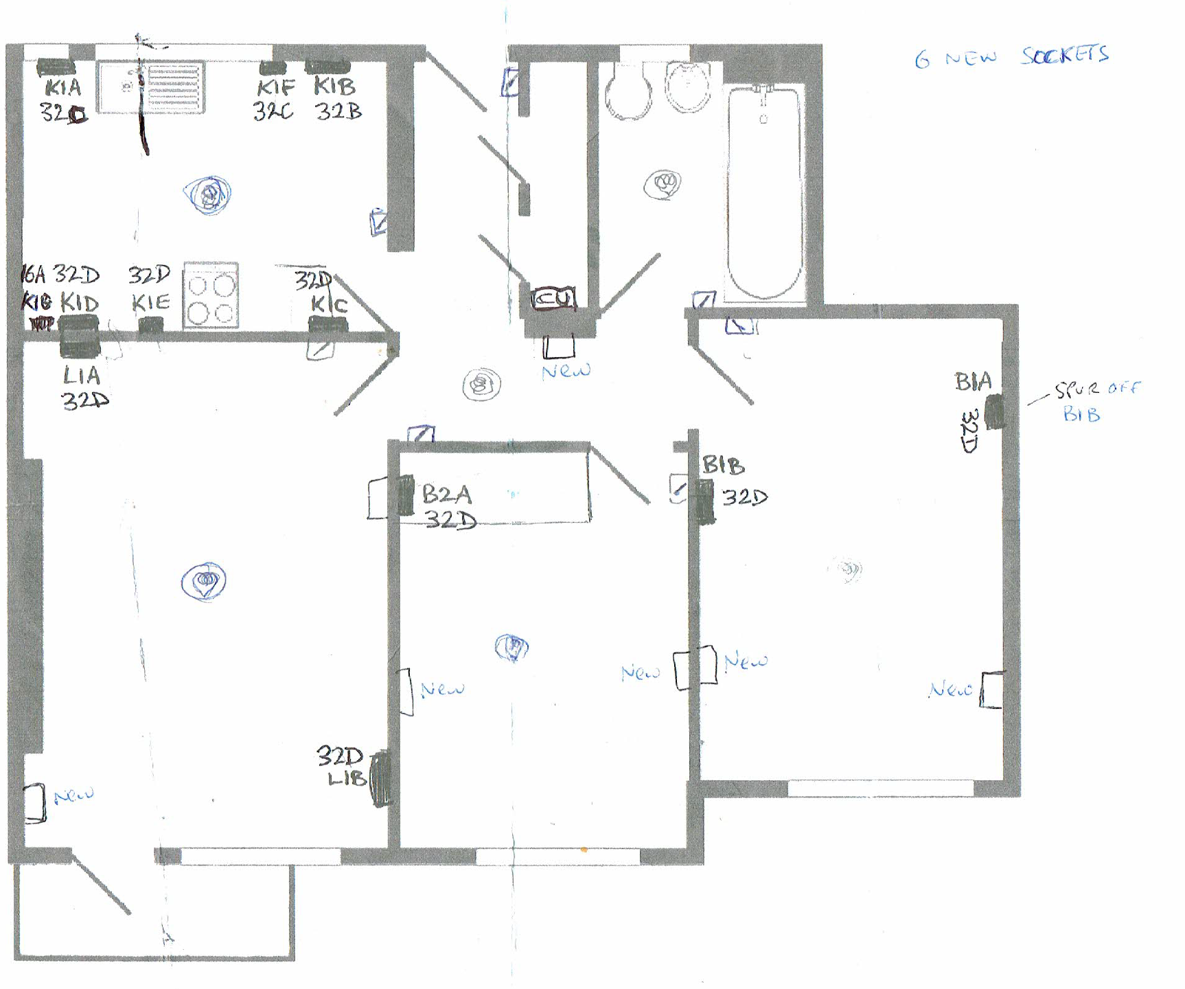

I bought a socket tester and used it to trace out which socket is connected to which circuit and got the following.
Have you ever seen a kitchen wired like that before ?

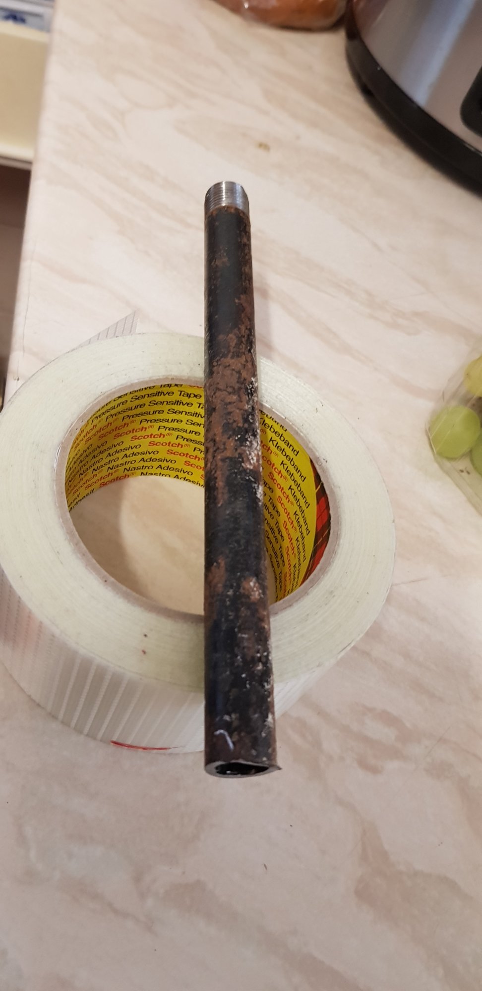

The conduit are of two sizes I measured using a bit of paper around the outside to measure the circumference and then divided by PI to get the diameter
54mm circ = 17.2mm diameter and 63mm circ = 20.05mm diameter. I am guessing the 17.2mm diameter is 5/8" conduit ?
I can't source anything for this smaller conduit which is what most of the top conduits are.

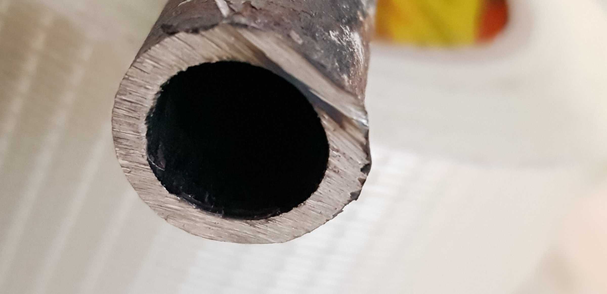

Look at the edges on that cut off piece of conduit.

I'm not a fan of knock on fittings especially when you are relying on them for earth continuity. As a compromise you could maybe use conlok fittings, but the proper way to repair this would be to replace the butchered conduit with new pieces of threaded steelwork.
Looking to the age of the installation, I'd imagine that the conduit will be imperial. From your measurements it would suggest you have 3/8" and 1/2" conduits, but from your original pictures, I think they appear to be more like 1/2" and 3/4" which would be much more common to come across.
Just polish up the conduit and use some BS951 connectors. But get continuity checked too to ensure earth reaches the extremities of the conduit system.
