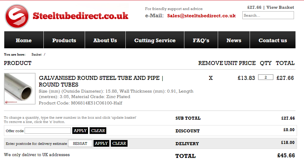

I am stuck trying to find this conduit or any adaptors for it as I can't find any reference to it.
Anyone seen this before ?
Typical I just found a supplier after posting and I been looking for ages before hand.
The problem I got is that 5/8" is a funny size as there don't seem to be any adaptors for it to convert to larger tube sizes.
So I can either buy this conduit in the link above and thread it and replace the existing cut off conduit so that the new conduit comes into the CU but then I would need to use the membrane cable entry kit I bought which would then mean it would be insulated from the CU so I would still need to have earthing clamps on the conduit.
It just so happens that the external diameter of 5/8" conduit is the same as the internal diameter of 1/2" conduit and pretty near 20mm conduit as well.
So maybe another option is to see if either 1/2" or 20mm conduit can be knocked on the end of the 5/8" conduit and be a good tight fit but I don't get a good enough feeling about this way as I would prefer a threaded connection.
Anyone converted 5/8" conduit to a more standard size before or know of any adaptors I can use ?
And screw it into the existing conduit which has a threaded socket end (sorry I don't know the proper terminology)
The 1/2" conduit sizes got me as the outside diameters are larger than 1/2"
Size EMT Rigid
1/2" 0.706" 0.84"
I worked out the thread is BSF 5/8"
Yes and I have tried looking for 16mm bits and pieces to no avail, everything is 20mm or 25mm.
