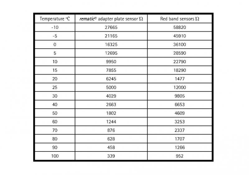

If it's of any use, here is a table showing the temperature/resistance values for a red-band sensor (right hand column). There is an obvious typing error as 20degC should obviously be 14770, not 1477.

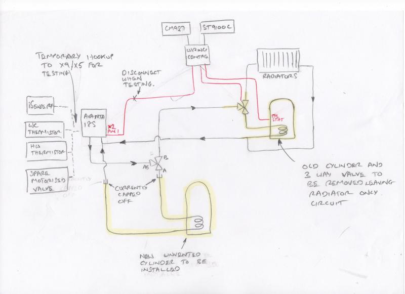

I've only been testing out the iSense for an hour or two at a time and then switching back to my CM927. At the moment the boiler is controlled by a simple 230V coming from the wiring centre and this switches the boiler on via terminal 1 of X2, ie. CH mode. This is a simple temporary solution for a few weeks until a new unvented cylinder gets fitted next to the boiler. At the the moment the flow control is via the original three way valve that is located up with the soon to be removed hot water cylinder. The new diverter valve is plumbed in on the boiler outlet, but just sitting in it's denergised position flowing AB to B. The new pipes to and from the soon to be installed cylinder are capped off. None of that though is really relevant.
For testing I have removed the live into X2 and setup the system for the iSense. That is
terminals 1 and 3 linked to 4 on X2
the iSense across terminals 7 and 8 of X9
the WC sensor located outside and connected across terminals 1 and 2 of X9 and
a red band sensor for HW connected across terminals 3 and 4 of X9
a spare motorised valve connected across terminals 1 and 2 of X5.
With the above, the system works as it should. I can see it coming on in either CH of HW mode (3 or 4). The motorised valve works OK. CH controls to a room temperature OK. I can get outside and HW temperatures reported on the boiler and iSense. Weather compensation appears to work OK, but it's not been on long enough to really test out.

Thanks for the resistance table. I've checked the resistance of the HW sensor at room temperature and it matches the figure in your table. I'm reasonably confident that a red band outside sensor is the same as a red band HW sensor (just different packaging).
The new diverter valve is plumbed in on the boiler outlet, but just sitting in it's de-energised position flowing AB to B. The new pipes to and from the soon to be installed cylinder are capped off.
Is the new diverter is the correct way round - B to heating , A to cylinder?

Are you talking about the original 3-port valve?
I haven't yet though got the HW control working OK. My first test was with a simple on/off switch across terminals 3 and 4 of X9 to simulate a cylinder stat. The problem I had was that whatever time was set on the iSense it would still fire up the HW when called for.
Last night I set up the system with a thermistor across terminals 3 and 4 and it wouldn't control to a temperature. I was using a hairdryer to heat it up the sensor and whilst it reported a seemingly correct temperature the boiler didn't cut off at the set 60 degC.
Is this with the original 3-port or the new diverter valve?
That's what I think. The table only mentions red band, no distinction for outside or cylinder.
On the basis that a picture tells a thousand words then hopefully the attached diagram makes sense of my earlier post.
That helps - raise more questions. :eek:
But I'll wait for you to tell us what caused the problem. ;)
