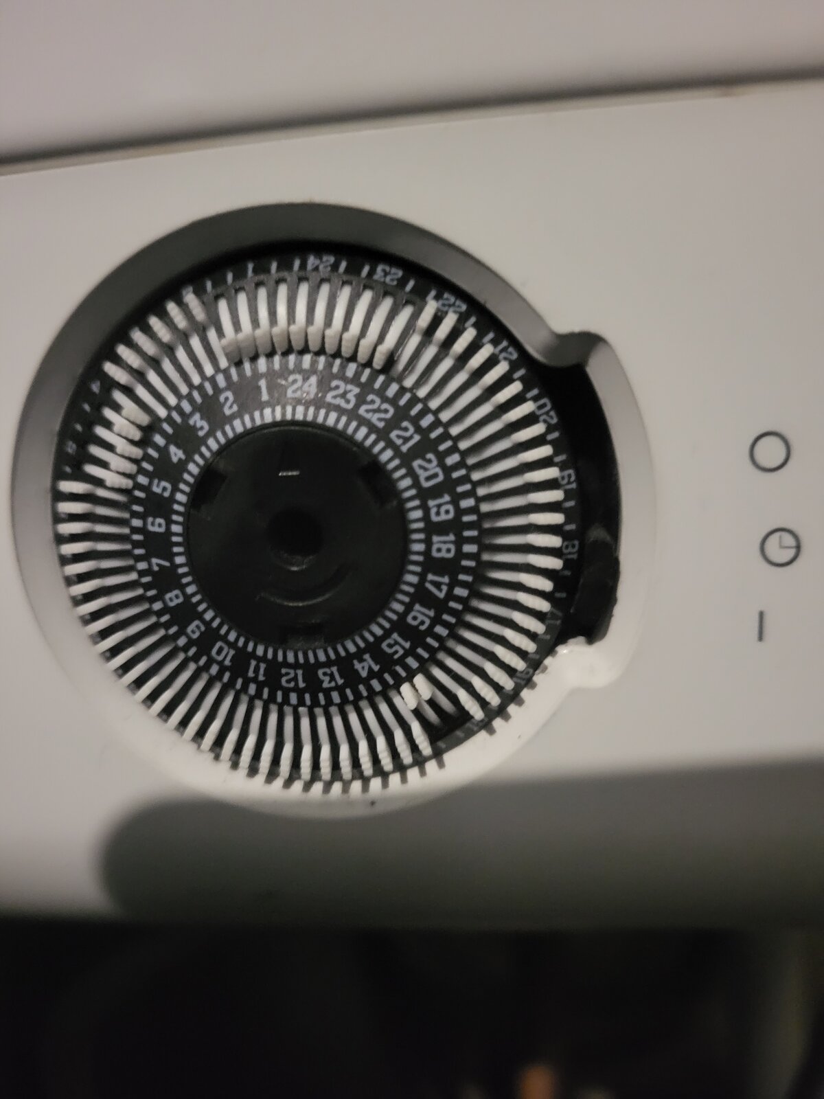

Also, if it is a programmable thermostat, the boiler timeswitch should be set to be permanently 'on' 24/7 and looking at the tappets that doesn't seem to be the case with yours.
I think just to the right of the ring of tappets there is a switch which is in the down position, which I think means permanently on. The position is not very clear in the photo, but I think it is down.
Really the timeswitch on the boiler should be permanently on?
I just want to stop the rads firing up every couple of hours while I'm away for a week and turning the sat down to 5c does turns the rads off it doesn't stop them firing up every couple of hours or so.
The black dial timewsitch on the boiler needs to be permanently on so that it doesn't interfere with the thermostat. It looks like it already is to me, in which case it's best just to leave it alone.

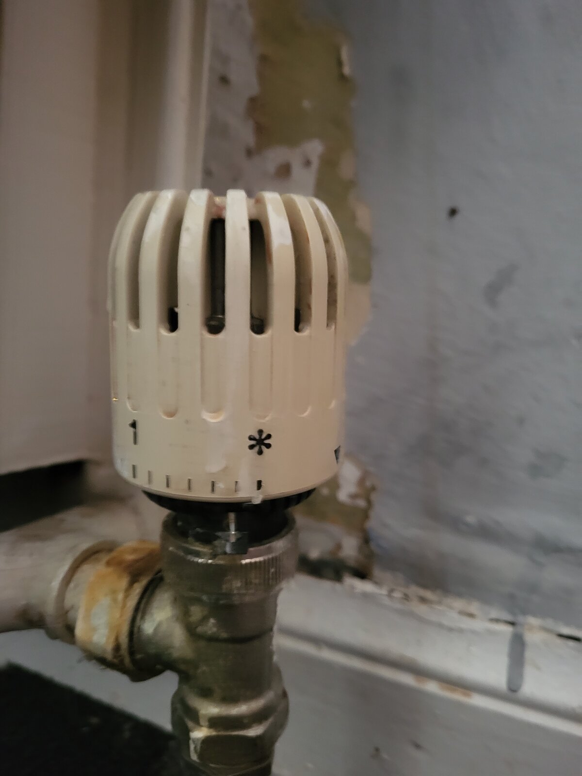

What if while away next week, I turn sat to 5c, then turn all rads down manually to frost bite protection? Or leave the sat as it is ie coming on when temperature drops below 21c at set times and just turn all the rads down manually to frost bite protection ie the photo?

Yes the timeswitch should be permanently 'on' which doesn't mean the heating will be permanently 'on' this is because your room thermostat can provide both time and temperature control in the one device, and you use that to control what room temperature you require and at what times. If it were a new installation with a programmable thermostat, a boiler without a timeswitch would be installed.
Having two devices trying to do the same thing simultaneously will never work properly, one will interfere with the other.
It's not a clear photo, but with some timeswitches, the switch moves to the 'on' and 'off' positions as the timeswitch physically turns the heating on and off. Set all of the tappets to 'on' to be sure and use the room thermostat to give you the control it is designed for.
Leave the TRV's on max while you are away. They are only to control the maximum temperature so no benefit of turning them down.
No you cant rely on thermostatic radiator valves, set it up as I already said and the boiler will only come on when the temp reaches 5 degrees, your Vokera Room thermostat MUST be set to OFF
Here's a clearer pic of the timeswitch on boiler.
I know you advised an alternative option but I know when I turn the TVR on the radiator down to the lowest setting or to frost protection that particular rad only heats to whatever is the lowest temperature I've set it too, even if the other rads are on a high setting and heat to a high setting. It would make things much less complex if I just turn the rads down to Turn all the radiators to frost control while I am away and that will have the same results as turning the sat to 5c and turning the sat not to come on at all. As it's a right hassel setting the timer on that sat and would be much easier to just set all the rads to frost control or the lowest setting and leave the sat as it is, meaning all the rads in the flat will only heat to either the lowest setting or to frost control, whichever I set it too right?

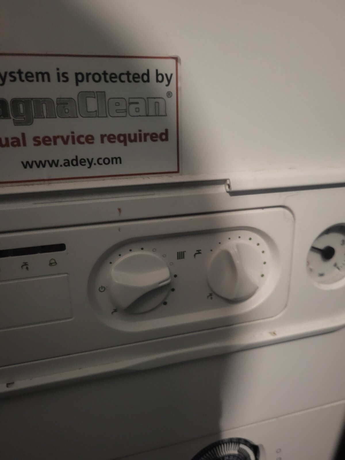

What should I set the radiator dial at on the front of the boiler while away?
