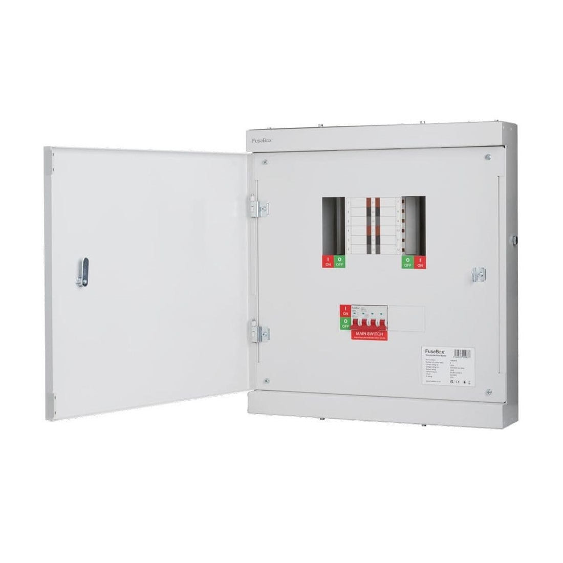

I think OP is in an enviable position of being able to obtain a whole 3 phase supply to the three buildings at no additional cost or at a mediocre additional cost for the different cable, they then have the option to do as they please. If separate metering is required; fitting private meters is far more cost effective than individual energy supplies, providing the administration of splitting the bill runs smoothly.
Splitting such a supply I'd suggest a 3ph dis board, example:

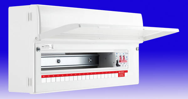

Or at least a decent sized fully adaptable CU
With a 3 or 4 pole main switch
Initially this may seem over the top but a couple of years down the road and a landlords supply or a 3ph into one of the buildings is required the benefit will be very quickly felt. It may also be cost effective with space and money compared with 3 fused switches and the spagetti associated with multiple henley blocks.

Splitting such a supply I'd suggest a 3ph dis board, example: ... Or at least a decent sized fully adaptable CU ... With a 3 or 4 pole main switch
It's obviously largely a personal choice, but mine was to go down the route of multiple Henleys (I think 6 SP ones), multiple switch-fuses (actually 5, not 3, since I somewhat simplified my description) and 'spaghetti' - not to mention up-front 3P+N isolator and 3 x Type S RCDs :)
