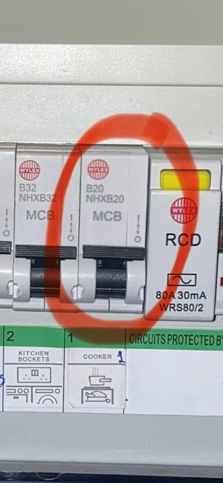

Hi there.
I am looking to replace my oven (I am looking at an 16amp double oven) but want to double check the amp rating on the fuse before I buy my new one.
Checking the fuse board, the cooker circuit shows this as B20, which I assume sis 20amps. Is this correct? So would assume a 16amp rated oven is ok?
I cant see it it's a bit blurred, but if it says B20 then yes that's 20 amps.
(Assumed from the labelling, your kitchen sockets are supplied from a 32a breaker, while the oven is from a 20A. Weird.
As above, turn it off and see if the oven turns off.
