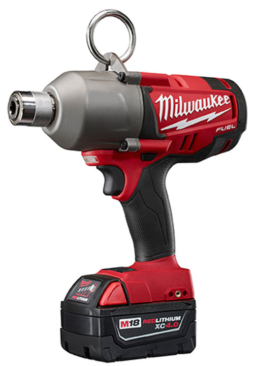

But can you get hex drive drill bits for impact drivers, that'll be a new one on me.
Milwaukee make a 7/16 impact driver purely for use with hex drive drills and augers.

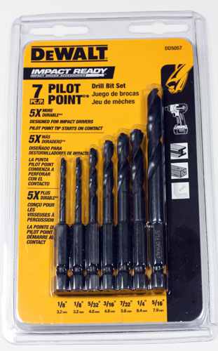

Thanks. Can you tell me where you found those bits for sale? I googled but can't find them.

Fair enough, but don't hold your breath! As I said, I shall not have the thing until 3rd August, then I'll think about buying some drill bits. I've found a set of 5 Dewalt at Screwfix for £5 but these look like masonry drills which I am certainly not going to use with an impact driver.
The ones that Sammyinnit posted look more like metal or wood drill bits, so I'll keep looking.
Just used those as an example but I've seen dewalt extreme Titanium impact hex sets for sale on eBay.
Milwaukee do them too...

...you see that rectangular indent, it's just a normal HSS drill bit that has been crimped into the hex holder. I have sheared off a few just drilling wood, using a normal drill driver. An impact will destroy each one, the very first time it impacts!! The Milwaukee and DeWalt drills are a single piece of metal.
Thanks Rsgaz. I can see exactly what you mean and I'll certainly avoid anything like that.
