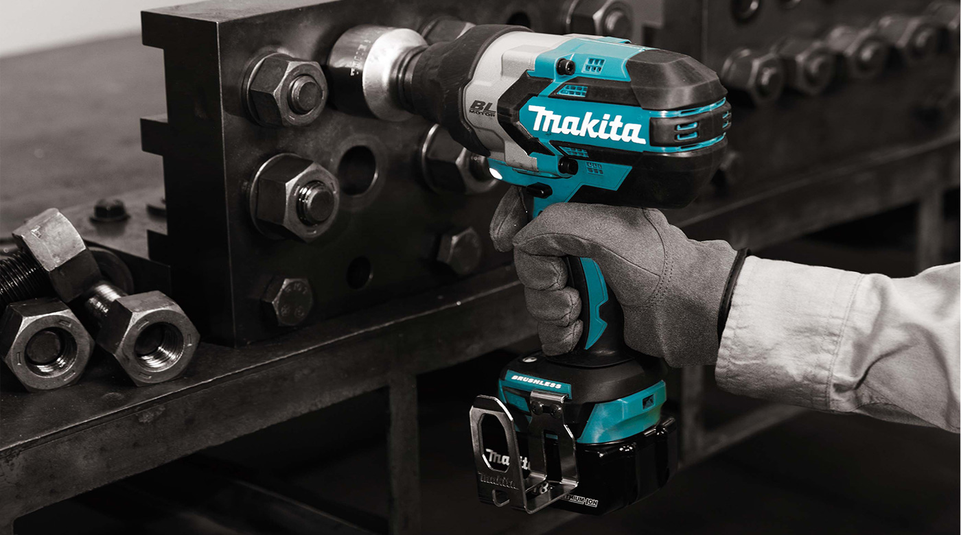

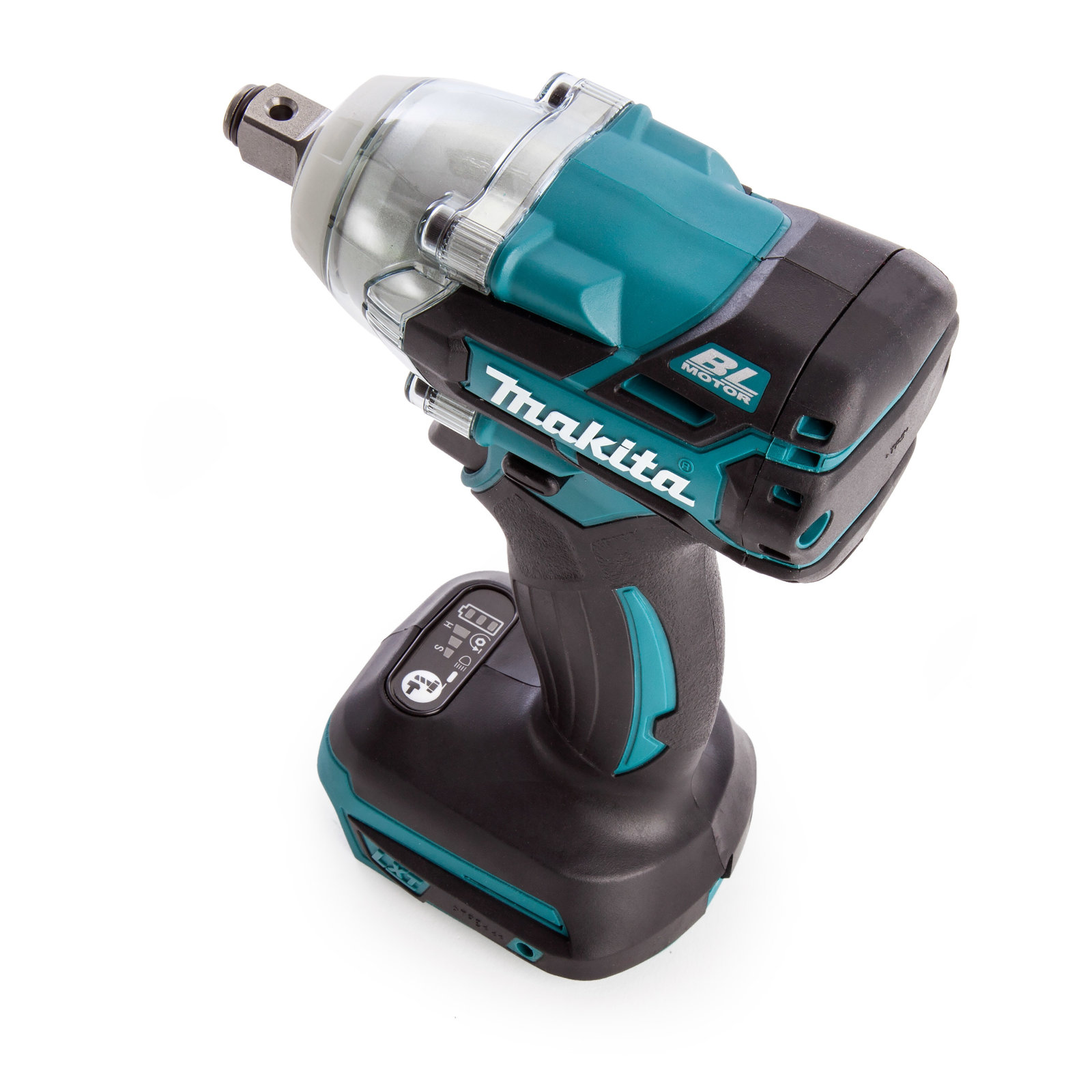

Honestly, don't bother. See the attached photos for something more suited to car wheel studs.

What?! I'm not made of money, you know!
Yes, you're right, of course. Car wheel nuts was just an afterthought.
I'll be using it for screwing and possibly bolts. Other applications would be just experimental.
