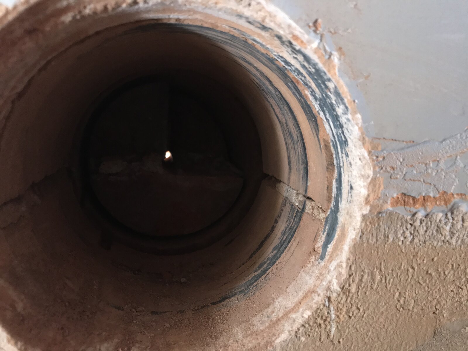

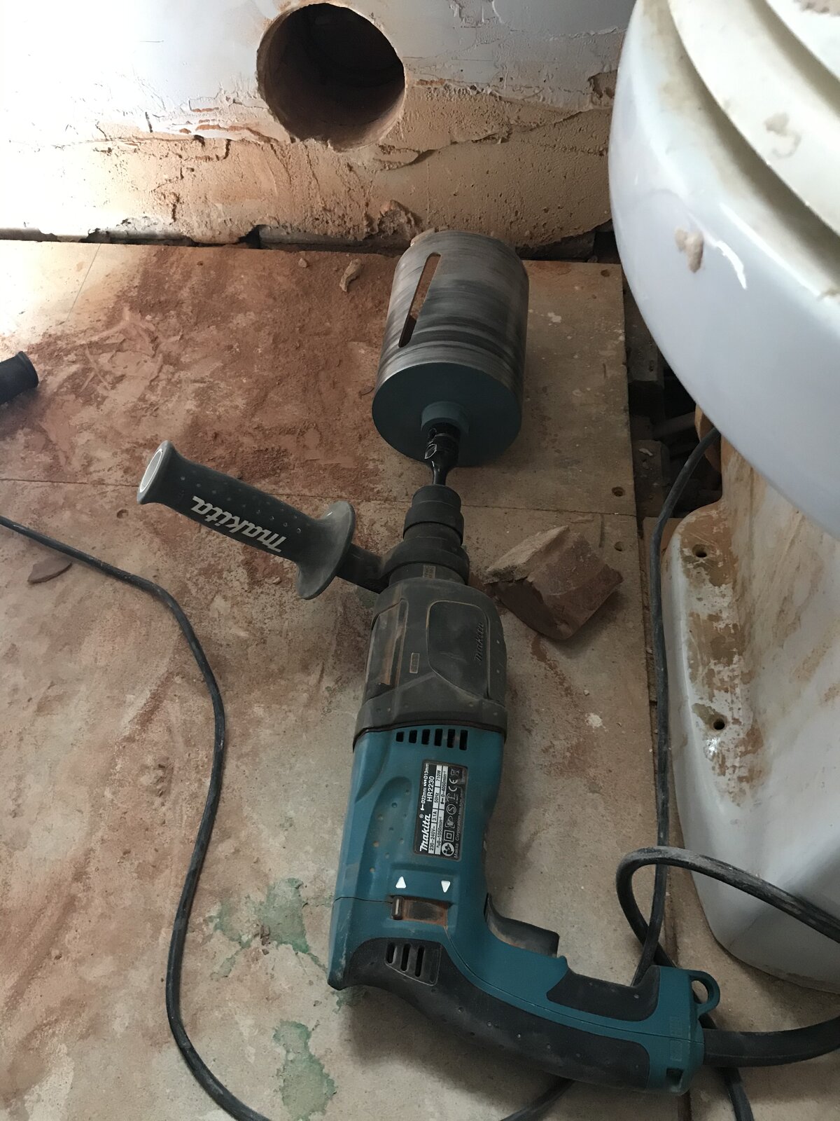

Coring a soil pipe....stuck!

I‘ve not been on site today, but thinking about it, and as daft as it might seem to some, I’ve left the 8mm pilot bit in. Some say you are supposed to take it out once the core has actually bitten in. If this is the ‘best practice’ then maybe the 8mm bit is snagging on a pebble (or whatever) in the brick and without the hammer action allowed then it simply won’t progress.
I shall remove it and see if I care any better.

Back to your job, definitely take the drill bit out! Also if there's only a bit of brick left then carefully chain drill it from your ladder and as mentioned make good with a collar.
Unless its a typo or I've missed something but Op says they are 230mm through the wall so must have removed part of the core or the bit would have bottomed out by that stage.
A pilot drill is a waste of time IMO, after all who drills a hole in masonry in non hammer mode which is whats required for diamond core drilling?...If one needs to use a pilot bit to help centralised the core then one should whack a pilot hole right through first in sds or hammer mode or risk the core bit not advancing by the pilot struggling to make progress.
Yes, I actually agree with this. So I shall remove the pilot bit and carry on. I have a feeling I’ll make progress this time.

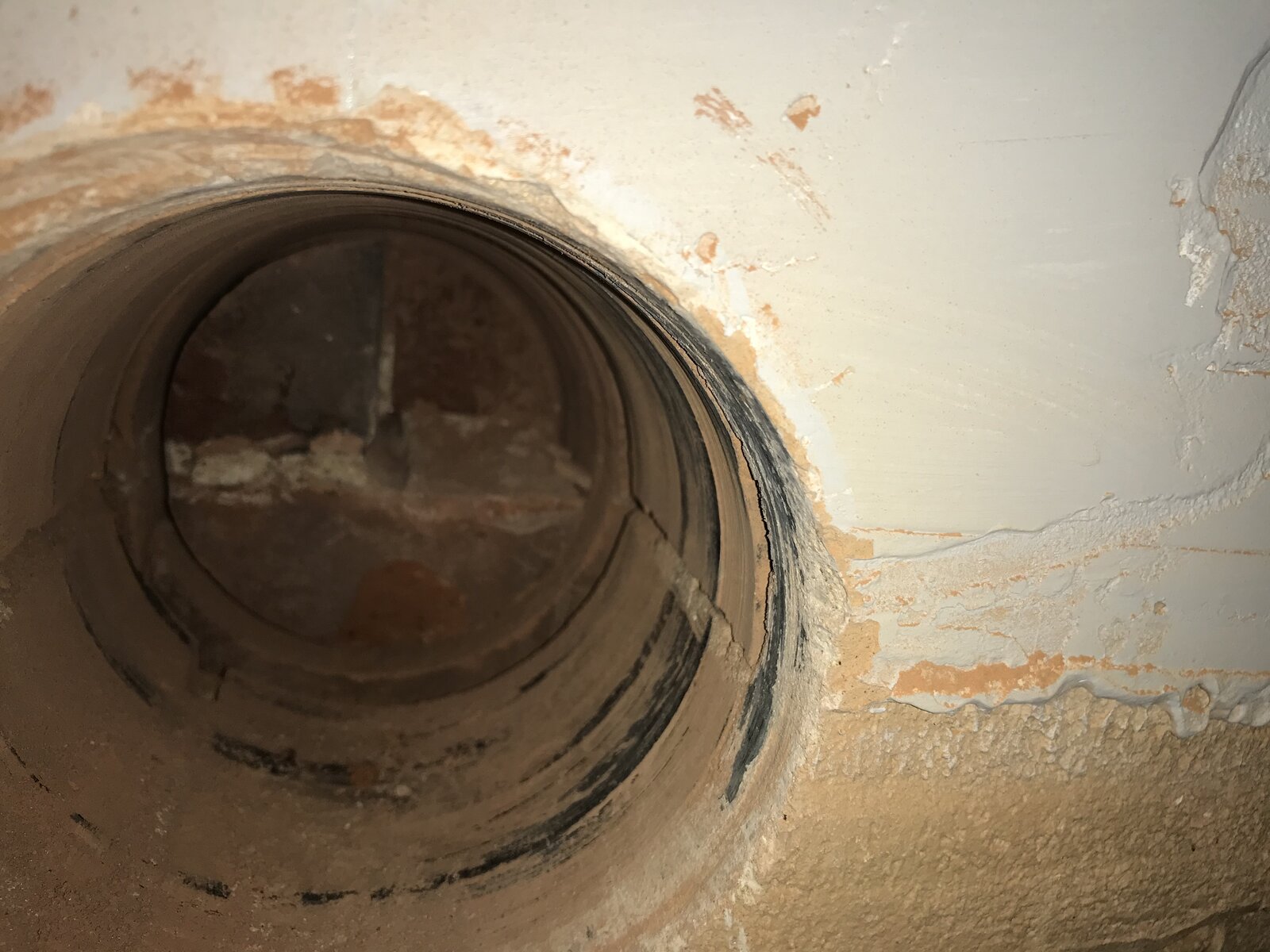

Hi guys,
So back on site. I used the 8mm pilot bit on its own to hammer drill through, which was only about 30mm or so. Then I removed it and continued with the core bit on its own.
It’s very slightly better, going approx 1mm every 2min(?) which sucks.
The pics probably don’t show much that could help but there ya go.
508D311B-5CF4-4958-AD77-0297D37F47FD.jpeg73915F40-61CB-449C-A184-72BAA2B85D7A.jpegFB95460A-F90E-45EB-B977-1FC9ACF356C4.jpeg
still reckon I have about 50mm to go.
edit; tempted to go to the local hardware shop round the corner and get a cheap core bit for this last 50mm or so, but I refuse to believe that this erbauer set is only good for ONE hole and that’s it. They had good reviews.
Why don't you follow the advice and stitch drill the last 50mm.
It will be much easier and less frustrating than lose more days on this hole.
