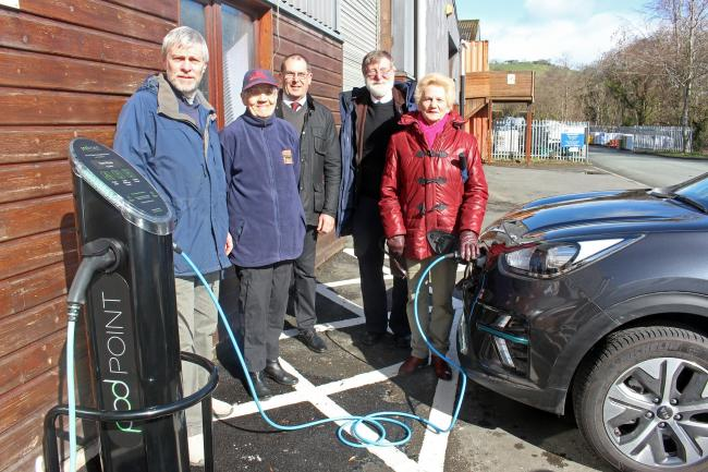

In the main, items used outside, so one can touch true earth and appliance earth at same time, are normally class II. There are exceptions, patio heater for example, and one does question if out door equipment should be class I or should the rules say class II only, specially for domestic.
So the canal boat is limited by where the canal goes, so the only items connected for an extended time are caravans, motor homes and electric cars.
I really can't work out why the electric car is not class II? But neither can I see why rules for caravans and motor homes do not apply to electric cars.
The whole idea of disconnecting earth seems wrong, did not like the idea of putting diodes in the earth connection either, however even if fresh water the current even if diodes fail should be limited.
If I want an electric car, I have enough room to charge it well away from house so no problem with a TT supply. But some charge points are close to buildings upload_2022-1-22_0-4-40.png but although I am told that one is TT, a metal frame building like that is not likely to go far from true earth even if the PEN is lost. Drawing on all three phases even with loss of PEN, there should not be too much imbalance, however it seems many cars only use a single phase, so large sign saying 22 kW is only valid if the car can take it.
