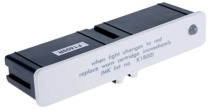

But the one item in list which does not cause problems is the SPD. When have you ever changed one of these upload_2022-1-22_11-47-31.png. I never have, we fitted filtered sockets when the PC came along, as we were told spikes could wreck the computer, the big question why was the filter not built into the computer?
So with many more electronic items being powered direct, not through a wire wound transformer, spikes can damage the components. But the component damaged needs to exceed £18.86 to be worth protecting with a filtered socket. Whole house some of the SPD's are down to £30 some over £100, so how many LED bulbs need saving to warrant the SPD?
So the question, how many times have all the lights switched on failed together? Think fair to say that is likely caused by a surge, but not seen it reported.
They undoubtedly "can" cause damage but, as I keep saying I haven't got a clue as to how frequentlky they "do".
As I always say, I've had countless electronic items powered by SMPSUs etc. for very many years, and what I would regard as 'premature failures' have been exceedingly unusual, almost unknown (unless one counts LED lamps/bulbs!).
As I also always say, it rather intrigues me that good few of those who now advocate (or stronger) SPDs are the same people who, not too long ago, ridiculed (and described as 'snake oil' or 'a waste of money') any mention of 'surge suppression'. Have these people perhaps suddenly strated experiencing lots of equipment failures which might possible be related to supply 'spikes' ... or what?

Loss of service until the damaged component is replaced could involve sums of money much greater that £18.86
I'm not sure that "loss of service" would often have any significant financial consequences in the domestic settings we're talking about.
In any event, what when tens of millions of £18.86 components are installed - in comparison with the costs which possibly {and very rarely} might result from not installing them?
I have a considerable amount of electronics here comparable to many other homes added together and I have never experienced such a failure in all the time I have lived here. Most of the modern and not so modern stuff I get involved with seems quite well designed to protect itself against mains spikes internally, so why might I need to pay more for extra protection? So my opinion is that one money stream has come to an end, so they have another one to convince people it is a 'must have'.
Exactly. My experience is the same as yours, and I totally agree with what you say.
Quite apart from commercially-manufactured items, I have many items of electronic equipment which I built 30-40 years ago, using very old technology, and certainly no explicit protection against 'spikes/surges', which remain fine after those decades in service, in at least some cases in virtually continuous powered-up service for all those years.
One can 'understand' manufacturers wanting to find new ways of making money. What I understand far less is why individuals, organisations and those who write regulations should succumb to the belief that there is a reasonable justification for needing, or even 'requiring', that these bits of new-fangled technology should be used. I can but presume that an awful lot of gullibility (and far too little ration thought) is at work :)
