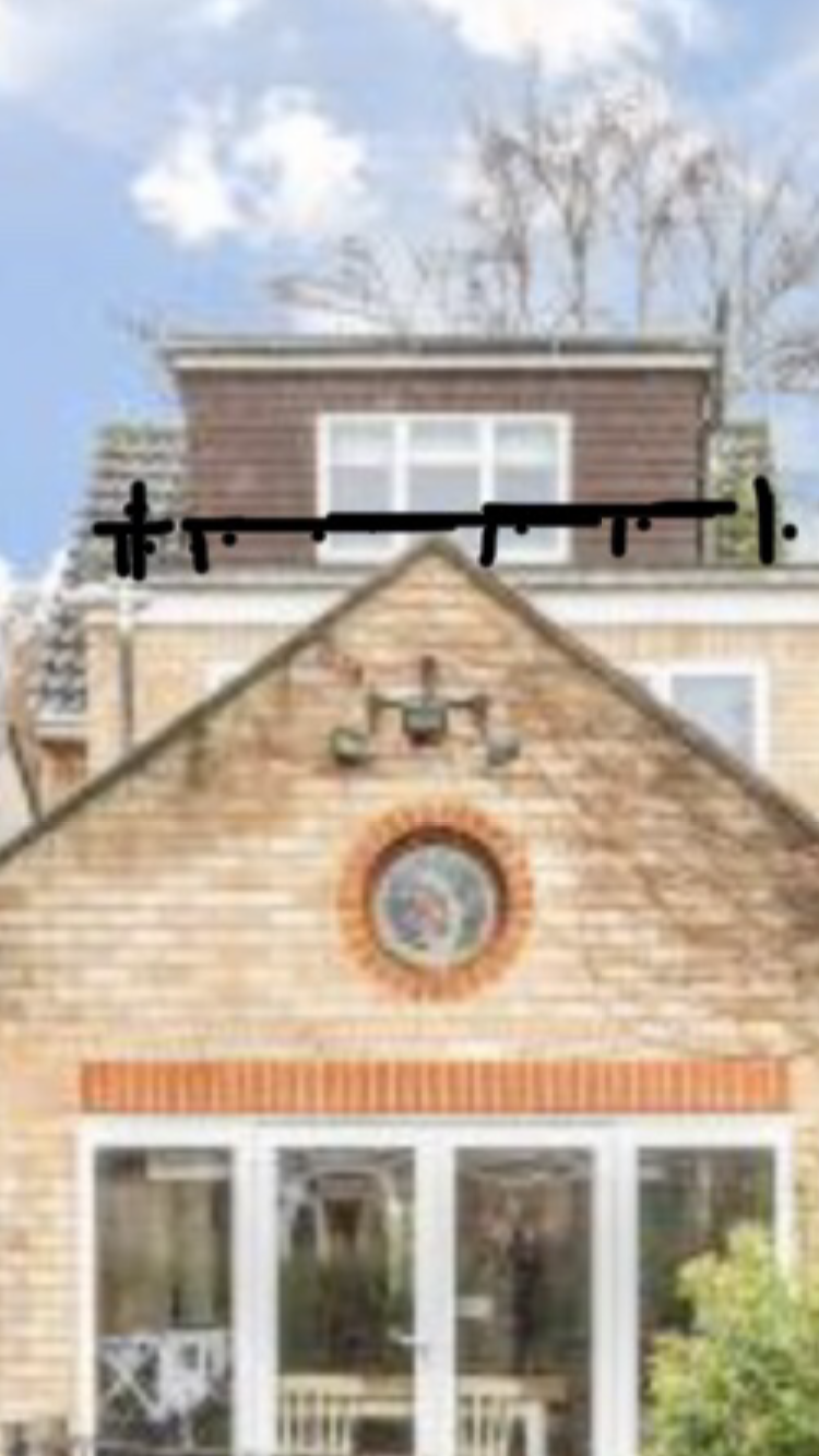

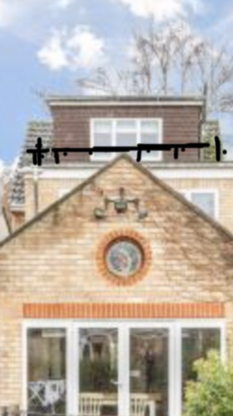

Also, another slight twist... would I have an issue if after the installation of J balcony, I then went ahead and installed guard rails as I have drawn on the picture supplied? I’m thinking it might be better to have something that stopped pots rolling off in the event of high wind.View attachment 192170

Would part K require structural calculation on timber/the roof to see if it’s up to holding a person weight? As I previously specified, no regular usage, just to hold potspart K will mean the balcony balustrading will need to be 1100mm high -
Part A is to do with structure.
Joists designed and specified for flat roofs allow nominal loadings for access and maintenance. But when you start talking about balconies, that is where the issues and significant additional loads comes into play.
How about erecting a minimal railing, a few inches high, around the edge..
