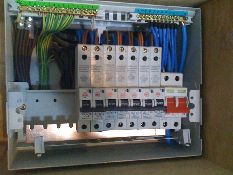

Unfortunately my memory is going from bad to worse.... Ok I know that this is the wrong forum for this kind of problems. So help me out please:
I am starting a job where I will have to change the CU. the configuration I use is of RCBOs. In the past I use Hager, Contactum, MEM, MK etc. Can some one with a better memory than mine to remind me which one of them is better for this configuration; because of the space above the RCBO in some of the CUs is not great.

I think Hagar give the most room, but i'm sure someone will be able to correct me
I've not encountered any problems with the amount of space in Wylex enclosures, as long as you lay your cables out nearly and plan ahead then I can't imagine any brand should cause major headaches.

I always finished the job nice and nit, but with some of the boxes I found that if you have a ring (4 x 2.5mm2 wires to connect to the top of the RCBO) or using radial with 4mm2, or 6mm2 for a cooker, it becomes a bit of a struggle).

You ever tried to put an RCBO in an older hager CU Rob?
I almost had to use a shoehorn to get it past the outgoing circuits :LOL:
Looking at their catalogue the newer ones have a lot more space above the DIN rail

The Wylex ones do NOT have much room if you fit all RCBOs. One option to provide more space in them is to not use all of the available ways - leave a space between some/all of the RCBOs.
Most makes of double pole RCBOs will provide a lot more space, as they are usually 2 modules wide and the same height as an MCB.

Honesty can't see the problem, mine at home is fully loaded with RCBOs (2x RF, 3x lights, 5x 16A radial in 2.5 and 1x 32A in 6mm) and, while it could have been roomier, there was enough space in there to be able to make a fairly neat job of it. There are no gaps between each module.

You can always move the din rail down. There's usually room below the busbar - particularly on concealed busbars like the Starbreaker.
This is interesting, never tried this, I think that many of them do not have enough space under the rail but this is something to look for...

Wouldn't moving the din rail down stop the cover from fitting on ? :eek:
