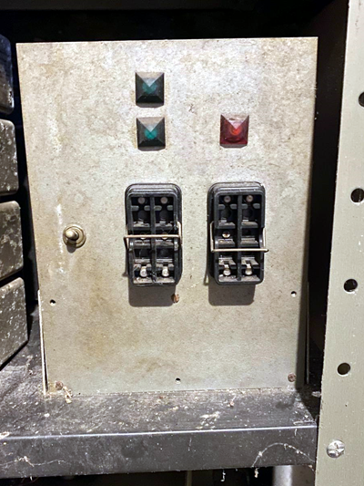

It seemed totally standard practice back then to fuse both poles of an incoming mains supply,and widespred use was made of Belgin dual fuse holders for this purpose.
