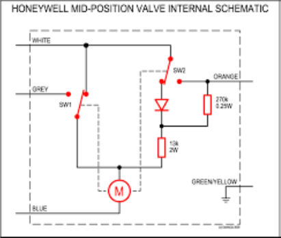

It is either wired up wrongly, or the valve is sticking despite your suggesting it is doing what it should.
If it's any help, here is the internal wiring of the mid-position valve
Disable hot water at the programmer and then try increasing the room thermostat temperature to double check that the boiler is still not coming on for heating-only, ie valve at H position.
When at H position give the lever some help to go as far as possible in that direction, just in case it's a bit sticky and not going far enough. It needs to go far enough to operate the internal microswitch which turns on the boiler.
The valve goes over to H and has stayed there even when I re-enable hot water and/or turn on the hot tap. It's right across under H and won't go any further.

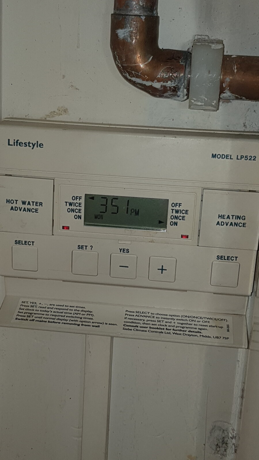

What is interesting though, that I didn't notice before, is that even when the hot water is set to "Off" on the programmer, the red light comes/stays on, if the heating is on:-
In other words, I can set hot water "Off", "Once/Twice" or "On", and that doesn't affect the heating side, but if I put the heating "On" (or set it to "Once/Twice", during the "On" hours), the red light under hot water comes on with it, even though the little arrow indicator stays at "Off" (see picture). Is that supposed to happen, or is there an issue with the wiring in the programmer? Could that have any bearing on the main issue of the heating working independently of hot water usage?
Although you have a fully pumped Y plan system, someone has set your programmer to gravity you need to set it to fully pumped, you remove the programmer and move the little jumper to pumped
That's interesting - it links back to a comment John D made earlier about a setting at the back of the programmer.

Managed to get the boiler casing off and access the programmer, and took it off the wall.
The jumper was indeed set to "G" instead of "P", and I therefore changed this.
This has solved the "red light" issue, and both hot water and heating now click on and off independent depending on setting, as hoped. Thanks for all the guidance on that.
