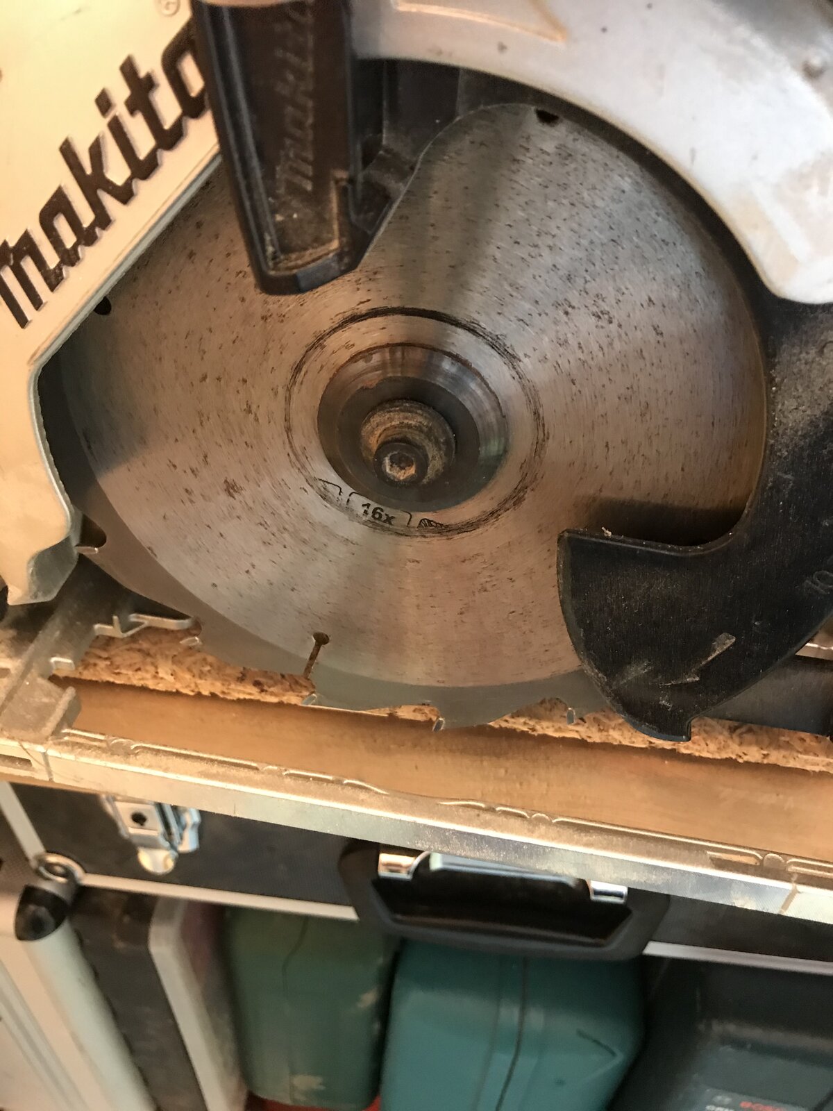

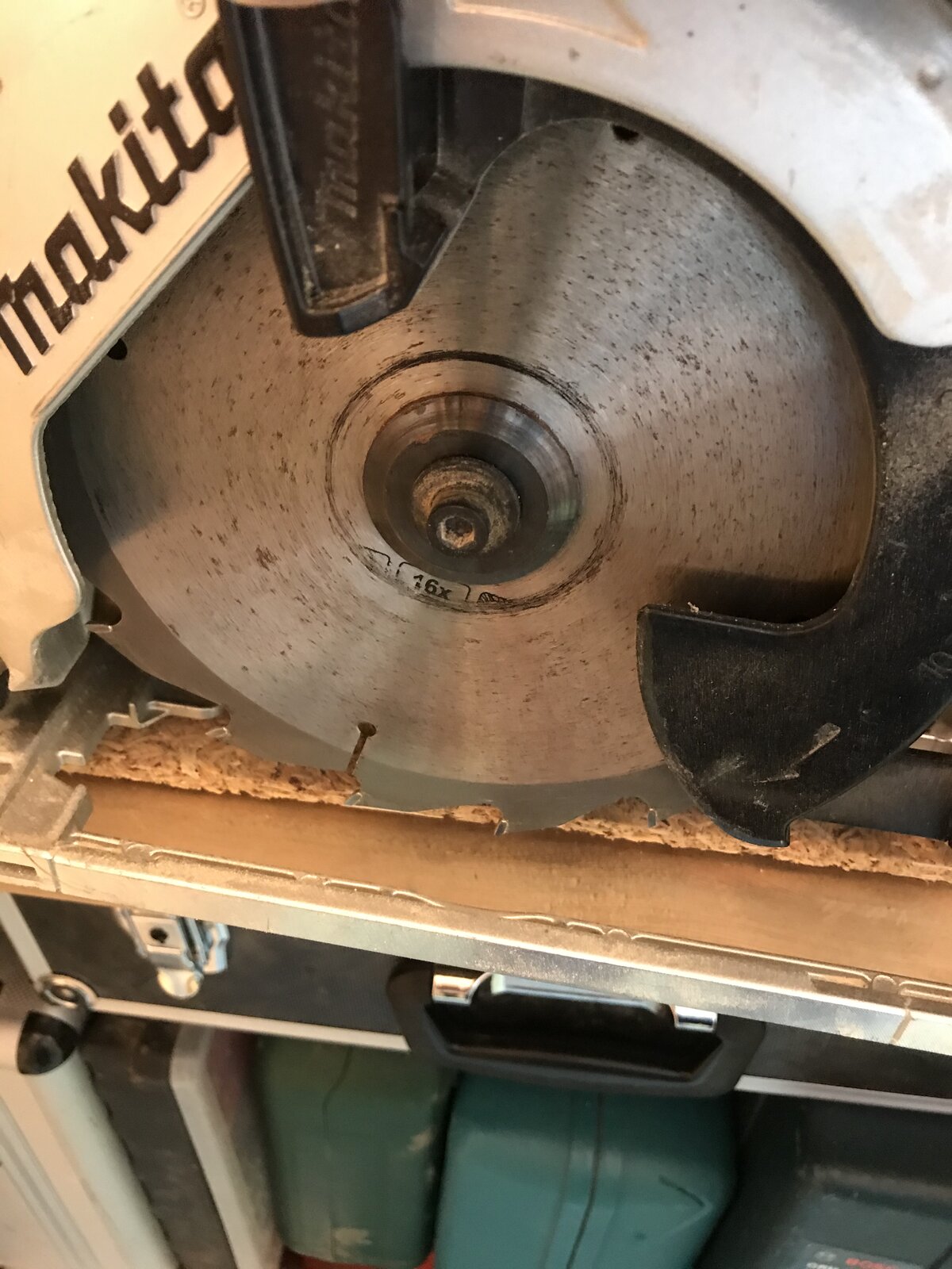

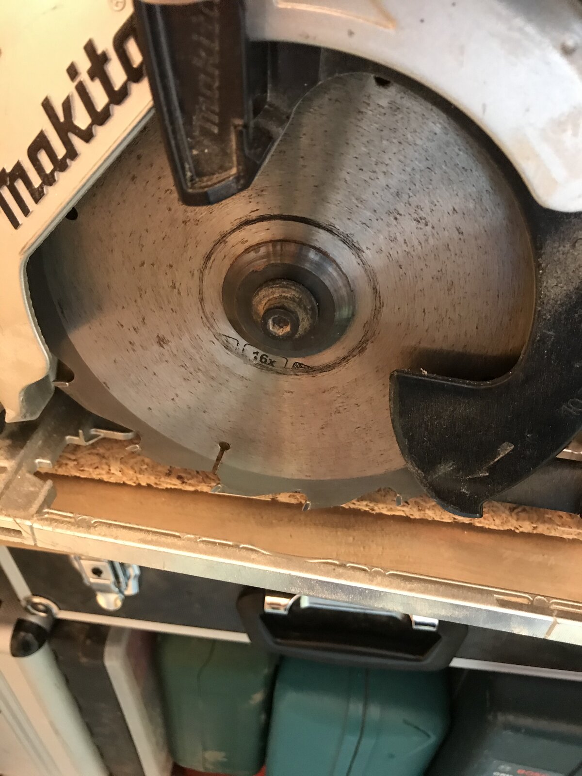

Does the blade on this seem appropriate for the worktop cut?
Thanks for all your help.
