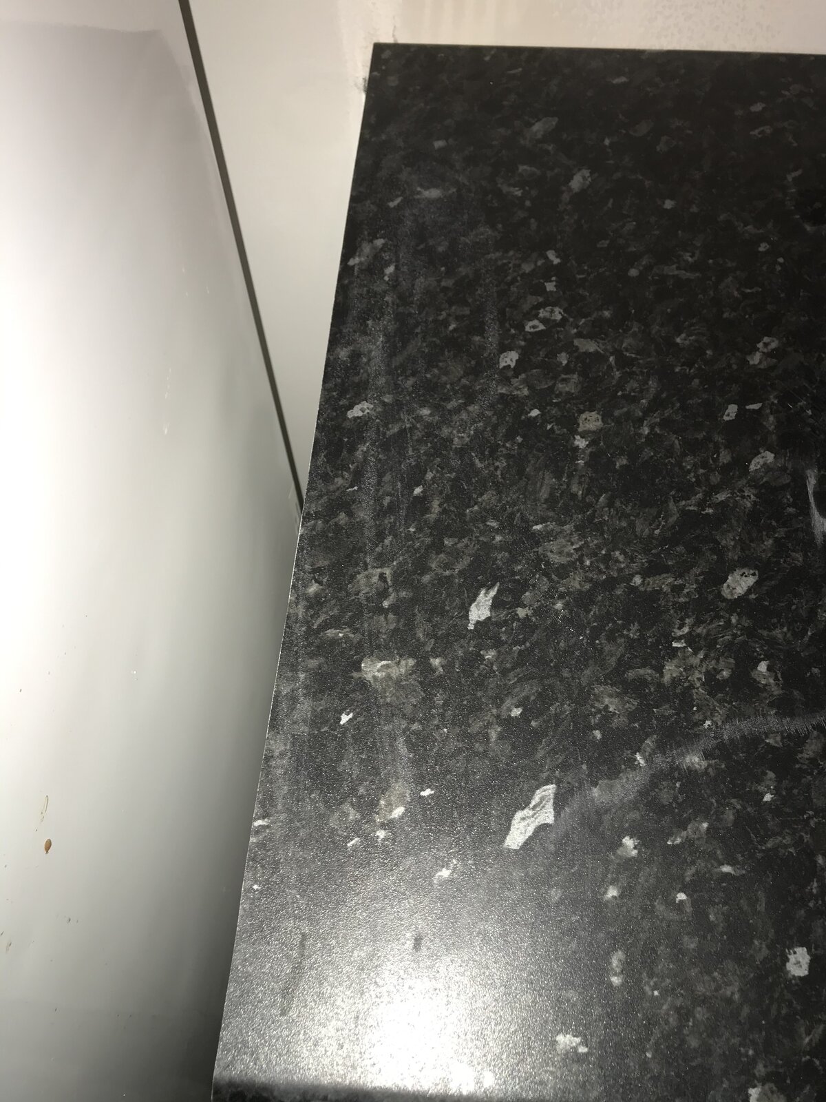

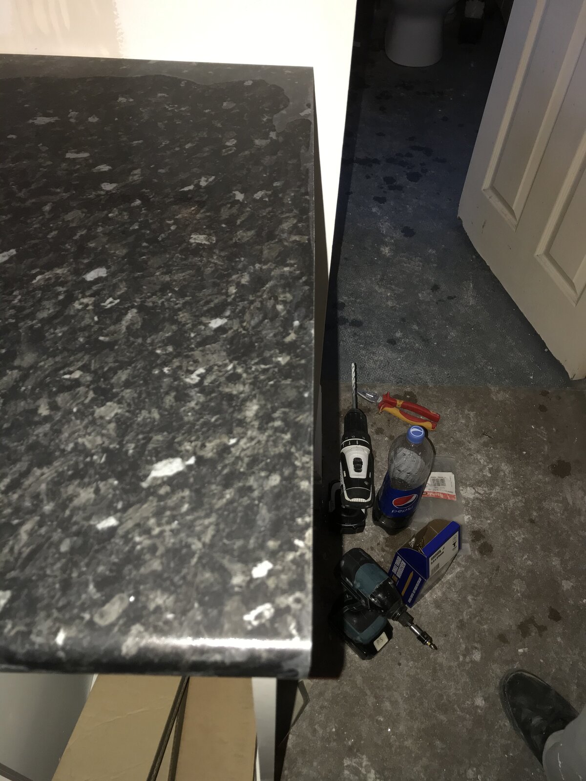

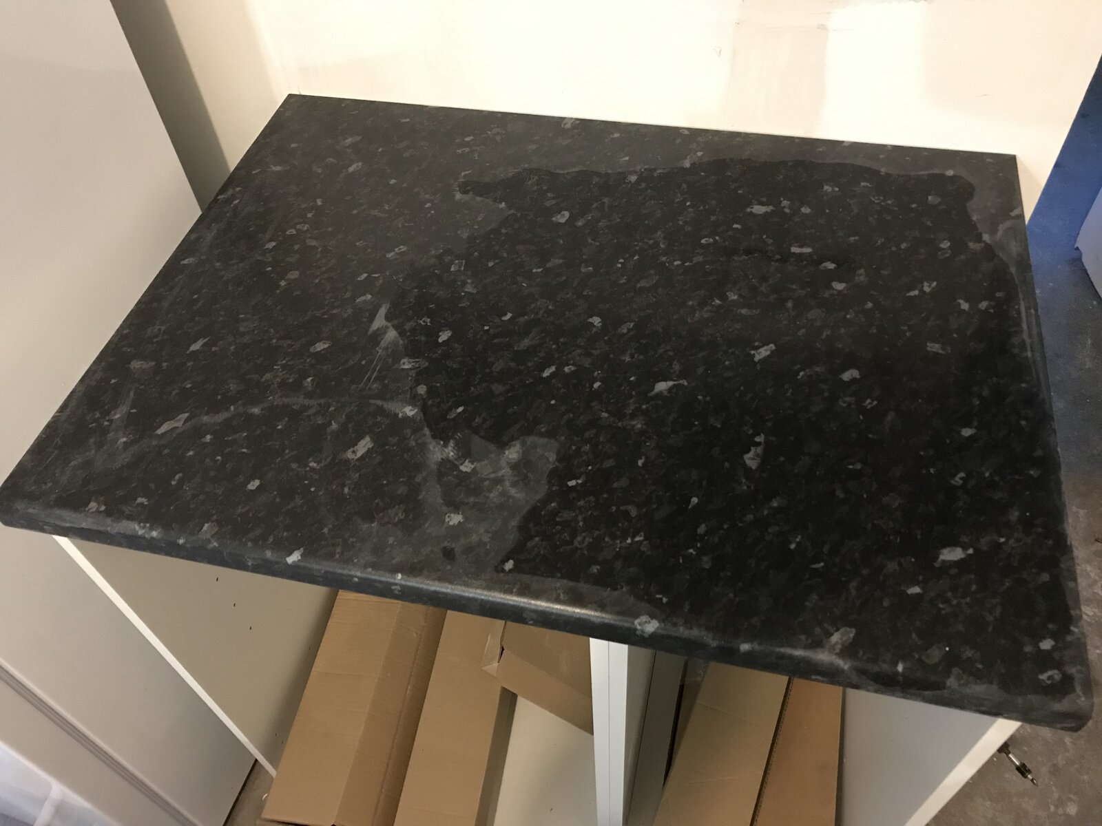

UPDATE: As per advice, I was planning to order a new blade for my saw today but Screwfix won’t have one until Tuesday. I thought I’d do some test cuts with my old blade and was very pleasantly surprised. The cuts are flawless!
I followed the advice to cut from front to the back.

those cuts are quite impressive when you consider the saw blade has all the wording worn off up to the maximum plunge depth:D
this normally suggests abuse and much smoking off timber when cutting
i would suggest although the top looking like a clean cut the blade may be quite blunt and that can cause blade lean and deviation as the cut is more difficult so pushes the blade sideways and off square so check the straitness and how square the cut is
It’s square too as I needed it to be with this small section of worktop :)

do you have much spare worktop??
if so you can just use the blade you have iff the finish satisfactory then iff it chips get a new blade and have another go
