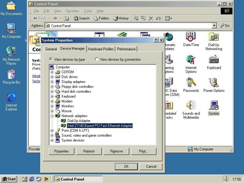

OK. I understand everything in your post, but focussing on the IP address...
You'll find the NIC device in the Device Manager (Control Panel->System->Hardware), but in Windows 98/Me you need to run the Network Control Panel applet to configure TCP/IP.
I've stolen an image from the Interwebby to illustrate what you need to do, as follows:
View media item 1027
Clicking on your image tells me I don't have permission to view your file!
Mine eyes art not what they used to be...
EDIT: Think I've done as you suggest:
Changed setting to automatic IP address option.
BTW, the addresses in there already were:
192.168.0.11
255.255.255.0
Weren't they the right addresses anyway?
