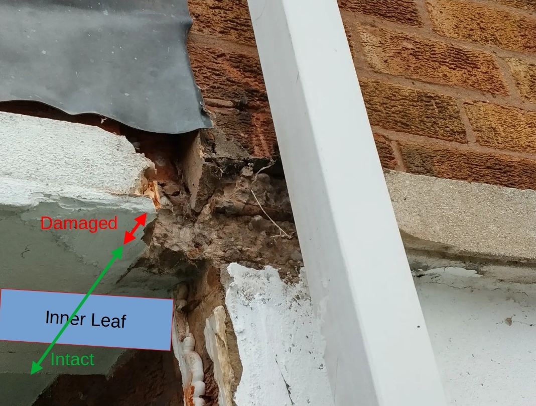

Damaged reinforced concrete lintel - what to do?
Well if its just part of the nosing nib and not structural in either bending or shear I would have to agree none and as stated,
It must be more than just the nosing nib if the steel bar has been cut surely?
Hard to tell from the pic but woody seems to think it is. Does the beam ( as that what it looks like) support bwk directly above it i.e. there isn't a projecting nib as such. If it does then severing a length of steel in the tension face of a RC beam is not to be recommended. Having said that there are all sort of FoS included in the design, be it actual loading, strength of concrete or reinforcement, so as stated, the test of time resulting in no undue visible issues should ease your worries somewhat, but nothing is black and white. If its any consolation at least its not in the middle of the beam where the BM would be at its greatest but at the edge where whilst shear is at its greatest there the reinforcement in that area tends to be due to the continuation of the bars designed to resist bending and as such the actual shear resistance provided is several times greater than that actually required.

If it means some of the concrete which forms part of the lintel sticks out/protrudes from the wall somewhat then yes this is the case. Probably an inch or more sticks out and from the underside where the lintel is good and not been touched, and there is a slight groove under the whole length just inside the underside edge.
However the steel rod from what I can see is not within the nib part but sits just inside the part which would support the bricks.
I would think it's supporting the bricks above certainly the outer skin, possibly the inner skin and maybe the first floor level above too depending where the weight of the floor beams is directed? Not sure if some of the roof weight could being directed towards the front and rear walls of the house or whether this would all be directed towards the side walls?

The beam actually continues all the way along the semi detached through to the very end of next door's house. All the way along the semi detached structure.
So effectively the cut in the steel is quite near the middle of the whole beam if it is deemed to be one beam running through both properties.
Also next door have a conservatory and it looks to me like the lintel/beam has been damaged there too where their conservatory is attached to the house. I can't see if the steel has been cut on their side as it's covered with flashing but there's a sizeable gap in the lintel where it's certainly been knocked back at the least to fit their conservatory flush and the steel could well have been cut there too to be honest.

In that case I think we can safely say the structural integrity of the beam has been compromise but to what extent and to what effect is open to debate. Go with test of time, FoS involved and probably over designed in the 1st place
It's a slab, not a beam and damage to small local areas do not affect the performance as a whole.
After more than 30 years, what signs of movement are there to the rest of the slab and the wall above?
None? Then just patch it a previous post and move on.
The outer wall does not support the floor or roof, that is all done by the inner wall, and the damage to the beam is nowhere near it.
The outer is just a weatherproof skin, it only has to hold itself up. Remember that the bricks aren't made of jelly, they can support themselves to a degree. If you completely removed all support under that corner then perhaps 3 bricks would fall out, the interlocking bricks above would hold the rest.
The inner leaf is the one that does the real work, and it is fine...
IMO the disruption and further damage from any structural repair efforts would be far more likely to cause damage than just leaving it alone and patching up.

Thanks. Out of interest what is the difference between a slab and a beam?
Very informative, thanks. I wonder if that's why it does seem to be proving the test of time so far, because most of the structural weight via the inner bricks is being put onto the in tact inner part of the lintel.
