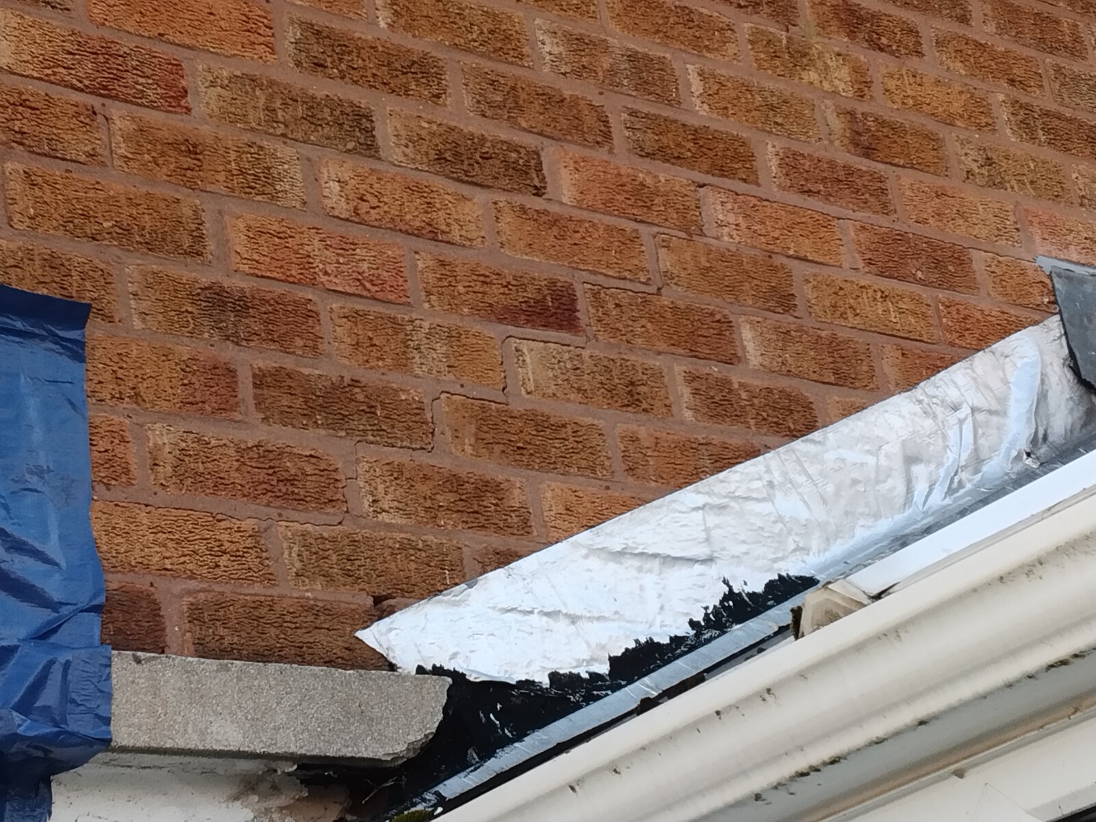

Damaged reinforced concrete lintel - what to do?

An update, the neighbour came around to see how the refurb was going and I pointed out how we'd found the lintel on removing the conservatory. They pointed to theirs looking similar but covered by flashing above their conservatory.

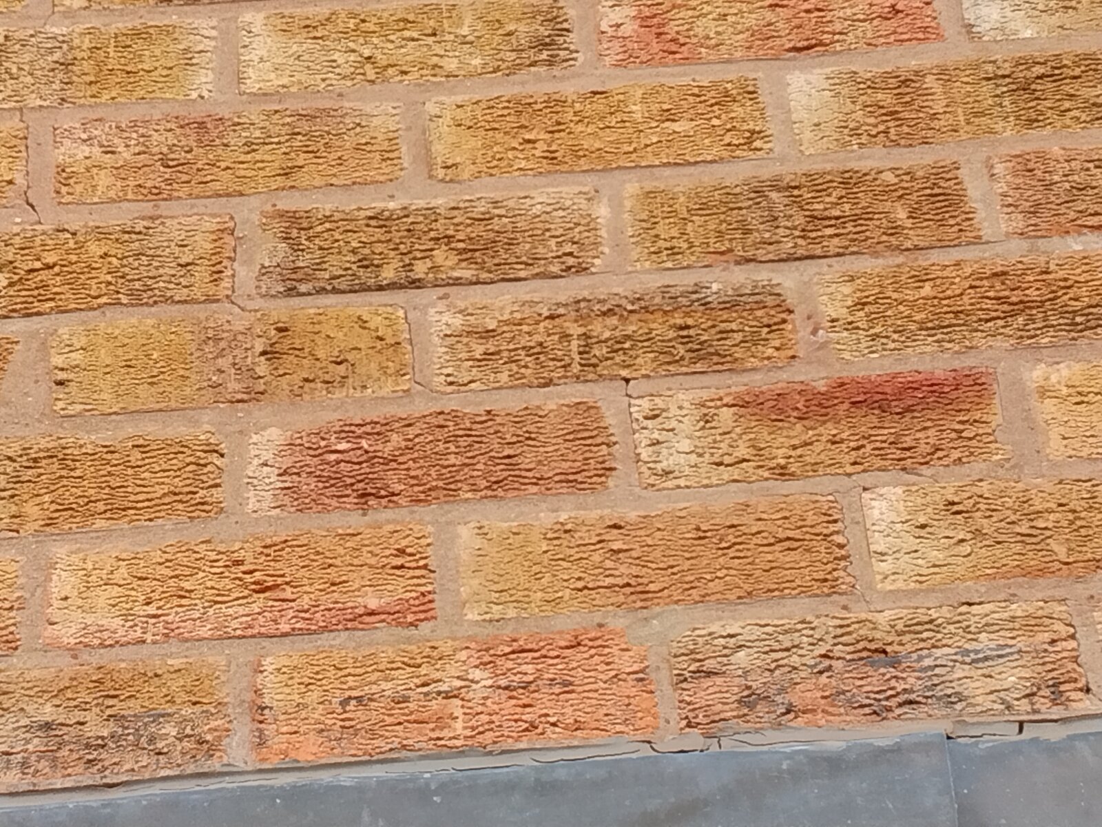

They then noticed a diagonal crack going upwards above and to the right from the approximate area of their own damaged part of the lintel and pointed out a couple of cracks (probably 2) within the pointing above and slightly left of the damage on our side.
Will try and get some photos later. Hadn't noticed until they did.
Noticed yesterday one diagonal crack running on next door's side running up and away from the area between the two separate lintel cuts.
Followed by diagonal crack on out side running in the opposite left hand direction away from the lintel damage. The lintel damage is to the bottom right hand side of the second photo.
Does this potentially change things?
I don't understand where the second picture is. Is it yours or next door's property? Is the flashing at the bottom of the second picture the same as what you can see on the extreme right of the first picture? Is your neighbour's a mirror image of yours? How far is from the bottom right of the second picture to the horizontal flashing you can see on the right of the first picture?
If I'm seeing what I think I'm seeing then it doesn't change much.

The second picture is our property and is directly to the top and left direction of the damage. I had to zoom in to show the crack and then it was no longer possible to show the damage within the same shot.
The flashing on the second image runs above the lintel and runs all the way along the back of our house and is simply what is remaining from what used to waterproof the seal to the conservatory all the way along. Have a look at first post and you will see it (the flashing) on there.
It's not a big crack with no broken brick and personally I wouldn't worry about it. I can't think of any reason why it would get worse apart from water getting into the damaged region, and even then it would take a very long time to cause a problem.
The crack is there because the outside of the lintel to the left of the damaged region has dropped by about 1mm. About half of the weight of the brick work above the unsupported span would have originally passed across the now damaged region. Now it has found another route. I guess towards the right across the remaining undamaged region of the lintel with a small amount to the left side of the span.
The factor of safety has been reduced by the damage but it is still greater than 1. A structural engineer will look for ways to restore the factor of safety to that required by current building regulations. Without doing any calculations myself I would guess that your helical bar solution would be sufficient. Contrary to what I wrote before they should be centred on the crack, close to the bottom, with I guess about 3 brick lengths on either side. Removing the mortar the full depth of brickwork risks weakening the structure temporarily. I'd avoid that and go for single bars on more courses.
An alternative solution would be to put in a column at the right hand side of the unsupported span flush with existing wall. I don't see any merit that right now, but simply present it as an option in case more information comes to light.
