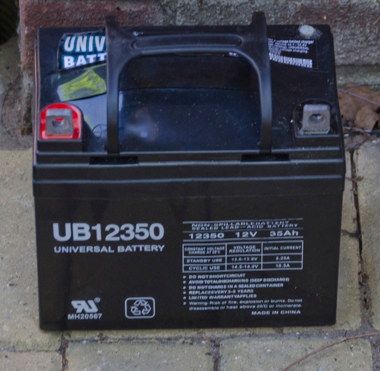

Wasn't sure in which category to post this enquiry, but here goes.
I've just bought a mobility scooter for my dad. He has just had to give up his driving licence, and can't walk back home from the chippy fast enough to avoid cold chips.
I half expected to have to buy a pair of new batteries (each 12v, 30Ah deep discharge), but after topping up with de-ionised water I still tried to charge them on my smarty-pants motorcycle charger. After about 24 hours on charge the first battery was gassing-off furiously on one cell, taking 4A of current, and measured about 10vdc open circuit. The second battery was charging at 2A, not gassing, but only about 7.5 v open circuit (both readings immediately after disconnecting the charger).
Are they goosed beyond recovery? I expect so, and intend to connect them up for a trial run tomorrow - obviously after dark so the neighbours don't see me!

Looks like it , from memory anything less than 10.5v is a knackered battery.
I take it your charger is a smart one capable of reviving dead batteries? If so then the batteries are goosed and need replacing
If you were able to recharge them chances are that they wouldn't last long when put under load anyway leaving your poor dad's chips getting even colder cause he has to push the scooter home
Yuasa brand batteries are high quality and we use them all the time in industrial applications. Reliable and always meet their spec.
All of the battery cells should gas the same - it's a sure indication of a knacker if they don't.
One more vote for Yuasa - the best by a mile.

Topping up? They must be very old batteries almost all modern ones are sealed, especially mobility scooter ones. Both read as if beyond redemption, Yuasa is the recognised deep discharge battery now.

I've tried to follow this thread, no really I have, but I have concluded that the old batts are dead - long live the new batts! Fitted and working I faced the ignominy of driving a 4mph (max) mobility scooter 5 miles in driving snow and pelting rain (I'm tough, but don't let that cloud your judgement) to prove the scooter's range. 5 miles is plenty, enough for the weekly supermarket shop AND those Friday night chips with curry sauce, my street cred only saved by the use of a shopping face covering.
So the problem is solved; two new Yuasa AGM 36Ah batts and the old rocker is rocking again...ride hard, die fast (or coughing, if the new strain gets him).
