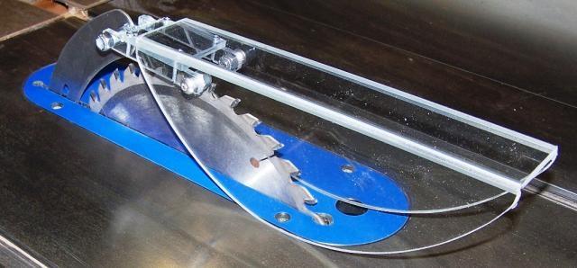

First off for parts I'd suggest that you ring Solent Tools on 02380 578057 as they seem to handle parts for a some of the DIY brands such as Performance Power, Erbauer, Macallister, Power Devil, etc. It's worth a shot, IMHO. If they can't help you then it may well be possible to make-up your own from something like 1.5mm steel providing you have a vice, a hacksaw, some drill bits, some files, an angle grinder and a bit of patience. The problem about using an item from a different saw is that it might not fit the clamp correctly (although that could probably be corrected by judicious use of files). At the end of the day a riving knife, be it on a £20k panel saw or a £100 DIY saw is pretty much the same thing, a piece of curved metal with a slot in it shaped to fit the blade and with the front edges chamfered:
Above: Making a half moon riving knife. This riving knife is specifically designed to be used with an overhead crown guard but the photos illustrate part of the making-up process In order to mount a crown guard the riving knife needs to be extended upwards (see design below)
Below: Riving knife with mounted crown guard. Personally I'd extend the side/top cover back a bit to fully cover the blade, but this illustrates the method of mounting the guard onto the riving knife quite well

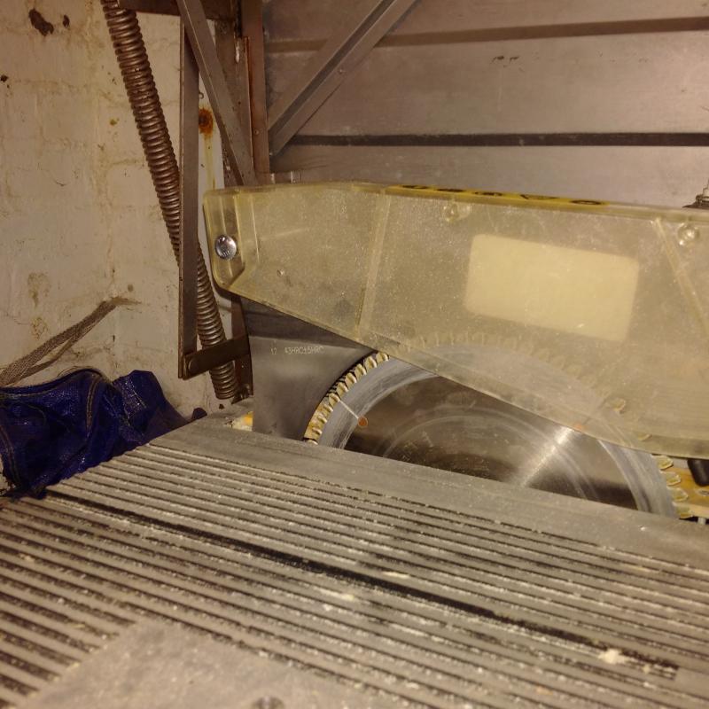

Update:
Turns out the saw is still sold in uk by machine mart
https://www.machinemart.co.uk/shop/...36-527-10-table-saw-230v?da=1&TC=GS-060611527
I ordered the draper riving knife and it fits perfectly. It also allows me to mount the blade guard and make the saw safe(r)
Shame the riving knife I got is bent.. 4mm out over its length. Will have to send it back and get a straight one :rolleyes:

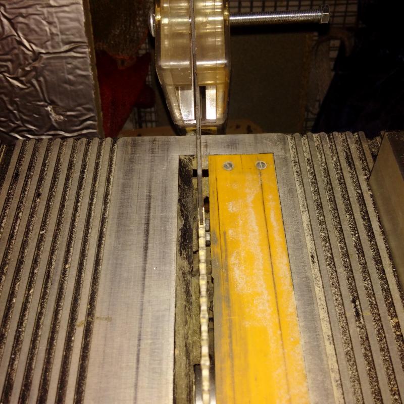

Well I bought a draper riving knife with the correct mounting orientation. No mods needed except it was 4mm out (bent) along its length. Thanks draper....
Managed to flatten it and get it lined up
It also had the correct (I think) hole for the blade guard and it seems to function as intended now. Just need to cut the bolt and fix it together.
