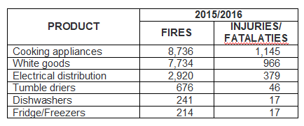

3. Major products involved in electrical fires in 2015/16:
Cooking appliances were the highest cause of fires in England in 2015/16 at 8,759
A DTI report estimates that 20% of electrical fires could be prevented by the presence of an RCD
As for the 'breakdown', all they offer is the following. The number of fires in this table adds up to 20,521 - I'm not sure how one squares that with the total of 15,432 'electrical fires' mentioned above. "Electrical Distribution" may or may not relate to the fixed installation wiring ...

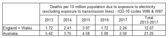

I've produced the below table to facilitate comparison. To avoid very small numbers, I've expressed the figures as 'deaths per 10 million of population', assuming ball-park population figures of 58 million for England & Wales and 24 million for Australia.
The figures for Australia are certainly consistently higher than for E&W. Even the inexplicably low ('incomplete'?) figure for Australia in 2017 is higher than that year's figure for E&W. As always, we don't know any details of those deaths - e.g. whether they occurred in homes or workplaces, whether they related to defects in electrical installations or appliances/equipment etc. etc. - but I think we can safely assume that the figures (in both countries) overestimate (perhaps markedly) the number of deaths in homes due to defects of their electrical installations. That latter category of deaths is quite probably 'tiny' in both countries.
This obviously does not support an argument that Australia's regulation of electrical work has resulted in 'fewer electricity-related deaths'! However, it does raise the question as to why there are consistently more deaths in Australia - does anyone have any ideas? For those deaths (however many) related to domestic electrical installations, does this imply that Australian electricians (who will be doing nearly all the work) are less competent than those (including DIYers) undertaking such work in the UK? Is the Australian population less careful in not putting themselves to electrical risk? ... or what?

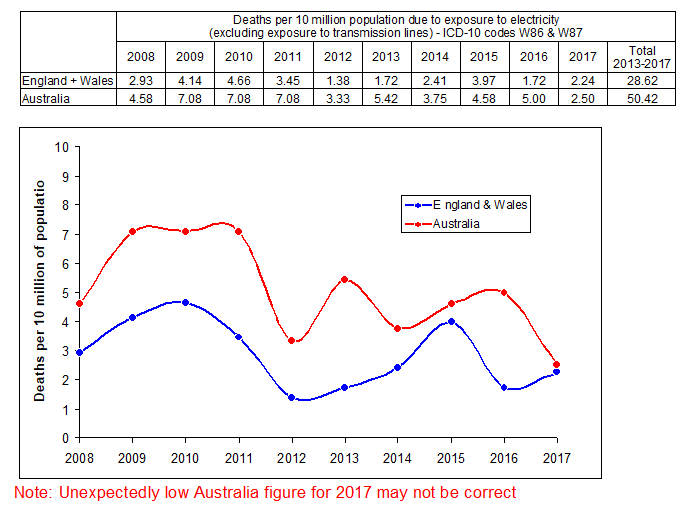

I'm struggling to find pre-2013 data for the UK, but it must be there somewhere. If/when I can find it, I'll present data which covers a longer time period than the above. It would be particularly interesting to find data going back to the pre-2005 period, so that we can see what change (if any) occurred after introduction of legislated regulation of electrical work.
My struggling eventually triumphed, although it proved to be a tedious exercise. Anyway, I now have UK data covering the same period as the Australian (2008-2017), which I present below in both tabular and graphical form. The unexpectedly low Australia figure for 2017 remains 'suspect', so should probably be taken with a pinch of salt.
A common theory is that the draconian rules in Australia mean that people are more inclined to bodge things (e.g. extension leads under carpets because they need a socket somewhere), and less inclined to do repairs.
Yep, that's credible as at least a partial explanation.

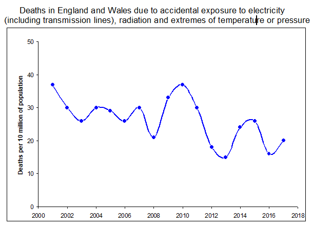

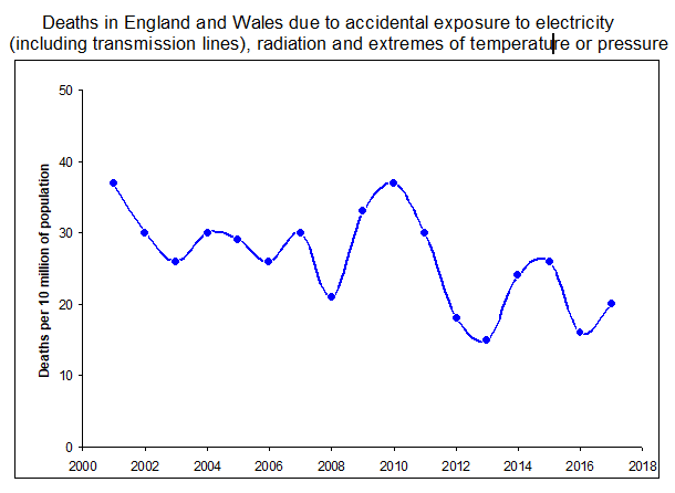

I've found some UK data which goes back to 1999. However, prior to 2006 I cannot find a complete breakdown into ICD-10 codes (W86 & W87 being of the most potential interest to us) and the best I can find is the total for W85-W99. That includes all deaths due to exposure to electricity (including transmission lines) together with accidental exposure to radiation and (not 'environmental') extremes of temperature or pressure (e.g. trapped in a fridge/freezer or hot room). These figures are roughly double those for just W86+W87, so that about half of these totals are attributable to (non transmission line) exposure to electricity. Prior to 2001, the data available to me is essentially useless; it uses the previous classification (ICD-9) and all I can find has deaths due to exposure to electricity lumped together with lots of things under "Other accidental deaths".
I therefore present below the W85-W99 figures (all deaths due to accidental exposure to electricity, radiation or extremes of temp/pressure) for the period from 2001 to 2017 ...
<Edit: graph with erroneous axis labels removed. Replacement will be posted in next message!>
There is a fairly clear downward trend in these figures throughout the 2001 - 1017 period but, for what it's worth, no particularly obvious change in the trend after 2005.
