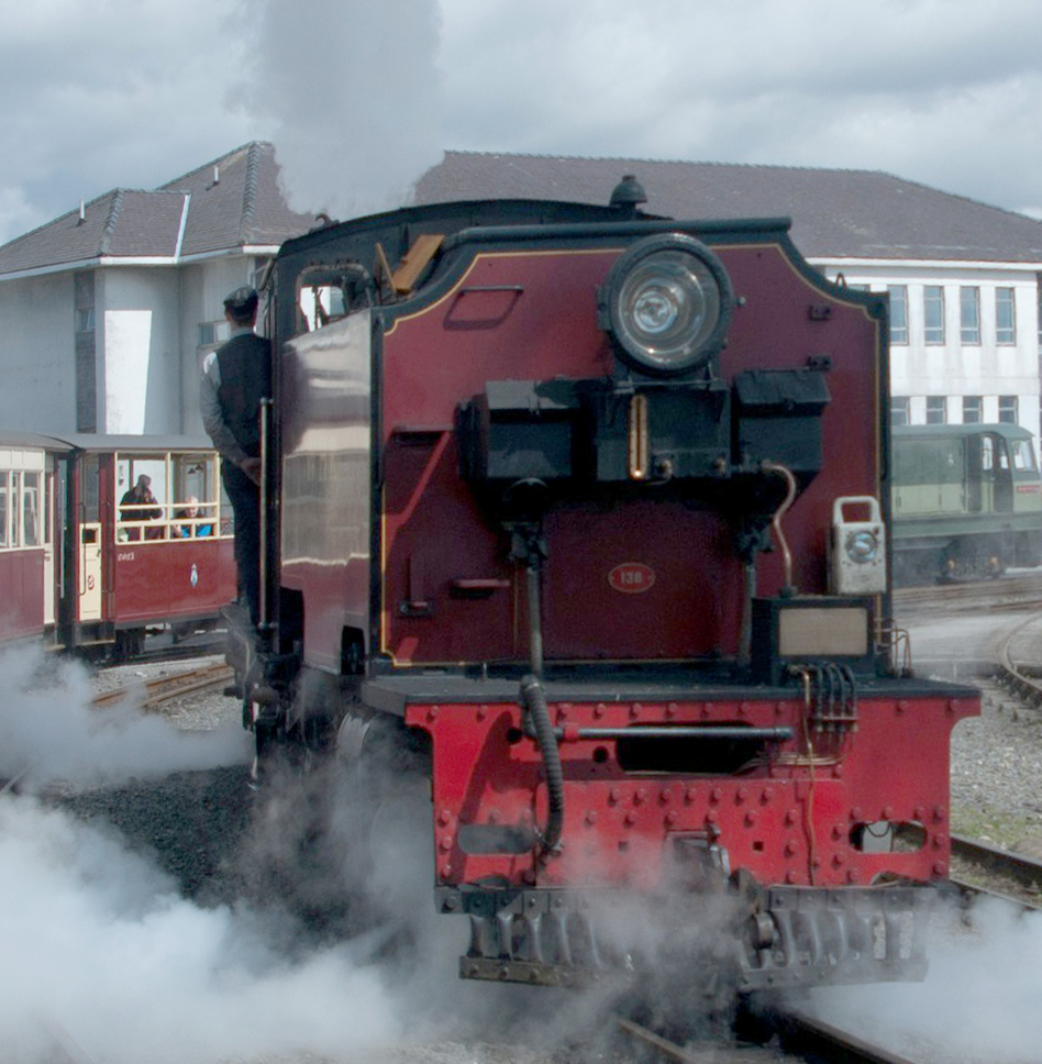

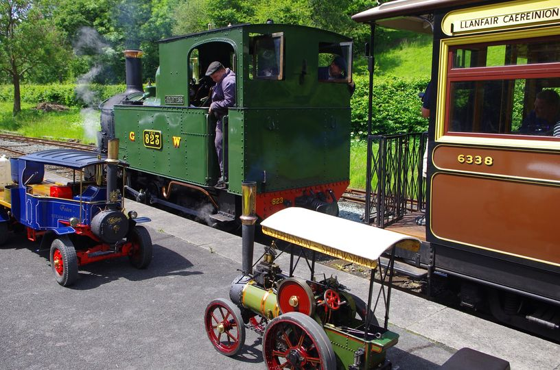

upload_2022-2-2_0-4-42.png Can you see being allowed to have no door or even chain to stop one falling out of a train today? Not only the railway I work at upload_2022-2-2_0-11-12.png doors were rare. But the argument is people know it is a Heritage railway and should behave accordingly.
