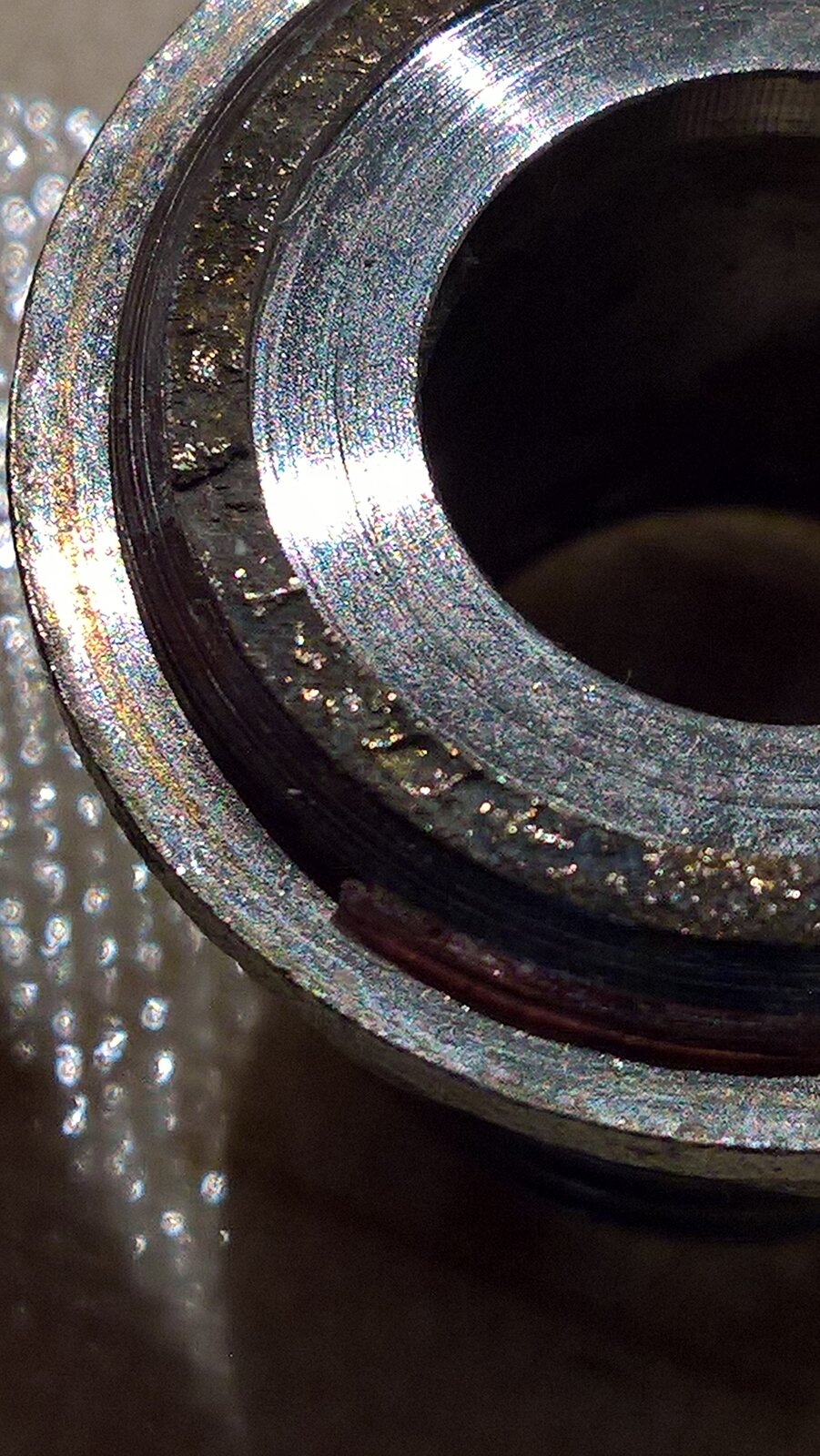

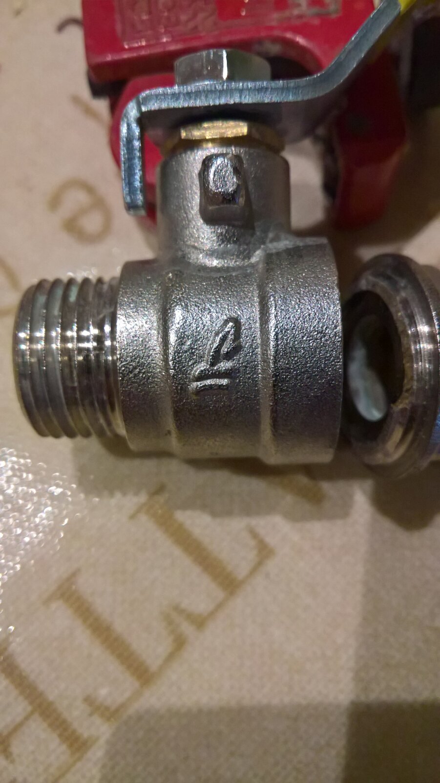

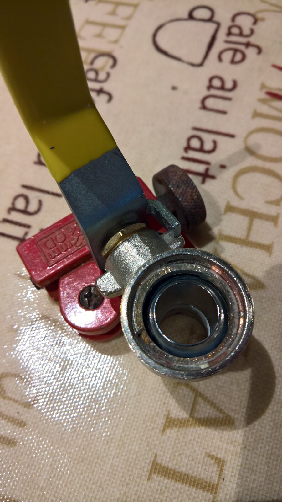

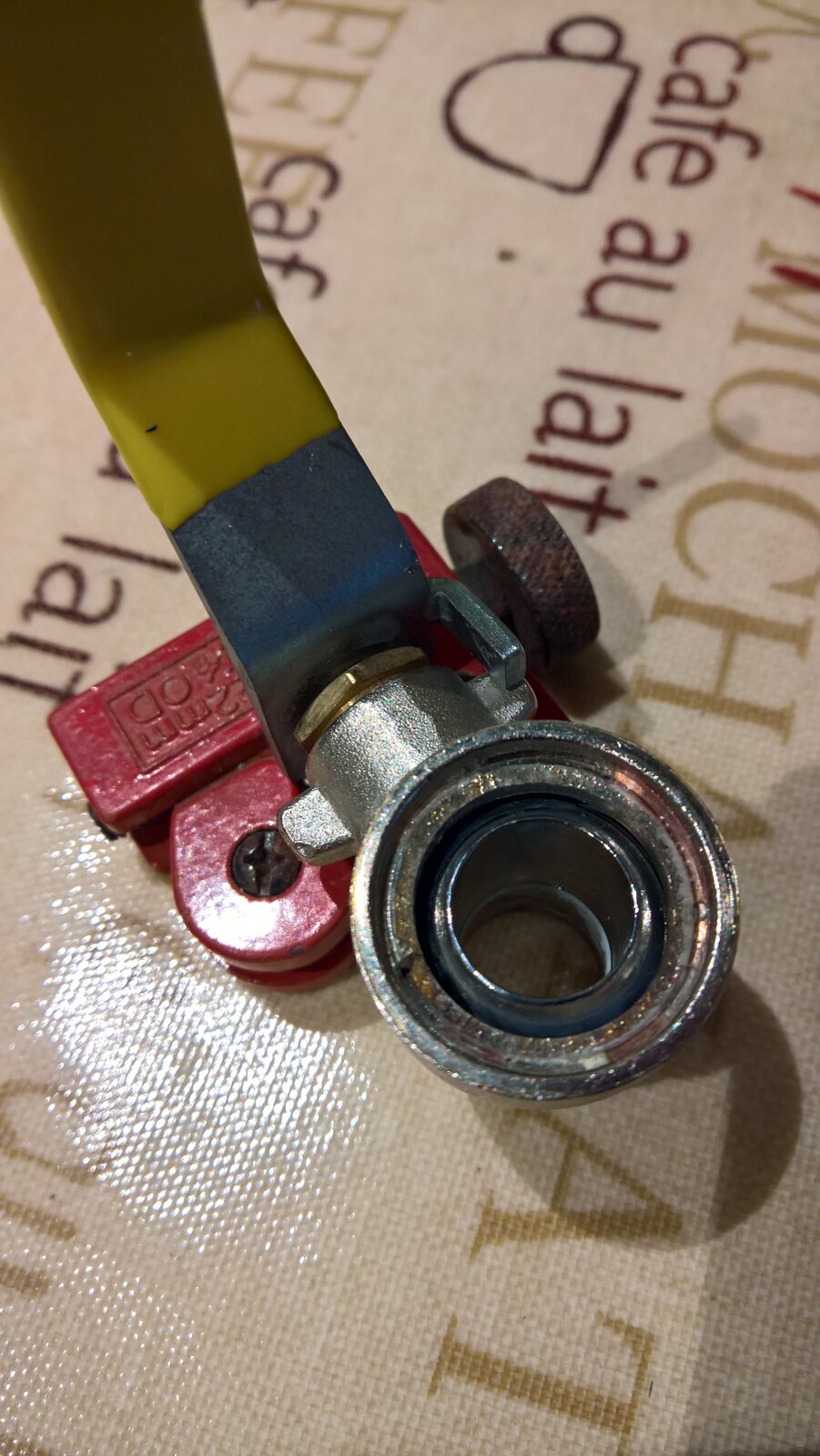

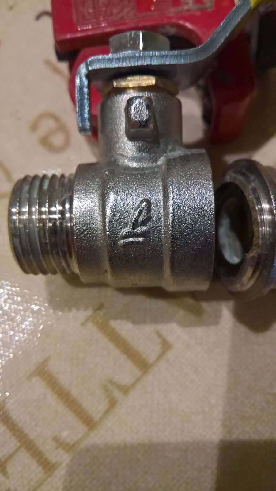

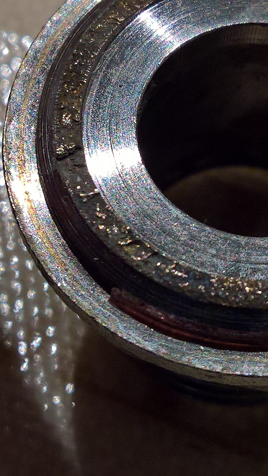

Not Screwfix, but I did once have a Toolstation no name lever valve that snapped after a year and caused £6000 of damage. I now only buy Pegler. I may try Connex as well based on the recommendations.
When I showed the pictures to people that know more about metals than me, they suggested that the crystal-like nature of the metal was evidence of it being poorly cast.
The only saving grace was that it snapped at the "demand" side rather than the supply side which means that the customer's mother was able to stop the flow of mains pressure water.
