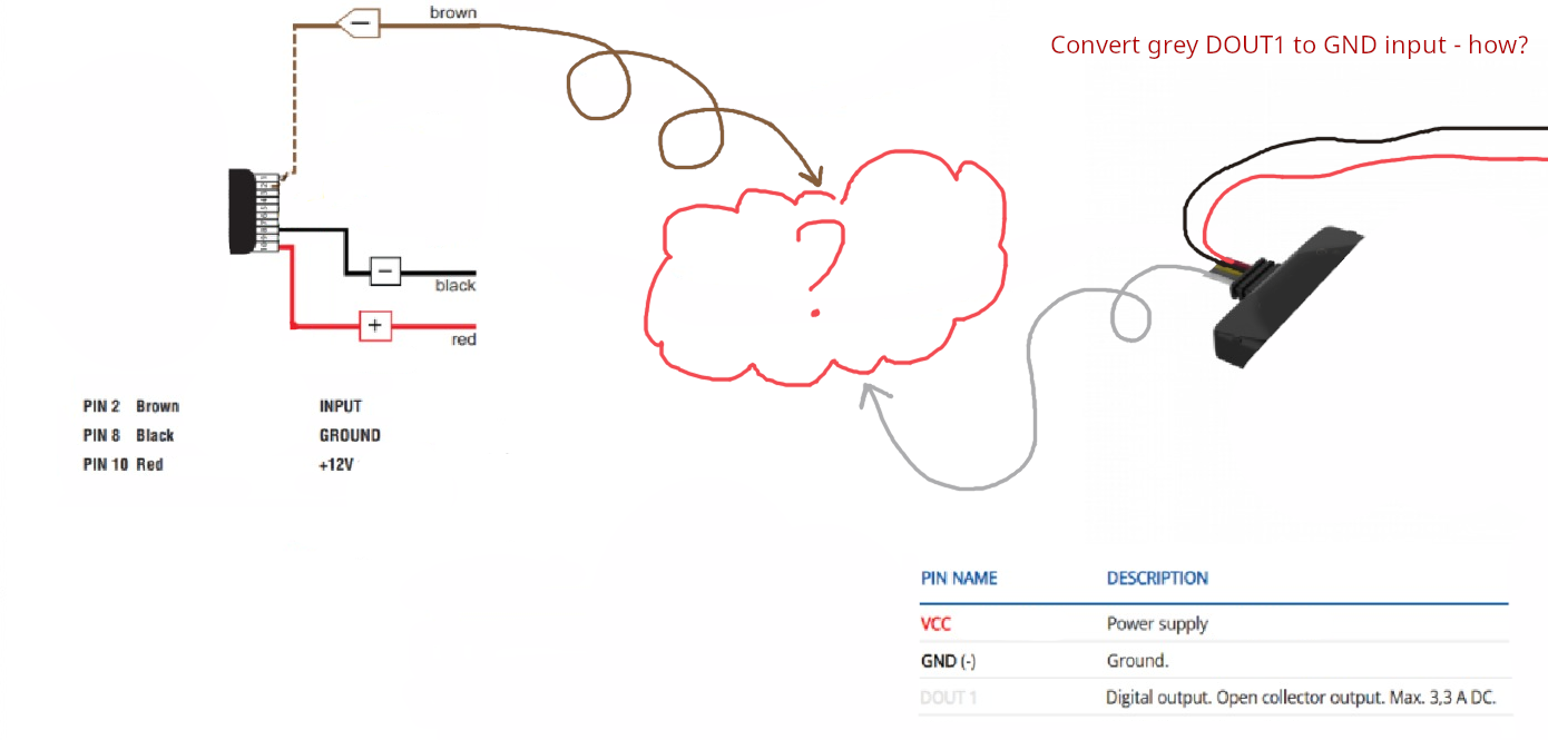

Hi,
I have a home automation peripheral that has a digital output (Digital output - Open collector. Maximum 3.3A DC.), that I am trying to connect to another peripheral which is listening for a Ground Connection.
The digital output, I assume is High/Low, whereby "logically" Low would be ground, but it's not seemingly as simple as that.
How and what can I use to read the High/Low (1/0) signal from the digital out, and convert this into a traditional ground??
Kind regards and Thanks in advance!

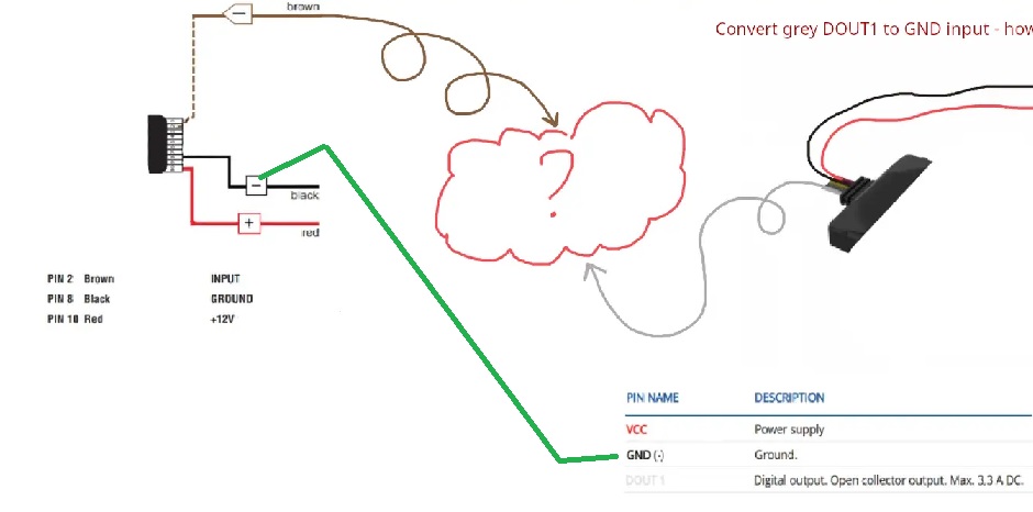

Have you connected the ground of the peripheral to the ground of the peripheral which is listening for a Ground Connection ?

How would this/that look here??
I've tried that, sadly it doesn't :(

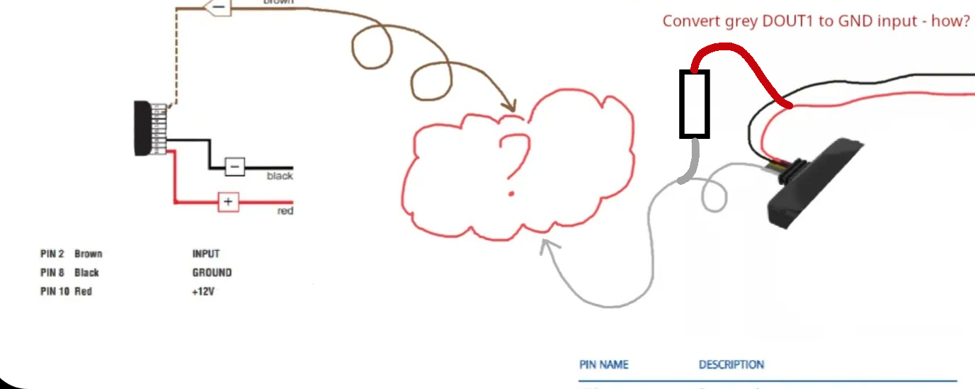

So that would just be a case of wiring one leg to the + on the left device (Pin 10) and one leg to the Brown (Pin 2), and then connecting the Brown + Grey?
It's not clear to me in your diagram, which side is sending the instructions, and which is receiving them, but...
The resistors needs to be on the receiving device, connected between the receiving devices input pin and it's positive supply.
The idea is - the output is allowed to float, unless pulled to ground. There is nothing to pull the output up, which is where the need for the resistor comes in, to pull the output up. Depending on the receiving device type, anything above 1.7 is seen as a 1, anything below that is seen as a 0.

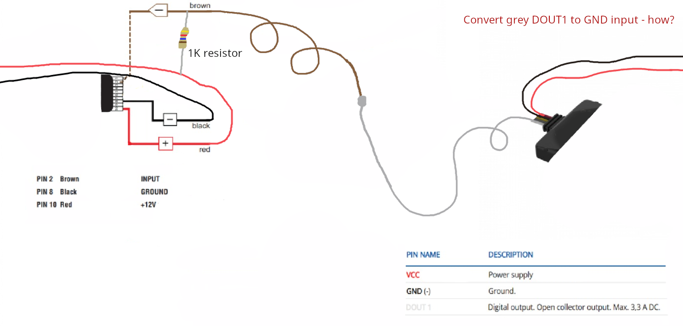

I've even managed to dig out some resistors from the bottom of a cupboard (10R, 100R, 1K, 10K, 1M and 10M)... based on your reply above, do I need something between 1k and 10k, or would/could a 1/10k work? That said, I assume a few 1K in series would theoretically allow me to land between 1 and 10...
For what its worth, the sender is on the right in this image example. Grey (DOUT) going in to Brown (GND).
So I guess we get this...
I'm assuming this will mean there's /some/ voltage going IN to the line... are any of my devices at risk here, potentially?
Sorry, I don't understand any of that, but do not put any resistors in series - just the one resistor in your final diagram, will work fine.
