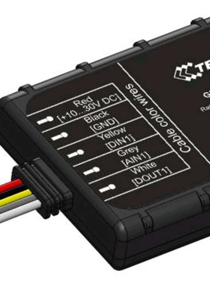

Yes. I think I've clocked it though. Check my post on the previous page. I think DOUT is white, not Grey...... "Doh-Out".
I've just noticed something..................................................................................................................
The colour scheme on the website, suggests DOUT as being "Grey", and I was also advised Grey by two separate sources....
But on the unit itself, it says DOUT is white... Might be a nice win in the morning...
I always always always get stung by the obvious/taking things as gospel.
Hiding in plain sight! ;)

The point is, that the output should never float, as in floating about aimlessly - the output should only be high, or low, a definate 1 or a 0. The open collector transistor, switching on or off, works against the pull up resistor shorting the output to ground/zero, when turned on, or when not when turned off the resistor pulls the voltage up.
I have a slightly different revision, so it looks slightly different, but regardless. The information printed on mine is the same.
