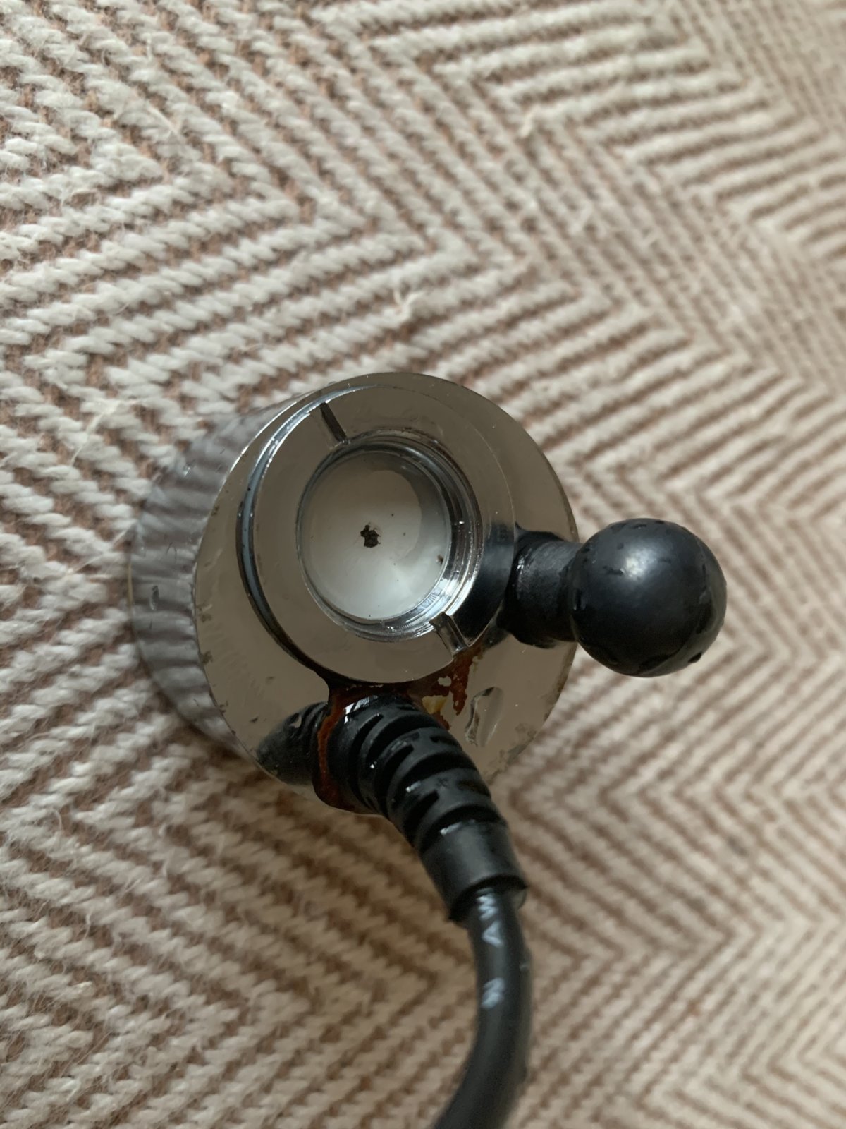

Dimplex fire not misting.
Maybe transducer problem. How much water should it spray. I videoed it but can’t upload that can I? Does this look right? Seems to have a scratch in the centre of the disc....
