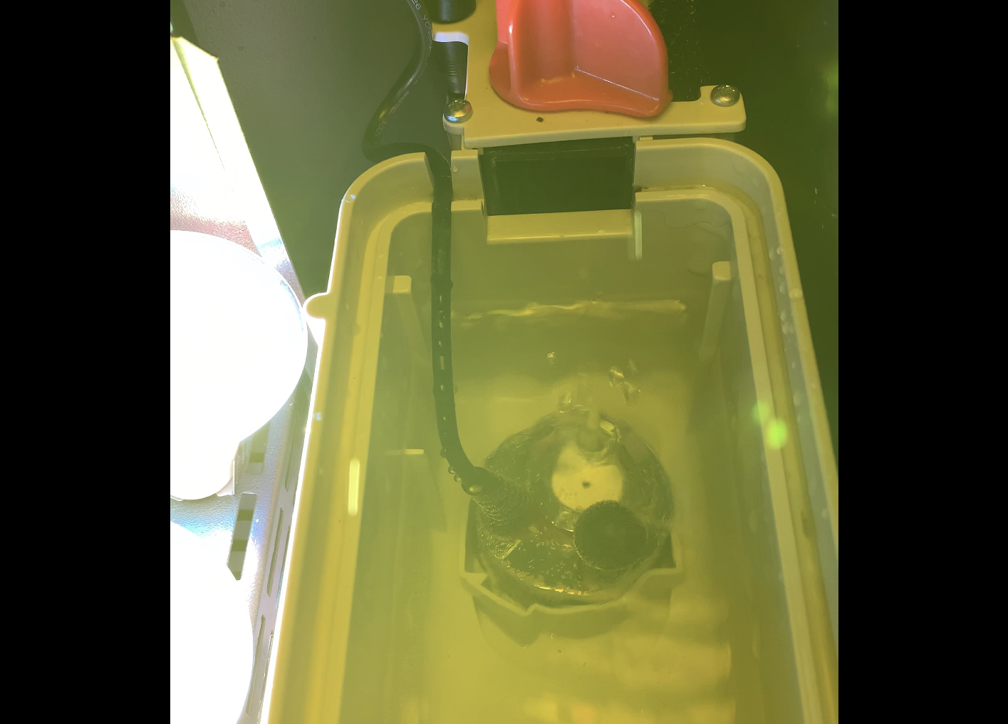

Maybe transducer problem. How much water should it spray. I videoed it but can’t upload that can I? Does this look right? Seems to have a scratch in the centre of the disc....
You should be able to see if the transducer is working by removing the false log cover, removing the reservoir water tank and turning the fire on. *Warning* Before turning fire on, make sure the sump is full of water *
After 30 seconds or so the transducer should kick in and the water can be seen to bubble in the sump where the transducer sits. If there is no bubbling the transducer isn't working. Check to make sure the connection to the transducer is good and secure.
If still no luck, you can replace the transducer disc, but personally I'd replace the entire transducer unit.
If the water is bubbling, check the fan by removing the front metal grill at the bottom front of the fire (4 screws), remove the filter and check to see if the fan is running free and easy.
Thanks Grenjs.
The fan is working, the transducer is working... but wasn't sure if it was working correctly. It's spitting water but i don't know if it should be making a finer mist.

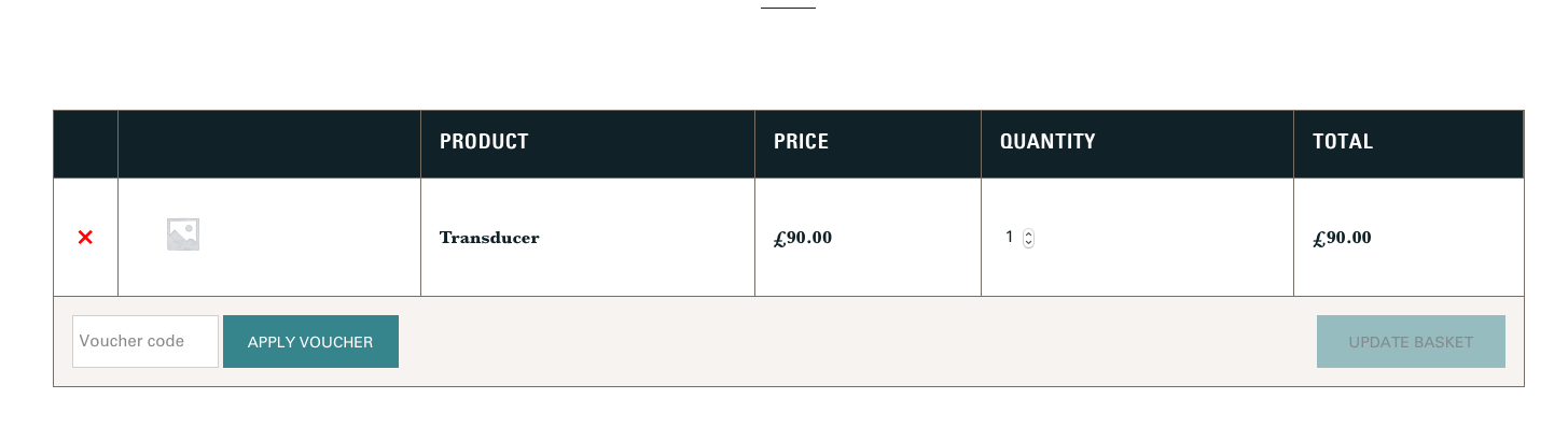

If you've really got money to burn, buy it from luxury fire maker Chesneys, who will sell you the same spare at a special price below. https://chesneys.co.uk/product/stove-spares/transducer
Now that's what I call a mark-up!

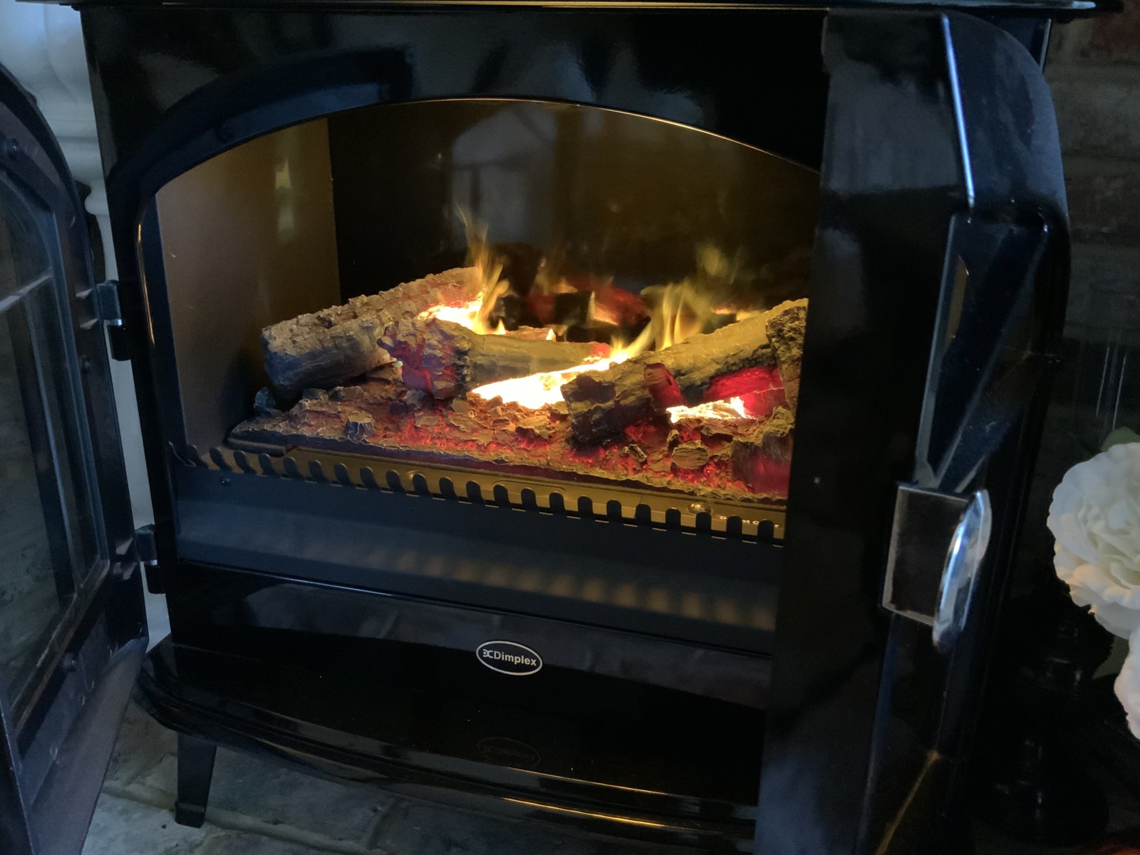

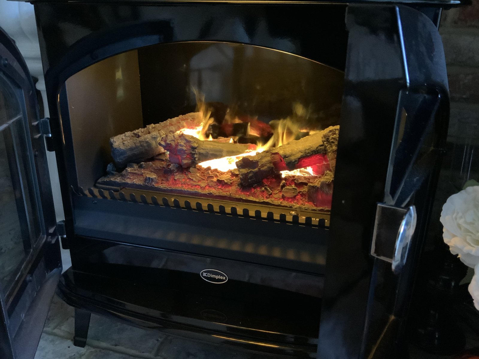

Dimplex Danville
Mist was being generated but no mist visible through logs
Fan was faultsy
New fan fitted
Easy to change remove log and other removable components
Disconnect transducer connector
Unscrew fan housing (RHS)
Lift fan from housing and disconnect 2way connector
Replace in reverse.

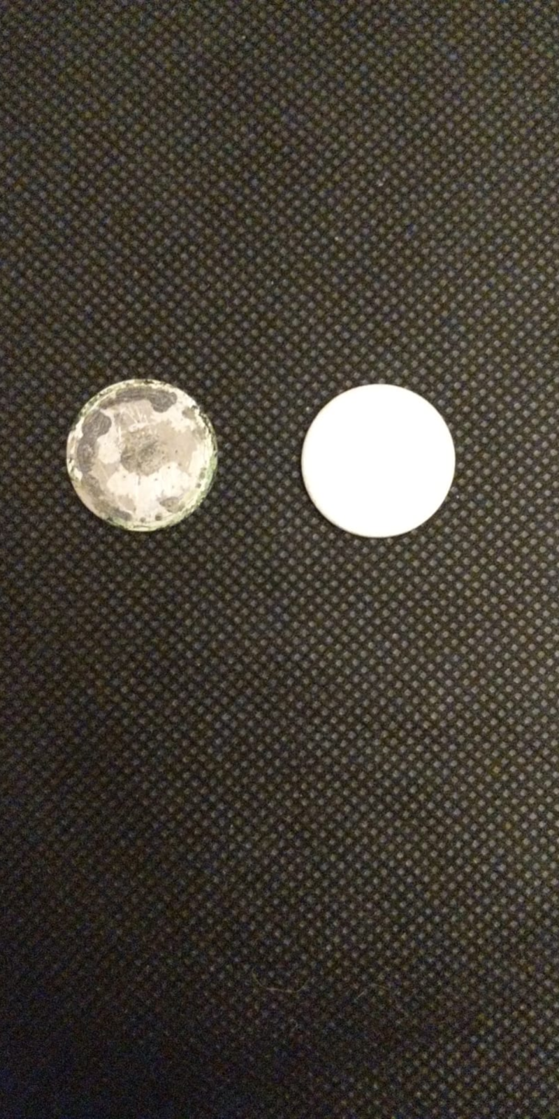

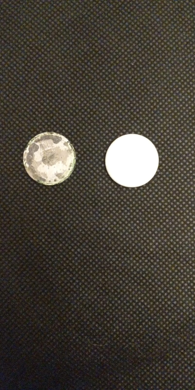

Did you get a new disc complete with it? Also what does the disc look like? Is it a white ceramic one like the ones you can purchase online, or is it a metallic one?
Here's the two side by side. My original one on the left (which I think has had it) and a newly purchased ceramic one on the right).

Hi it’s on line called electric spares.com. Phone number is 01823 412100 email: alan@electricspares.com. You get the whole unit including disc fitted. Just insert into fire and plug in. The item is number OM09030 small sump with transducer £147.25 plus £4.95 shipping arrived in a couple of days. The ceramic disc does not work in these units, I have tried it. The disc is all metal. Best regards John
