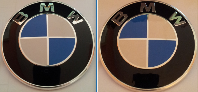

First panel done, and ready to deploy. Left: before painting. Right: hand brushed, and hand polished clear coat. Clear coating gave it greater reflection, and will last, hopefully, a very long time. Painting by hand means non-even paint thickness, brush marks, and very grapefruit peel-ly, but quite acceptable for my goal of longevity. The coating is tough and difficult to polish. Easiest to polish using 600 grit sand paper.

I was spraying some paving slabs earlier. The gun is way too much for what I need and designed for painting busses. It's going to take some effort to tune the gun down. The PSI needs to be way down from 25.

If you are practicing with dyed water it won’t help you set the gun up
The gun needs setting up with the viscosity of material you will be using.
The tricky bit is thinning paint to right amount and air pressure.
Not sure if you have on but you need a gauge at the gun
I know the base coat is watery. The dye hasn't arrived yet. For now, plain water is giving an impression of what is going on. The gun will be adjusted according to the material landed on the target and not on any magic psi number. I am looking for a fine soft mist, and not the rocket jet that I have.
What tip size do you have
How are you reducing pressure at gun
I am testing with 1.3. I don't think I need anything bigger, but I have1.5 and 2.0. I think 0.8 and 1.0 will work. For plain water, full material shut off and backing off 1 turn is OK. For thicker material, I can back off more. I think I can even do primer with 1.3 if properly strained.
Pressure is controlled at the compressor outlet. The gun is spec'ed to max at 100 PSI. There is no risk of over-pressure.
