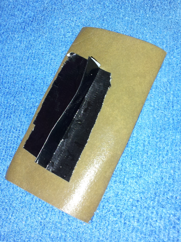

1500 grit was slow going (not like I was going out or anything), but the risk was low. Finished now. A small piece of sandpaper in exchange for a pro finish. It's wrong colour though, too light. May be a blindfolded blind man won't notice. The insurer could well invalidate me for doing custom painting.

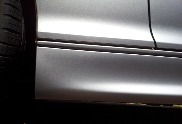

What a major bit of luck. While holding the panel against the car myself and looking, some parts of the panel didn't look like it was matching the car colour. When I got someone else to hold the panel and I stood back to look from multiple positions, it was a perfect match. I only needed one panel to work to recover my costs. I will be quids in if I do more than one.

The panel is back on the car. The colour match is pro rated without me trying to. But the image tells a lie. If I put one side of my face on the ground and look up, I could tell the panel is lighter. Also the car has a yellow tone to it because of aged clear coat. So, there is still room for me to play with the primer to reduced the lightness of the new paint. It isn't completely necessary, though, because it is passable as is. If I am going to do another panel, I might as well getting it right.

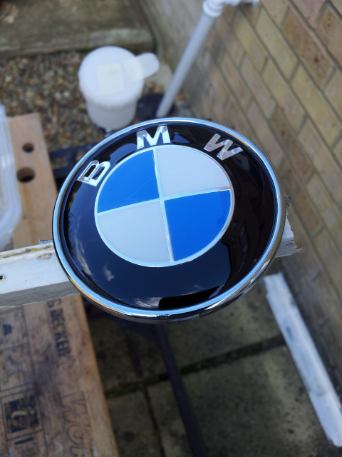

Here's before the 3rd and final clear coat. The finish is a wowzer.
I have mastered panels. There's nothing wrong with my handles. The factory mirror covers are the wrong colour, though. They match the skirt I painted. It's ridiculous.
