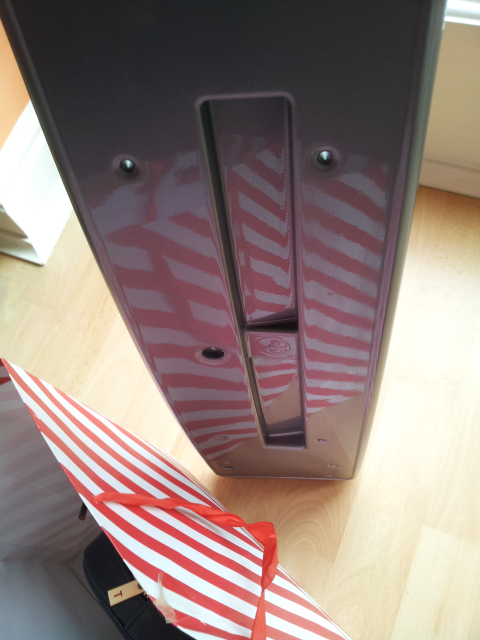

Training panel complete and going on the car. It's peely left and right (relative to the image), less peely middle and bottom. The debris on the final coat was sanded out and polished, leaving no marks. Wet sanding was possible for the whole panel and could produce significantly better result. I will leave that for the next panel if there is a need. This is the first time I looked into wet sanding and it is easier than I thought. With enough meat on the tough 2k clear coat, risk of doing damage from sanding is low. I am now biased towards higher paint flow when clear coating, with exception of the first coat. A thinner first coat reduces the difficult in dealing with debris that might be in contact with the base coat.

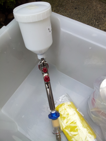

Priming for the 4th panel was completed using R500, 1.3tip, 1.5bar, 3flow, 150ml. The result was pro quality. I estimated the paint requirement at 90ml, but gave it 150ml to allow for transfer loss from containers, strainers, etc. In the end, 150 was a little more than the actual requirement, but not by too much. The same volume should be plenty for the base and clear coats.

The optimal gun setting for the base was: R500, 1.3tip, 1.5bar, 2flow.

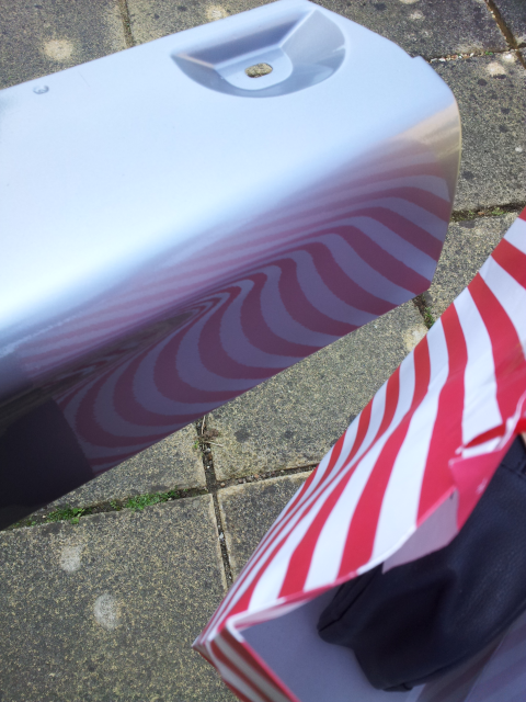

Used R500, 1.3tip, 1.5bar, 2flow on the smoother surface (the normally viewable face) of the panel, where the primer was sanded flat. The finish was less peely, but the mirror effect was worse. There was a minor run.
Used R500, 1.3tip, 1.5bar, 1.75flow on the rougher surface (the bit that normally faced the ground) of the panel, where the primer was not sanded, and small stone impact damages were left unrepaired. The finish was more peely, but the mirror effect was better. It was newly understood orange peel came partly from non-flat primer, or base coat.
The optimal gun setting for the clear coat is estimated at 1.5flow, and that's what I will use for the second coat.

To keep things simple and avoid flipping the panel about risking dropping it, I decided to paint the second coat on the side face of the panel only. The bottom face could wait. The knowledge for doing a mirror finish was gained over night from my experience of the first coat and re-watching painter videos to confirm my deductions. The secret recipe was found! For the outer coats of the clear, thin coats must be repeatedly laid to build a thicker coat. A thin coat can be achieved by higher pressure (what the pro's do), or lower material flow (what I do). Excessively low flow can result in a dry finish, so it has to be used with great care. High pressure results in material waste, misting the neighbourhood, and not my preference.
I used R500, 1.3tip, 1.5bar, 1.5flow, 45ml paint on the second coat. Painting the panel as a vertical surface did stop debris penetrating the wet clear to reach the base coat. This allowed me to sand out all of the pollen on the first coat without touching the base coat. Success in this inflated my ambition, which resulted in my finding more and more flaws to fix. Some of these flaws were on the base coat. Scuffing up the base coat ruined the final finish. So I have several small patches of light or dark depending on the viewing angle. I will leave these as reminders of what happens if you don't know when to stop. In conclusion, a tiny dot of dirt is preferable to a patch of scuffed up base coat.
After curing, I will have a flatter finish than what I have now. Wet sanding won't be necessary.
I have decided to not give the bottom face a second clear coat. Nobody looks at the panel there apart from the MOT guy. Also, it doesn't suffer from UV there, hence no risk of paint failing. For the side face, since I have to sand out debris anyway, I might as well wet sand the whole face. It's not going to be hard to do. 1500 grit will be used with washing up liquid water, followed by hand polish with cutting compound. The panel has too much shine at the moment, and I wouldn't mind dulling it a bit.
