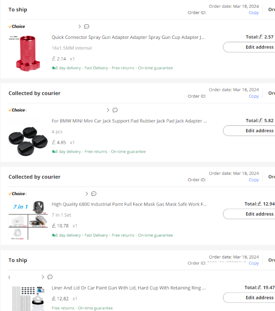

Everything ordered. Everything apart from the compressor and paint will be coming from china. They have a big sale there at the moment and doing an 8 day delivery. £200 spent on the project so far excluding paint. The paint will cost another £200, for sample and 2.5L on top. The total is not as expensive as initially thought but still expensive.

Nothing to show cos everything is still at shops or on way. Here's a quick sample. Even after getting the compressor tomorrow or the day after, I may not show it for privacy/lazy reasons. Trust me, bro. This is the best I can offer.
