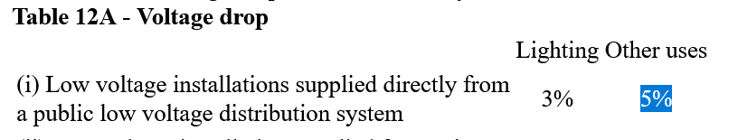

And I have already said how volt drop is often ignored, but appendix 12 says:-
It does not matter if I agree with the allowed volt drop, this is what the regulations state.
You can argue if the 20 amp at centre (ring final) or end (radial) and 12 amp even spread is the correct method to use, but not as to the 5%, we did I seem to remember have around the 80 meters as the max for a ring final before 2008, as the volt drop was 4% but in 2008 it changed, to as shown, and I tried to work out where the 106 meters came from, so at the IET lecture on the subject I asked the question. It was then I was told how calculated, and once I entered the correct figures I also got the 106 meters.

And I have already said how volt drop is often ignored, but appendix 12 says:- ..... It does not matter if I agree with the allowed volt drop, this is what the regulations state.
You don't seem to get the difference between regulations and guidance.

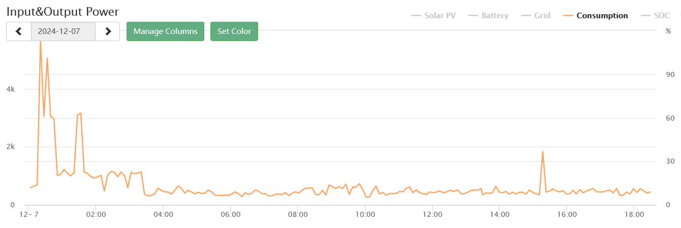

OK I will admit I can look at the solar panel software and see my consumption for the whole house 1733596211878.png and it is rare not only for the ring final to exceed 5.688 kW the first peak shown as the batteries started to recharge, but the whole house has not exceed that load, only when the shower is used (8.738 kW) do I see a load greater to what a ring final could supply.
However I can condone when we want to modify a circuit which already exists that the volt drop may be exceeded, but here we are starting from scratch, to suggest one designs an installation with excessive volt drop by using a radial, when it would be so easy to install a ring final which would be within the limits, is beyond believe.
OK I will admit I can look at the solar panel software and see my consumption for the whole house .... and it is rare not only for the ring final to exceed 5.688 kW the first peak shown as the batteries started to recharge, but the whole house has not exceed that load, only when the shower is used (8.738 kW) do I see a load greater to what a ring final could supply.

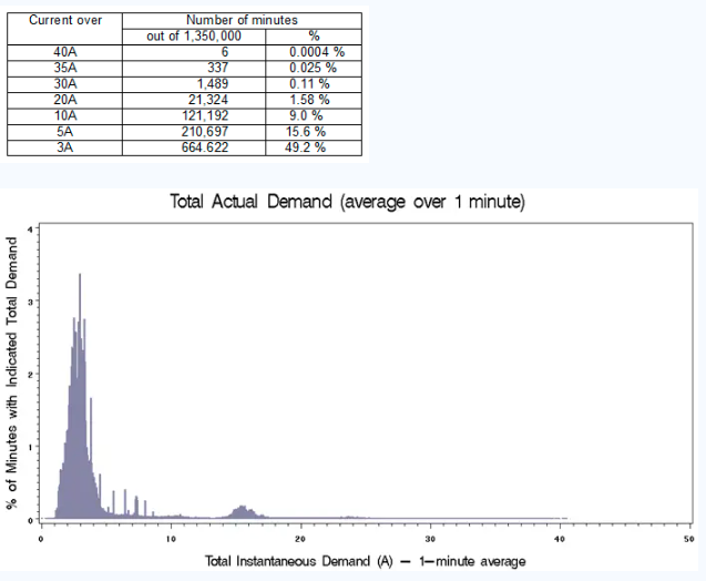

You may recall the below that I have posted a few times before. It relates to the entire demand of my (very large) house over a period of about 1.35 million minutes (about 2.5 years), and shows that the total demand of the whole house only exceeded 30A for 0.11% of those minutes, and exceeded 35A for only 0.025% of those minutes. On that basis I think one can very reasonably say that any one ring circuit in the house was "not likely" to be loaded to 32A (or anywhere near that) for appreciable periods of time.

I don't personally think that the fact that one is designing a circuit from scratch makes any difference to the concept that one should utilise 'intelligent judgment'and common sense in heeding and applying 'guidelines' (provided one remains compliant with actual regulations).
