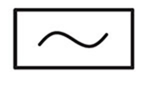

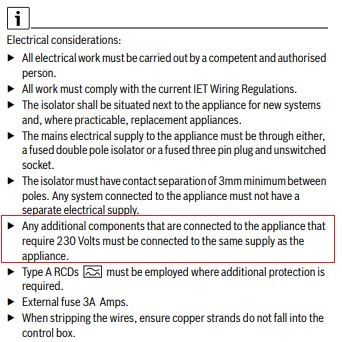

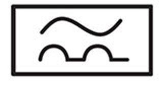

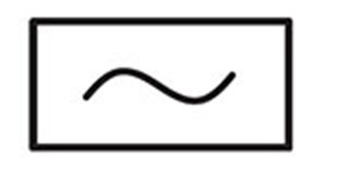

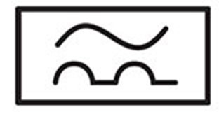

In a word yes, clearly the electrical regulations mean you must have a tool or key to remove panel, and clearly one does get to know which panels are for decoration and which are connected with the balanced flue sealing, and if you can access the installation instructions then clearly one would look, this
is clearly some thing we need to know. It the boiler requires at type A Type A.jpg then we need to ensure type A Type A.jpg is fitted not type AC Type AC.jpg so if available we would glance at the installation manual, however that is only possible if the installation manual has been left with the boiler, here in Wales hard enough to get mobile coverage never mind internet, and clearly there should be a Corgi only or Gas Safe only sticker on the boiler, and if there is it can be given a code FI and the customer told you need the boiler checking by a gas safe guy or a Code LIM and put on report all items marked Gas Safe only are outside of this inspection.
