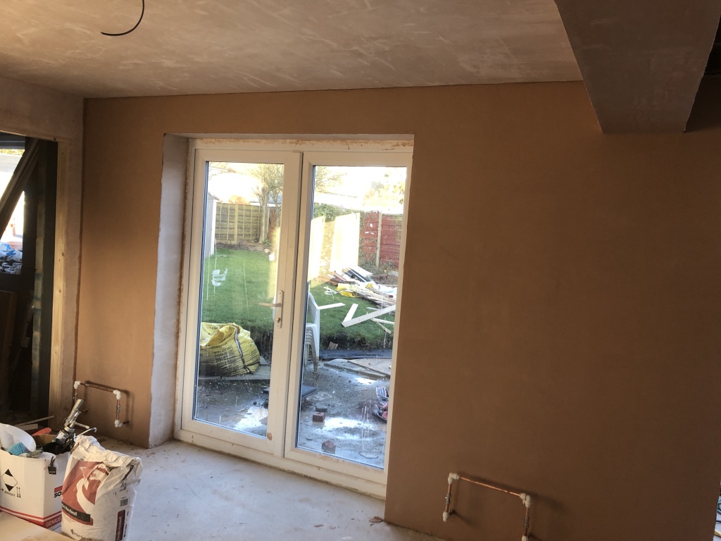

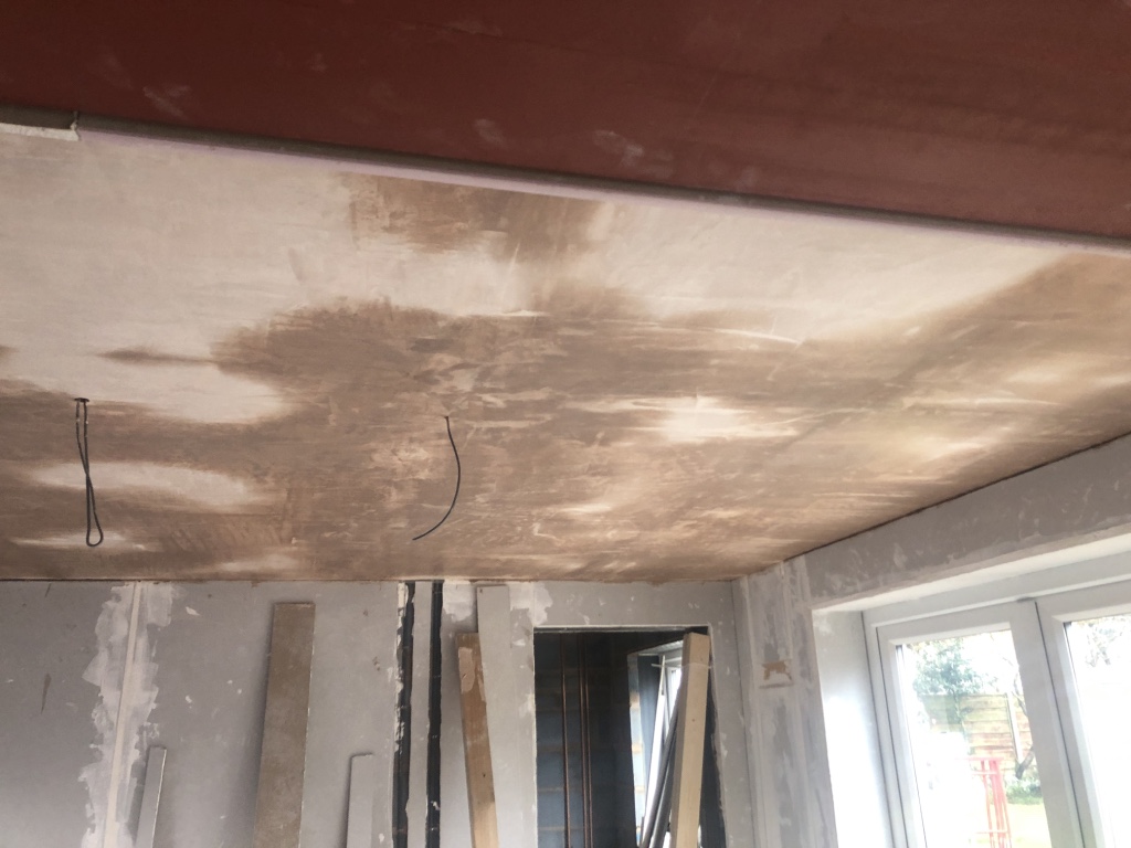

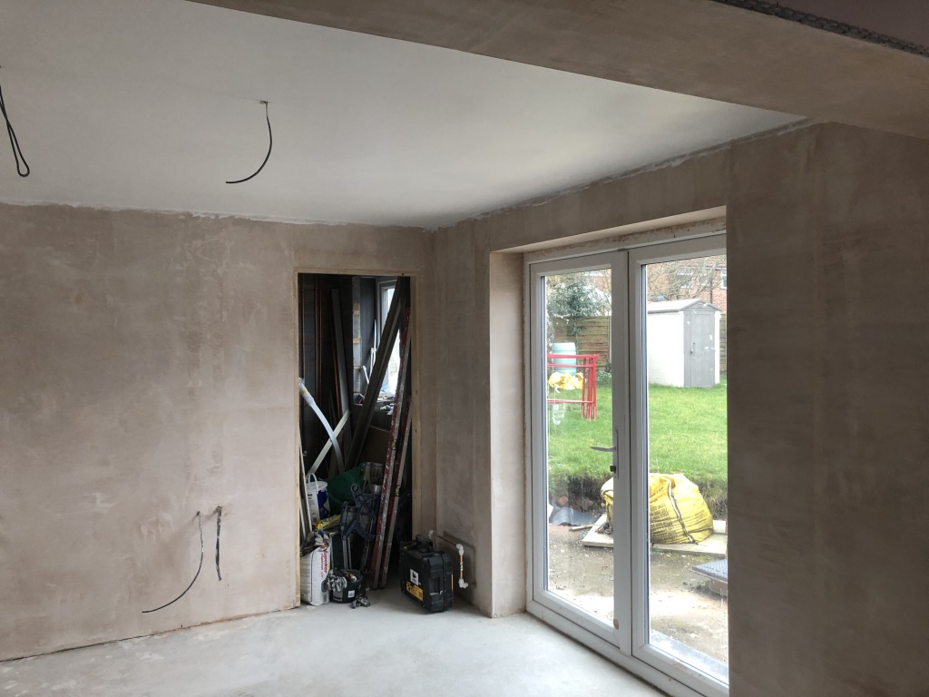

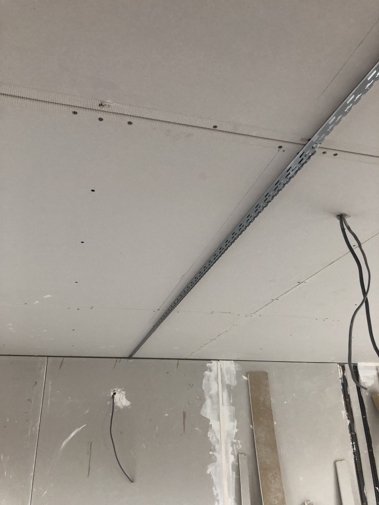

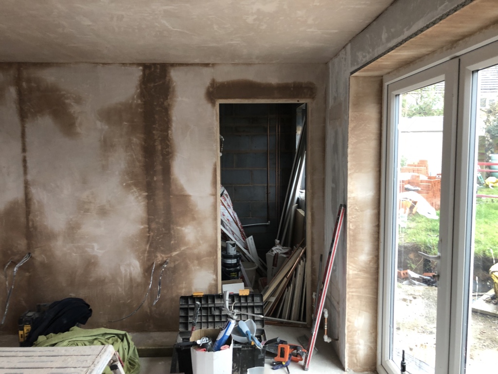

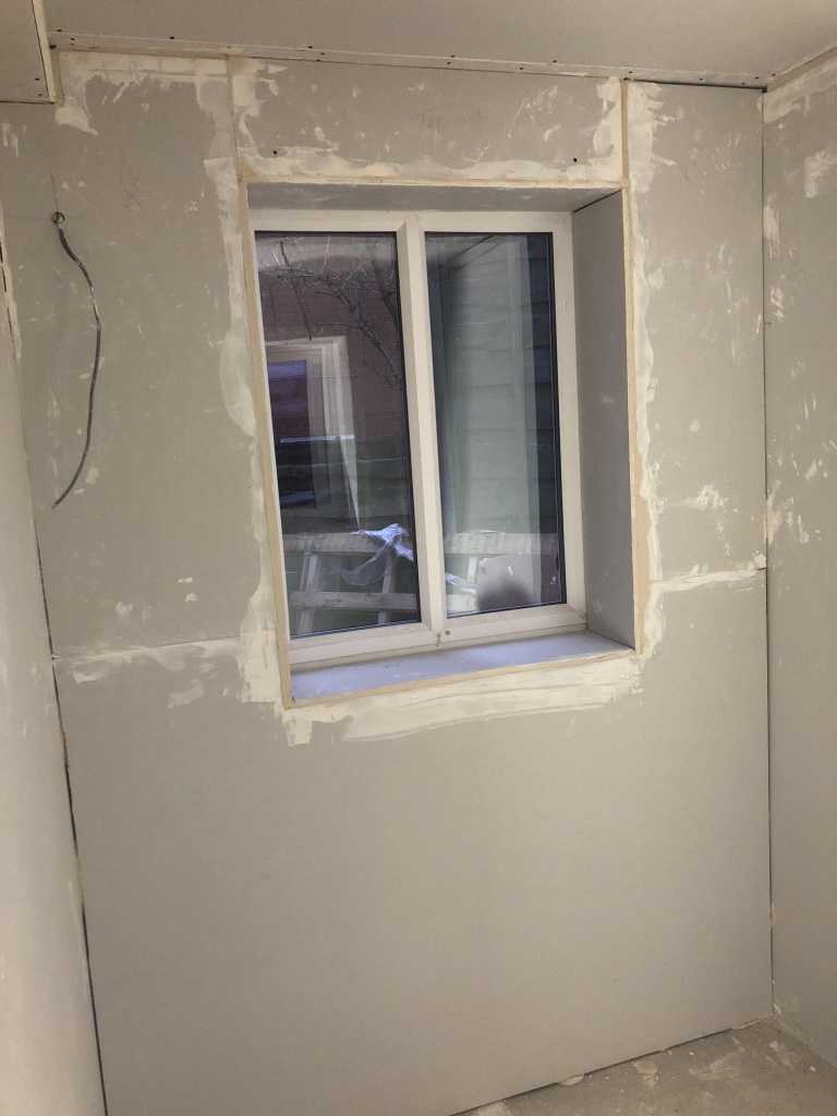

Kitchen Plastering
When it came to plastering the kitchen ceiling I did things a little different. I split the ceiling into three sections using some angle beads and just plastered the first section.
This allowed me enough time to get the first section smooth before moving onto the next section. Then I removed the bead to join the next section.
Then I plastered the walls... Like a plastering Jedi at this point :LOL:(y).

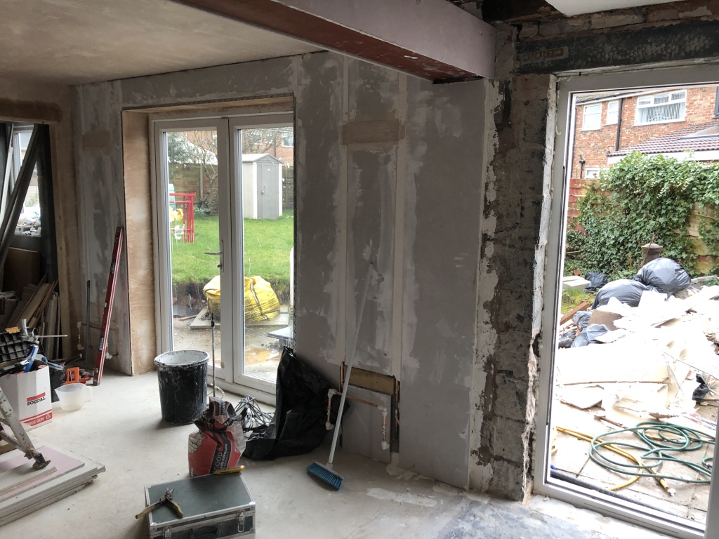

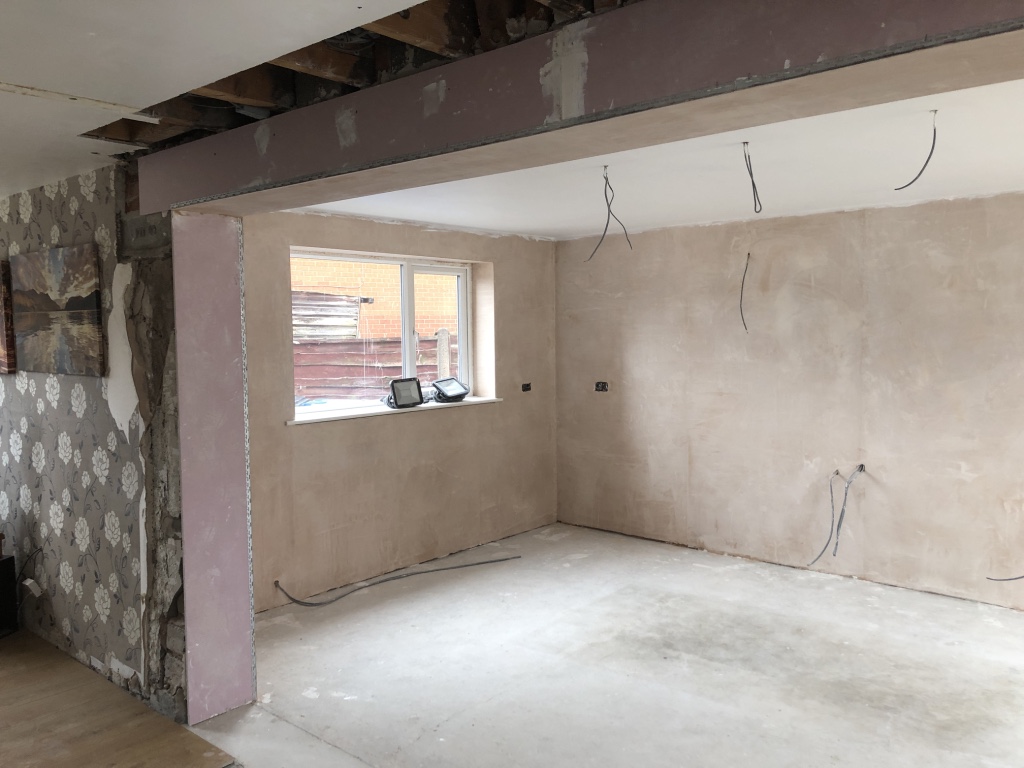

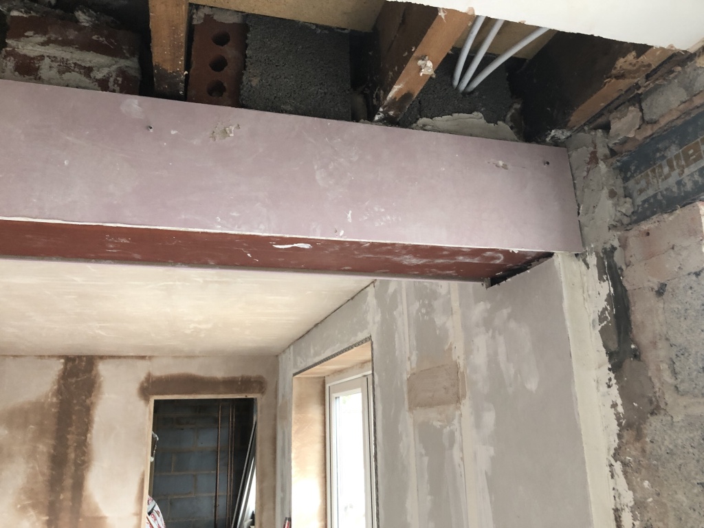

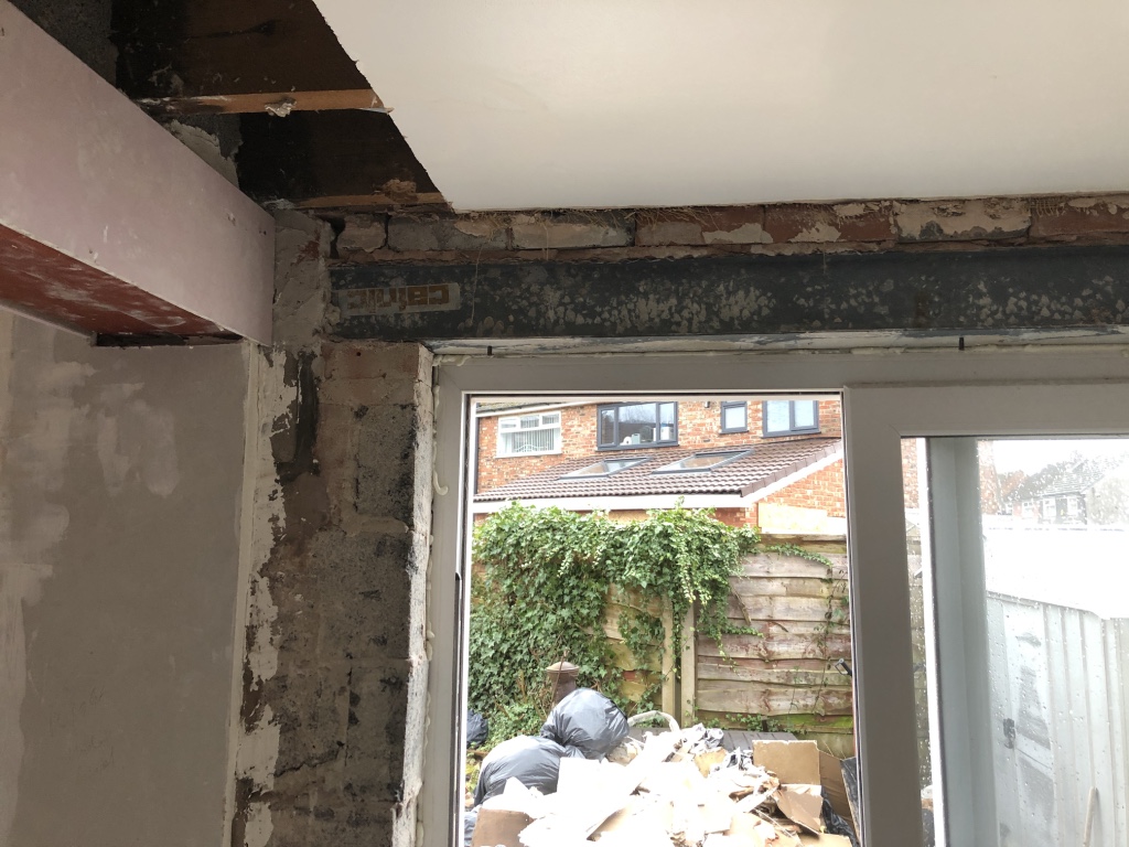

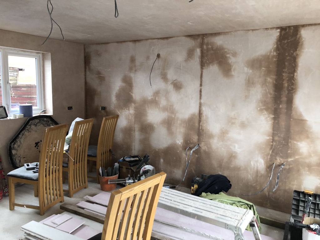

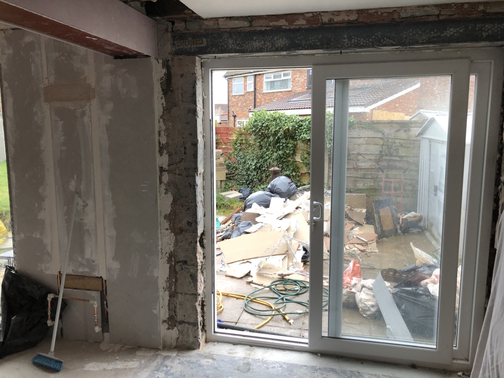

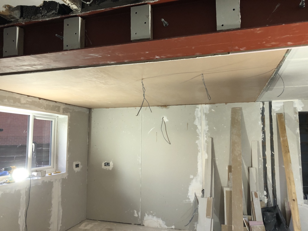

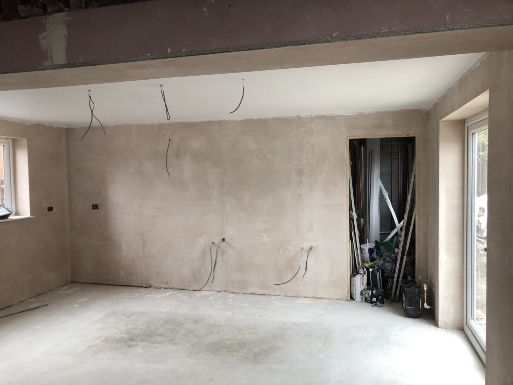

Kitchen Plastering 2
The extension wall and existing wall were different thicknesses and would've meant a step out to the new extension wall so I decided to make the back wall as smooth as possible by building out the existing wall. It did mean stripping the old plaster off..

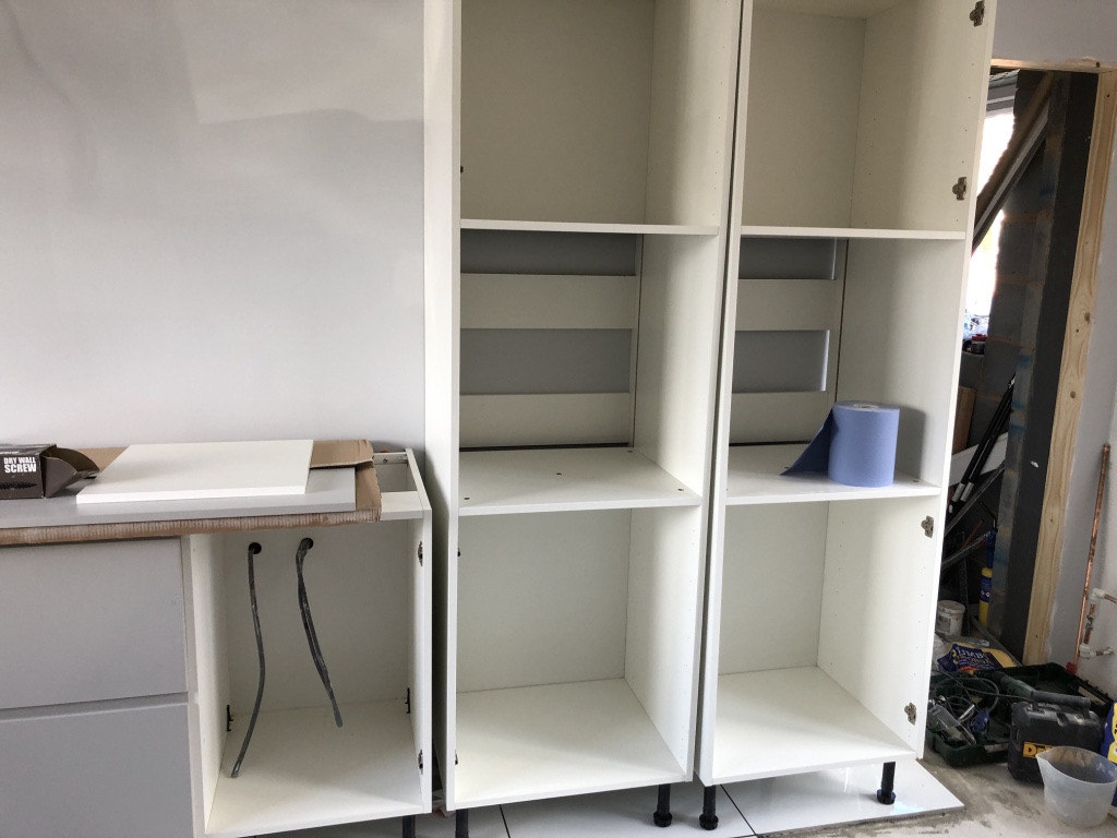

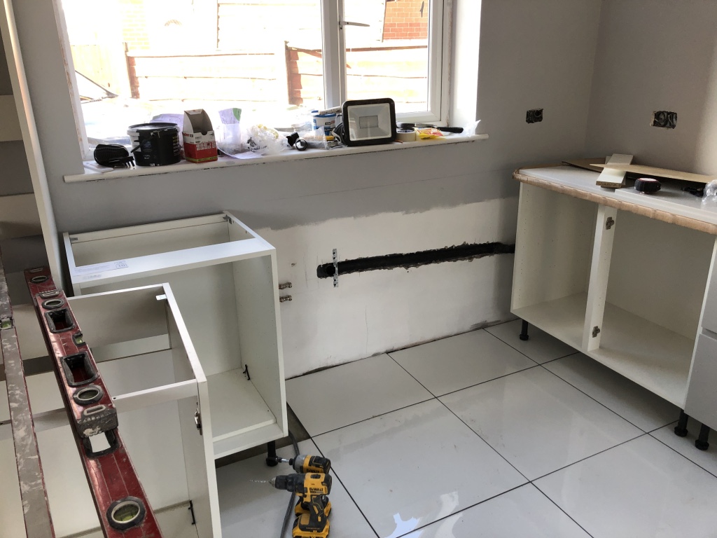

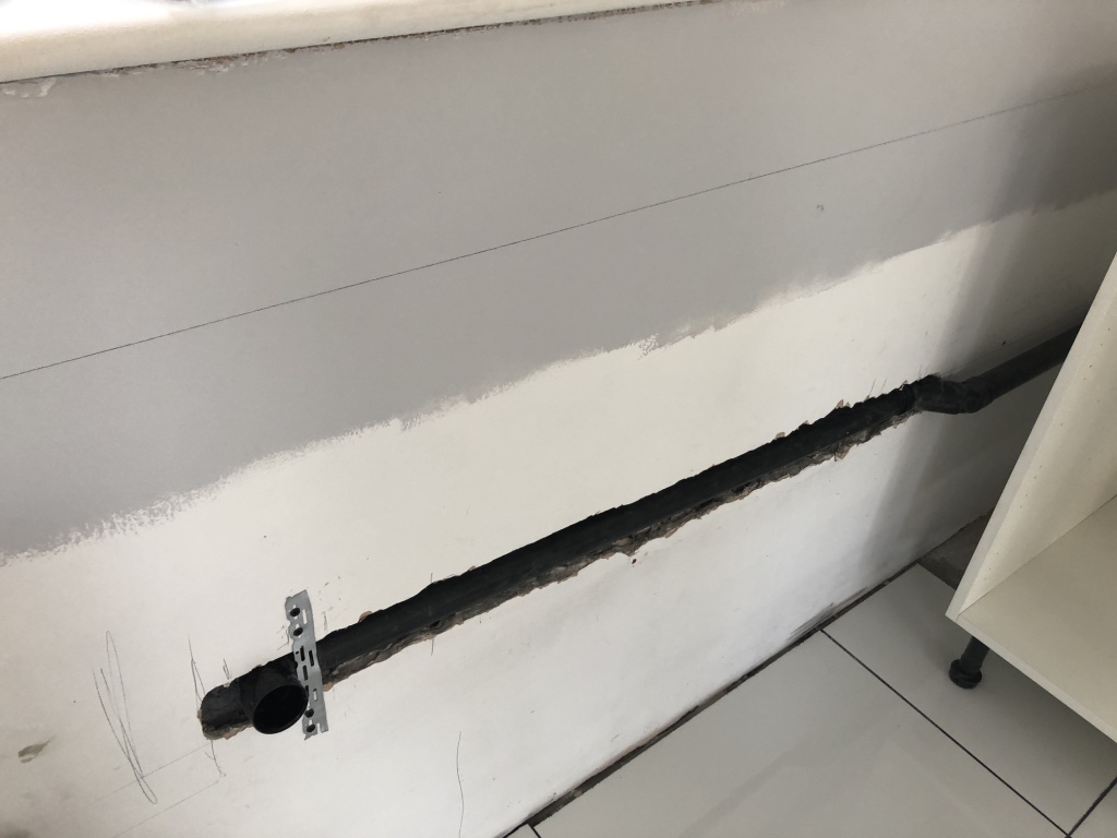

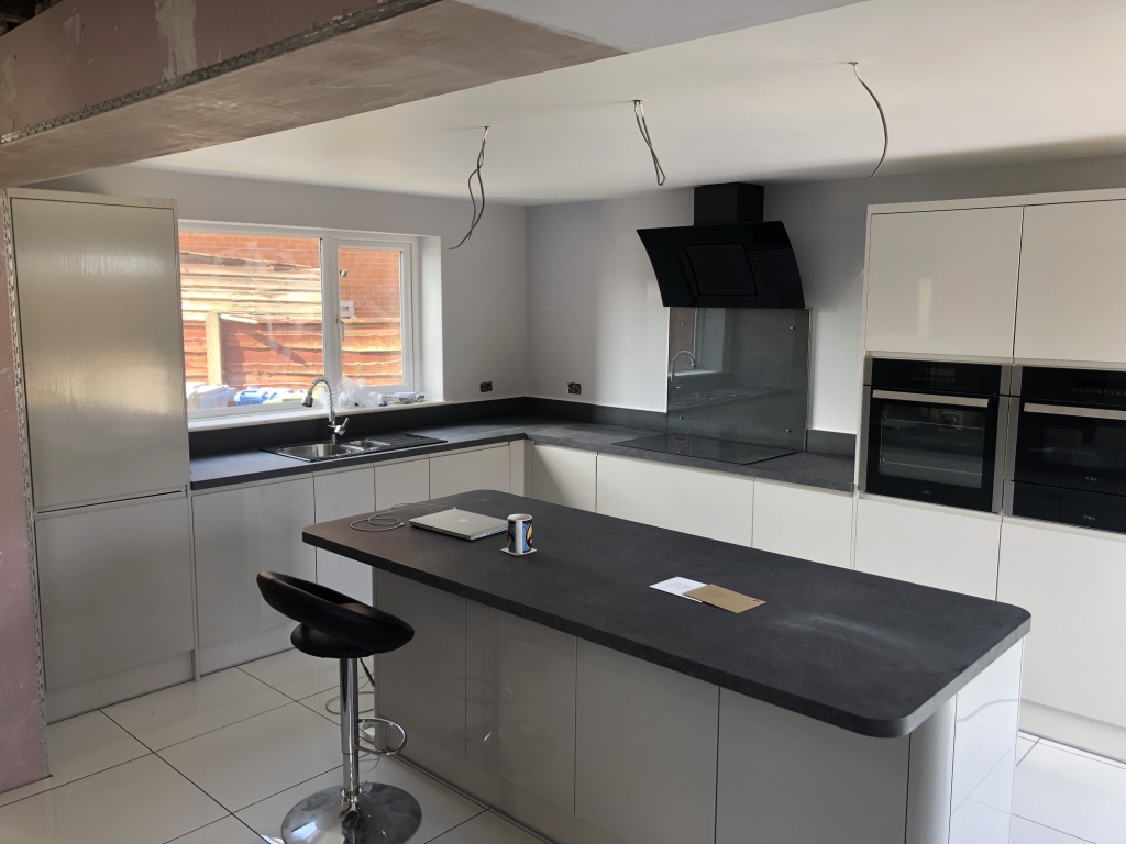

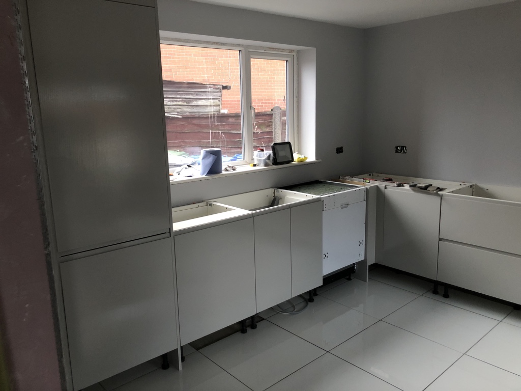

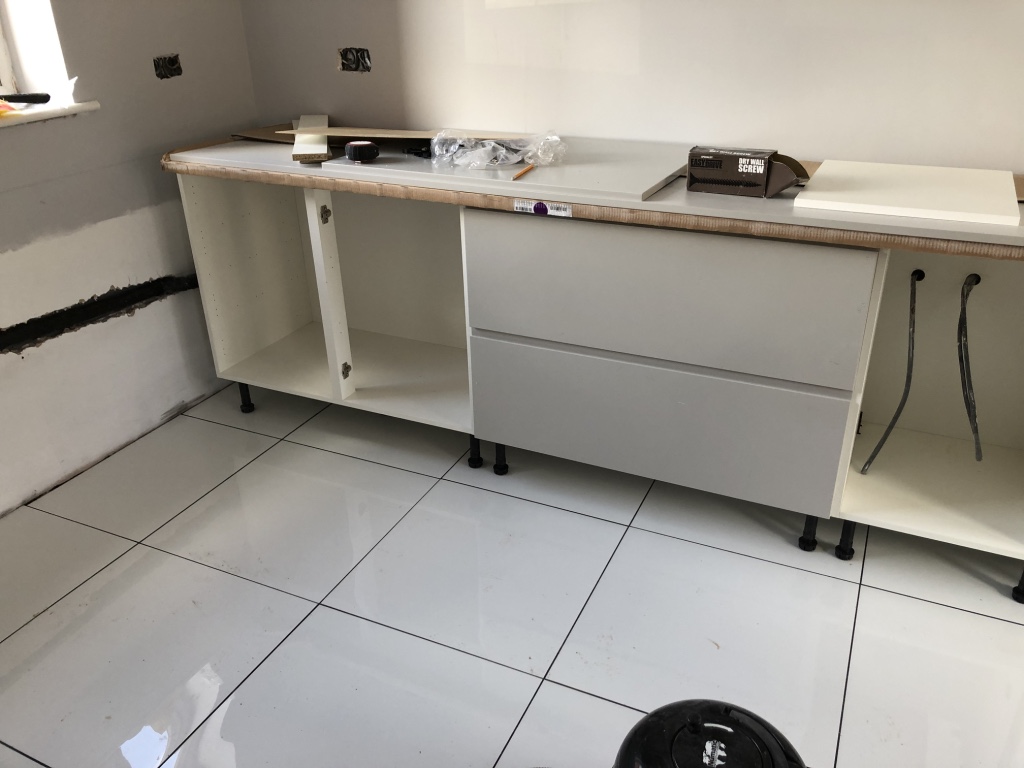

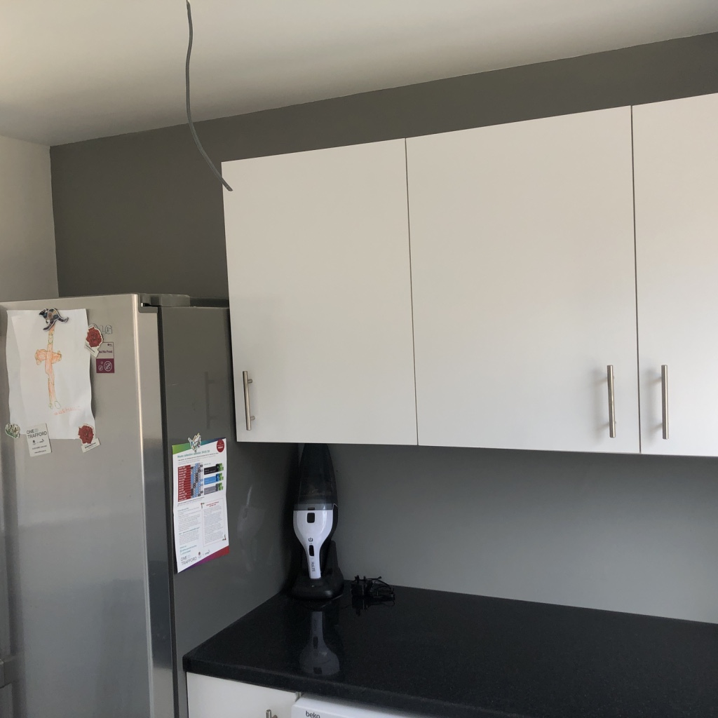

Kitchen Installation Part 1
White 600x600 porcelain tiles in white. Started to put the kitchen units in place (I laid the tiles and fitted the kitchen too. I could hardly build the extension and then get someone to do these things!)
I had to break into the plaster and a bit of the wall to get the sink waste behind the dishwasher.

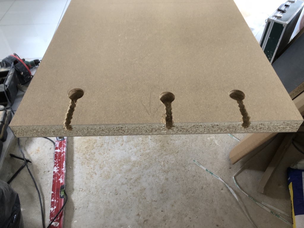

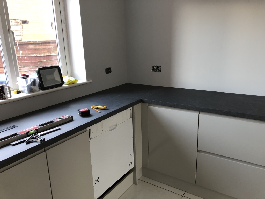

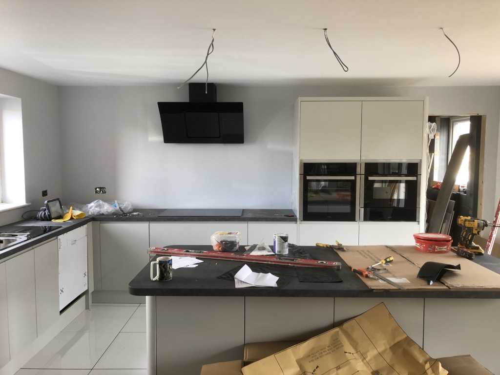

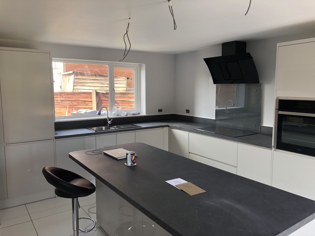

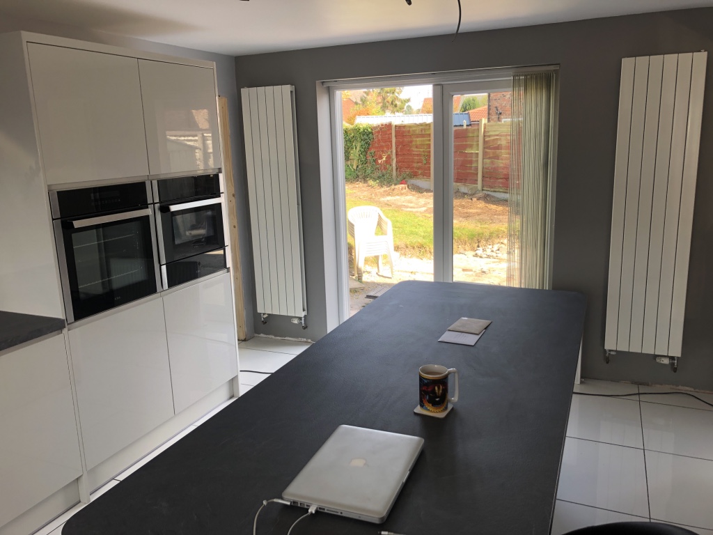

Kitchen Installation Part 2
When I did the worktops, I was lucky to have gone for square edge worktops which meant the join would be simpler.
I basically removed the laminate from the joining edge of the worktop and used a hinge cutter to make the bolt holes.
Radiators and blinds for the back wall go up.
Waiting for the front blind and the electrician was supposed to come back and do the 2nd fix although with the lockdown he hasn't been able to, so our kitchen is not wired up yet. Spotlights will be going in too. It's getting there but not finished.

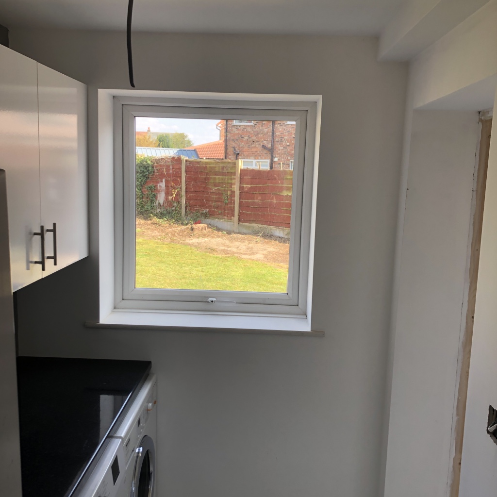

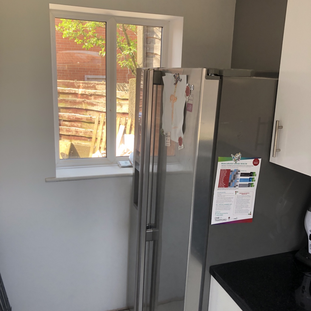

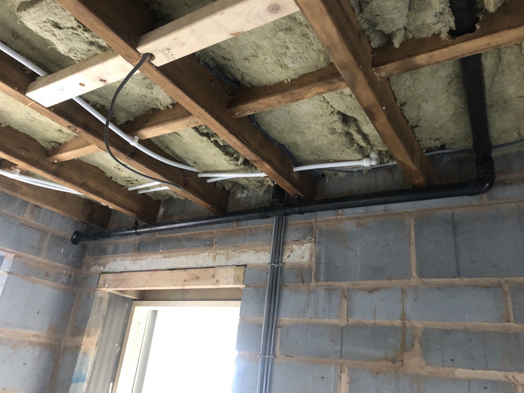

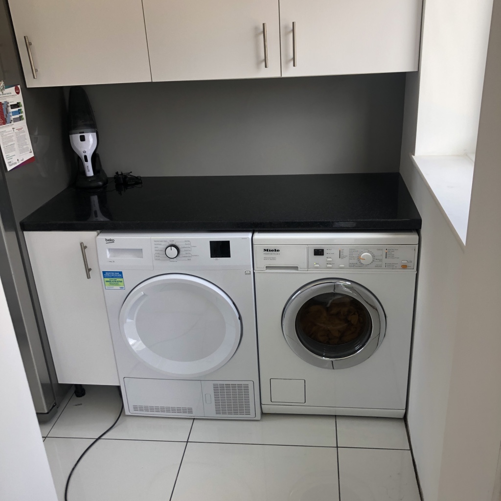

Utility Room

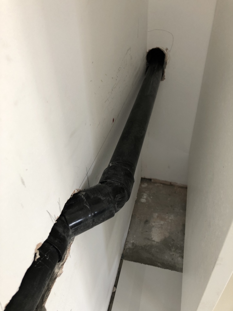

I brought the waste pipes under the ensuite floor and under the floor joists in the utility.
I plastered and decorated the utility room, including boxing in the waste pipes.
Plaster and paint.
Installed some cupboards from the old kitchen and a piece of old worktop from the shed. The room still needs some finishing touches and the electrics are not done yet so i'm running an extension lead to power the washer, dryer and fridge.
